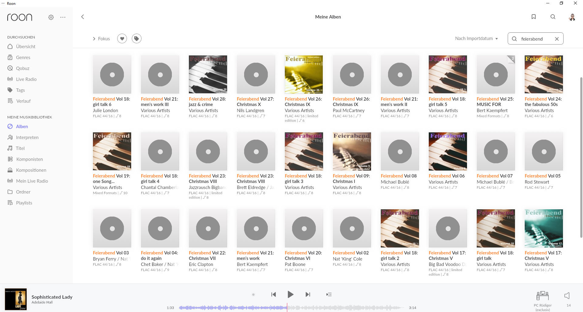

An update would be welcome. I have been away for a couple of weeks, I have come home to find that nothing has been fixed, I have multiple versions of the same “albums”, it looks a mess. To re-iterate, I have a script that puts recordings of radio streams into folders on my NAS so that I can time-shift them and listen back later. Since some time in May Roon has seen fit to split these into separate “albums”, even though nothing (nothing) has changed at my end. Can Roon please investigate and fix?

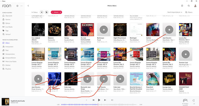

I'm having multiple entries appear in the album view despite only one set of files on my NAS. My home screen currently reports showing "4016 of 2152" albums. If I right click on an example of this, both entries are highlighted at once. I've observed this with both local files and Qobuz favourites. Rebooting the core will temporarily fix issue but it gradually returns. The erroneous display is consistent across remotes (ipad or pc)

This is getting worse rather than better, an album that I added two days ago a compilation of course was added perfectly and now it’s splitting into two different albums – some feedback about this would be useful. Even more useful would be if it was actually sorted.

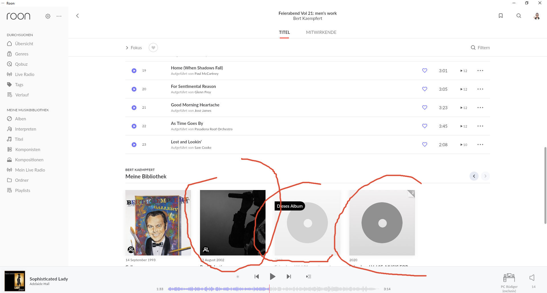

I’ve been using roon since 2018, but the software has never been this bad.

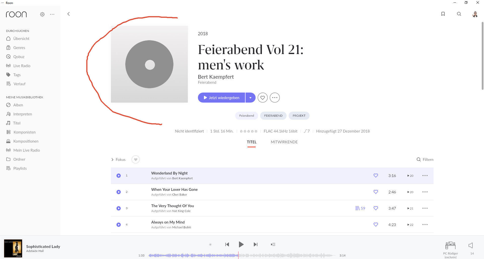

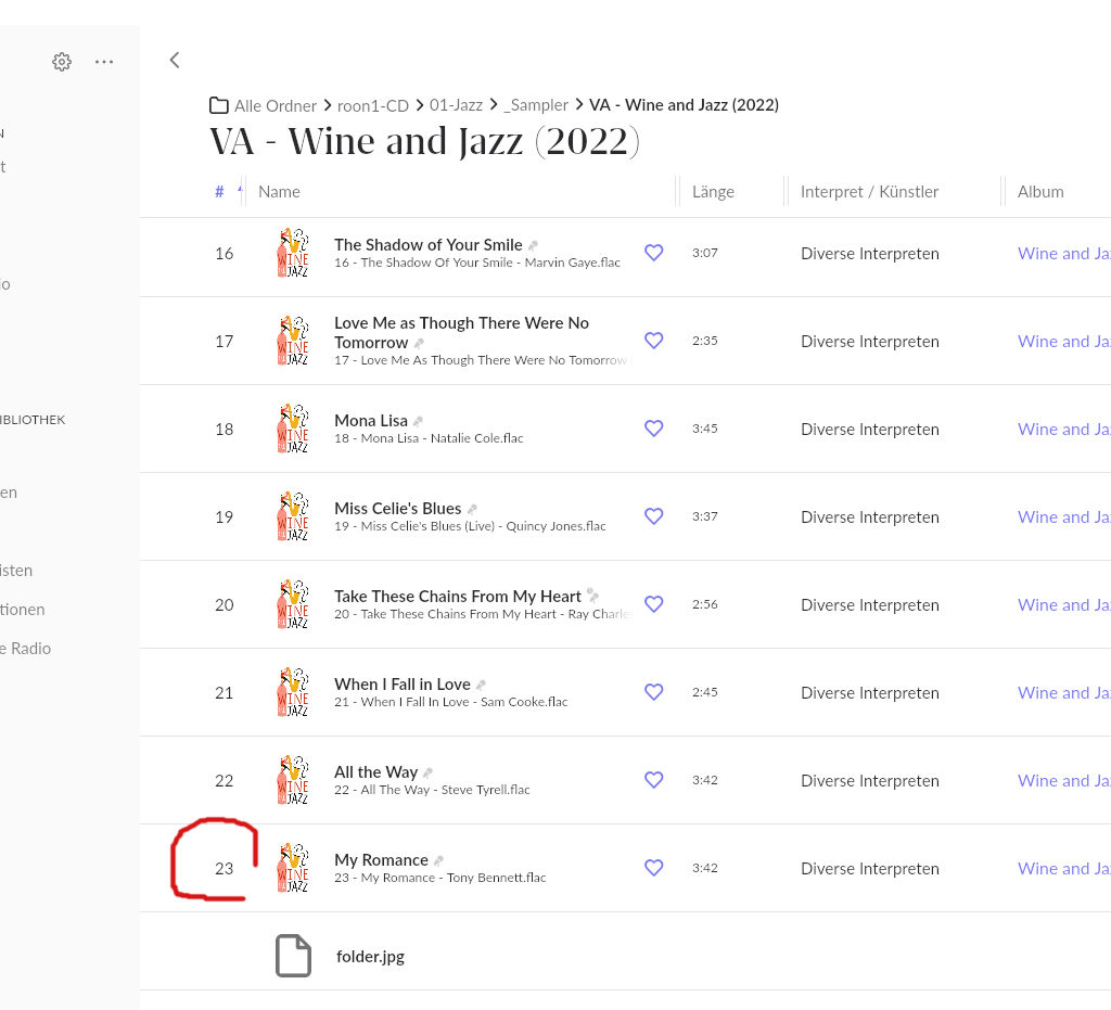

Albums that have been on the server since I started and have been correctly recognized are torn apart. They are no longer available as albums. Sometimes the error occurs with compilations, sometimes with classical albums; official releases where there is another composition in addition to the Symphony. (Is that a compilation then?)
And: As an additional error: Existing covers are not displayed
In his statement, Enno Vandermeer wrote “but we want more”. I had completely different hopes and illusions.
But now I have more albums in the display than are stored in my library. (The number shown changes daily, by the way.)
I have more albums without covers (previously zero)
I have more albums that were not recognized (because they were torn apart)

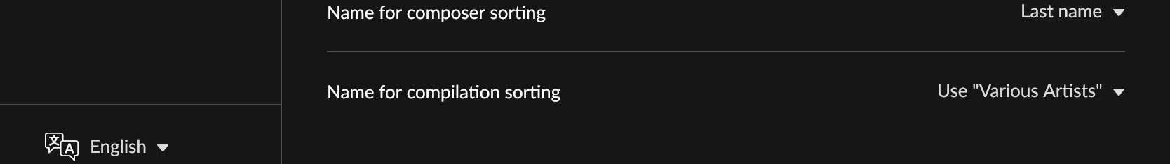

What happens if, under settings > general, do you have this set?:
Thanks, yes rebooting does solve it, but the multiple entries seem to come back over a few days. I’ve set the compilation sorting as suggested and rebooted, will report back if the issue returns
I should add that even though my compilation sorting is set per above, I am seeing this issue once again as well:
…so it’s still not fixed. This only shows when sorting by “Artist.”
I maintain that the issue might be cause by an illogical feature offering - I can see no reason to sort albums by “Artist” when in fact the “Artist” tag is a track-based tag; the sort feature should only be on “Album Artist” - this is what is causing this issue…

Ok so as stated above I rebooted and tried the compilation sorting suggestion. All was good for a few days but again I have multiple entries, and album view reports “showing 2952 of 2156” albums. It’s not a big issue as I can just reboot easily enough but clearly there’s a bug somewhere… thanks
