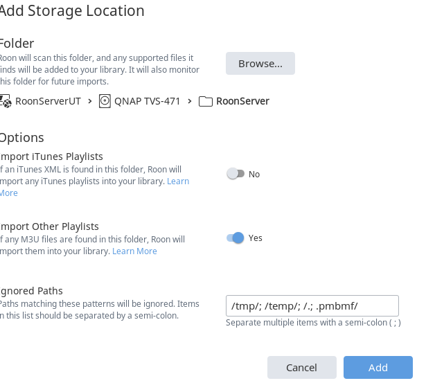

I am using Mac Pro running OS Sierra 10.12.4, music storage is a QNAP TVS 471 and a Bryston Player. My system is connected by CAT5.
Last night I updated the Roon software to build 216 and now Roon does not access my music collection. Tidal works fine and Roon sees both the Bryston and QNAP.
Most would have a music share on the NAS before installing RoonServer - So Roon Server is where the CORE is installed, but it is unlikely to be where the music is stored on the NAS
I can’t explain why it was working before if this was how it is - but unless you moved all the music you had on the NAS before RoonSever was installed to the newly created folder “RoonServer” on the NAS then you need to add a folder to tell RoonServer where the music files are specifically.

Where are your music files located specifically? Directly on the RoonServer share? If so I’d recommend to move them at least to a subfolder (for example something like “Music” or “Media files”). Otherwise your database location will be searched for media files as well and I have no clue if this might cause any implications. I put my music files on a separate shared folder (“Music”).

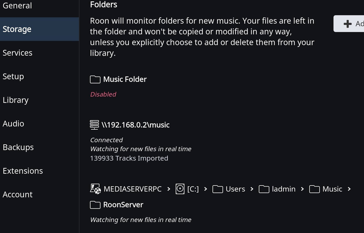

Can you provide a screenshot of your storage settings in Roon?
Hi @Steve_Child ----- Thank you for the feedback here and my apologies for the troubles here.
I see from your posts that you’ve provided us with screenshots of the “Add Storage Location” window (example #1). Can you please provide us a screenshot of the “Storage” tab (example #2) found under settings?
