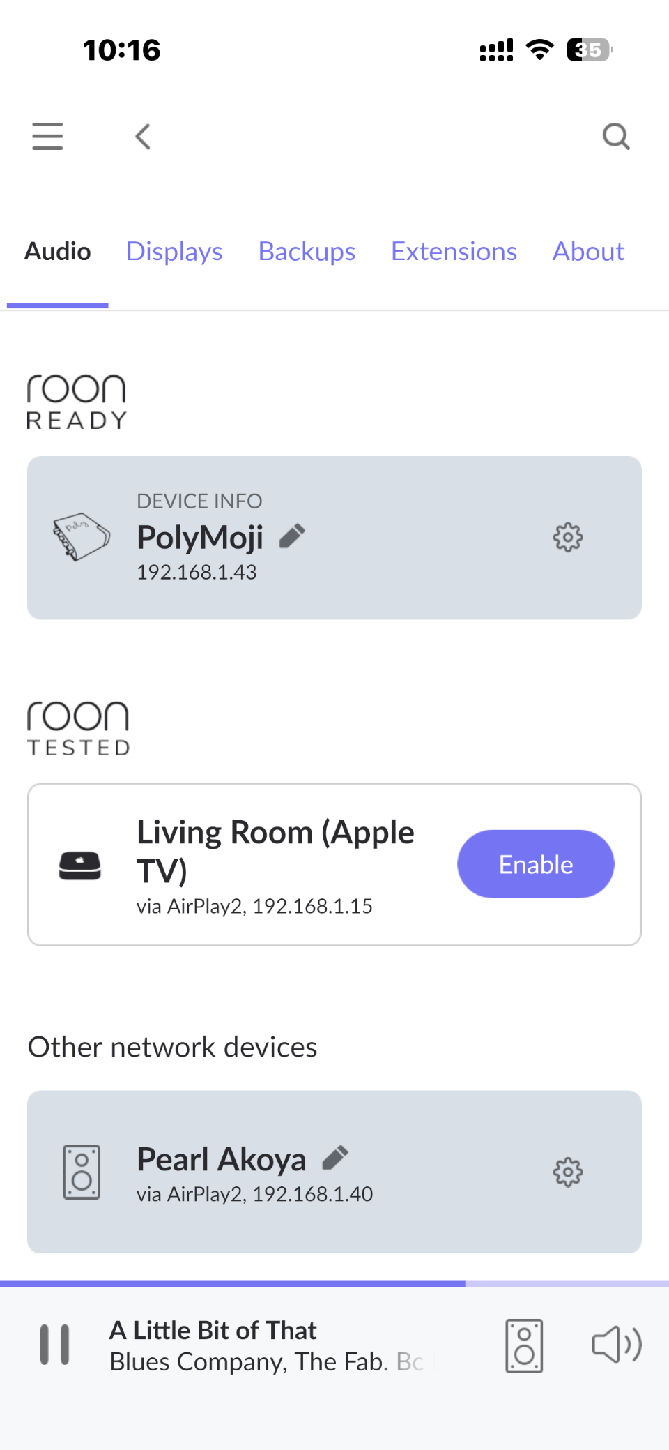

Cabasse Pearl Akoya - now Roon Ready. How to use this? Despite software updates on both my Akoya's and Roon nucleus, i can not see any other option than Airplay, no indication of the Akoya's being roon ready options within the audio settings tab? Can anyone guide me here please?
Simple WIFI with range extenders, Peal Akoya are both connected via LAN connected to router, rather than on wireless

Good evening, yes have rebooted my Roon nucleus. According to the Cabasse website/support the Pearl Akoya receive automatic updates every 24 hours, if in doubt they suggested switching on and off to effect the updates. After trying both sign of the Akoya being Roon ready. I have a Chord Poly/Mojo2 and this showing under the Roon ready list. Bit perplexed about this issue. Akoya still only showing as Airplay2 streaming devices on the list

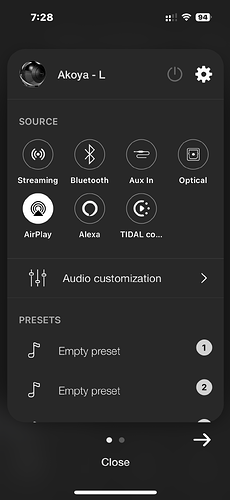

Just guessing… do you have to enable Roon Ready in Cabasse’s own StreamControl app?
Hi Arlen, within the Cabasse streaming app, there appears not to be an option for that. I tried selecting streaming (as per attached photo) but this changes nothing within Roon in the audio tab within settings.
Did you try to select ‘streaming’ and then roboot both your speakers and your Roon Server?
