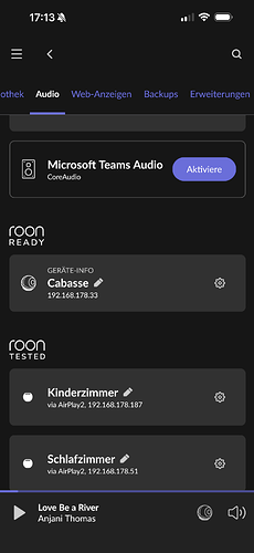

Could you kindly clarify what happens if you do not pair the devices as a stereo pair in the Cabasse application?

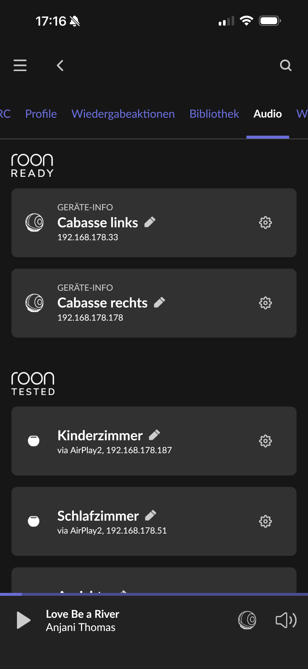

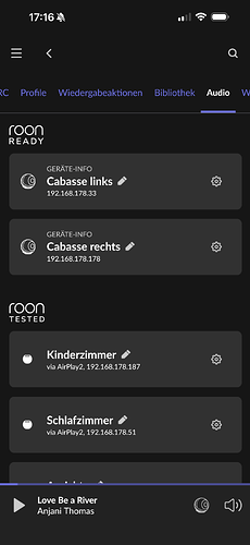

Additionally, please provide us with screenshots of how the devices appear in Roon → Settings → Audio when they are both grouped and ungrouped. This will help us better understand the behavior and assist you further.
Good day

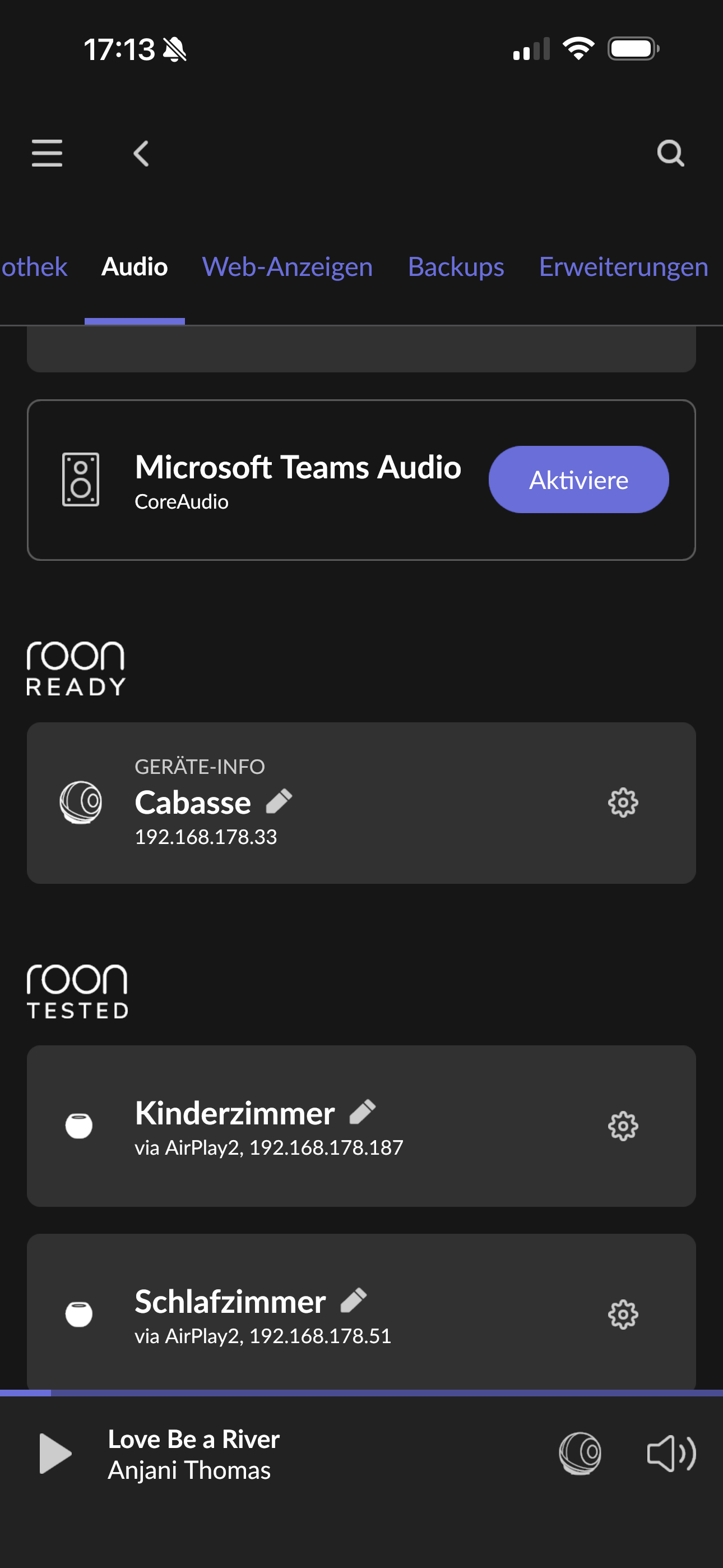

I have now removed the grouping in the Cabasse app. Both Cabasse speakers then appear in the Roon app. I can also merge them into a group. However, I believe that this is not a stereo sound, but that both speakers are playing in mono. Is there a way to generate ?copy? a stereo sound?
Please also find attached the screenshots of the settings in the Roon app.

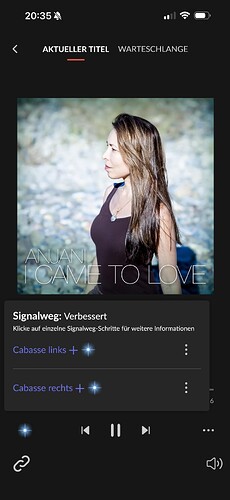

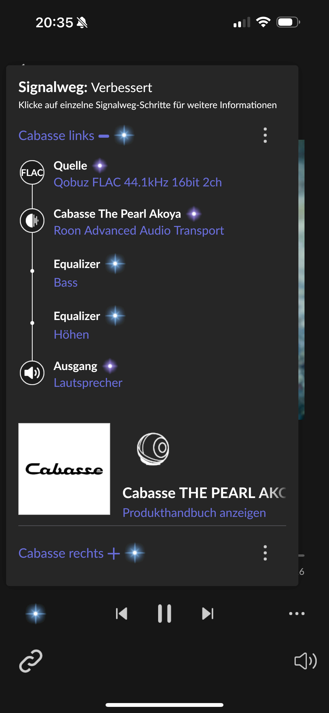

  • When you attempt to pair the Pearls via Roon, Roon distributes a dual mono signal instead of treating the Zones as a stereo pair

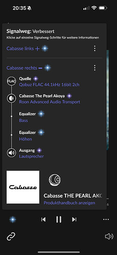

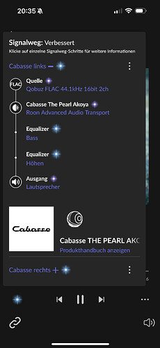

Please share a screenshot of the Signal Path in Roon while playing to the Grouped Zone.

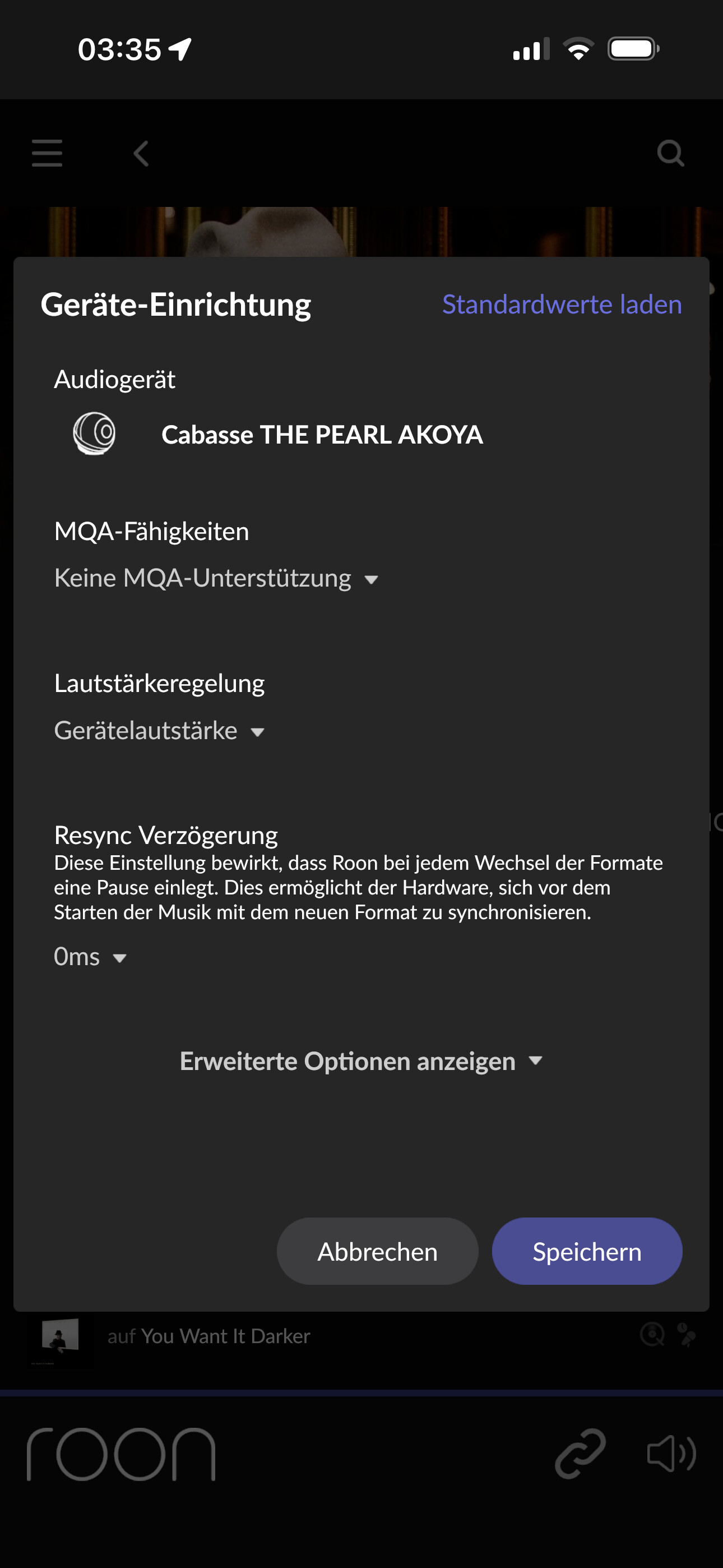

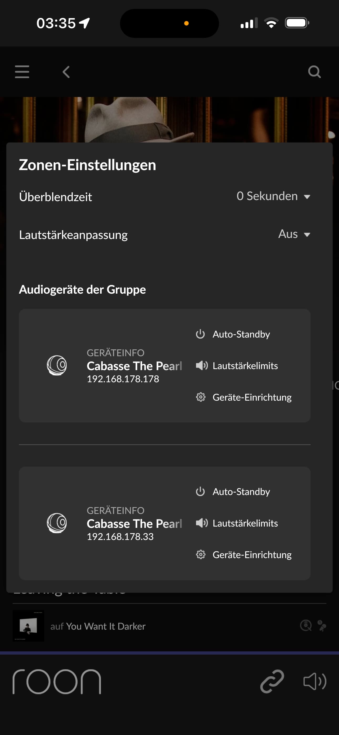

Please also share a screenshot of the Device Setup page for the Cabasse Zone when you have the speakers paired in the Cabasse app (click the gear icon :gear: in your first screenshot above).

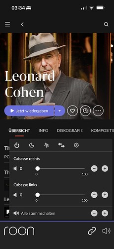

Attached I send the Screenshots:

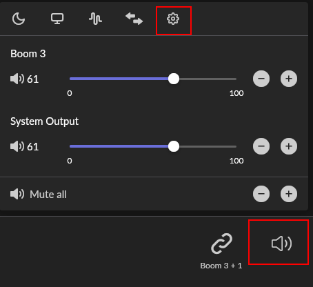

Thanks for uploading those screenshots. I wasn’t able to find the Device Setup screenshots that @connor mentioned—were you running into any trouble accessing that screen?
Here’s a quick guide to help:
First you need to click the speaker icon in the lower right corner of the Roon window then click the gear icon in the pop-up menu. That will open a menu showing all of your devices in the group with a button that says device setup.
Once we have those screenshots, we’ll be in a much better position to help. Let us know if anything about that process is unclear. We’re happy to walk you through it!
Attached you find the Screenshots.

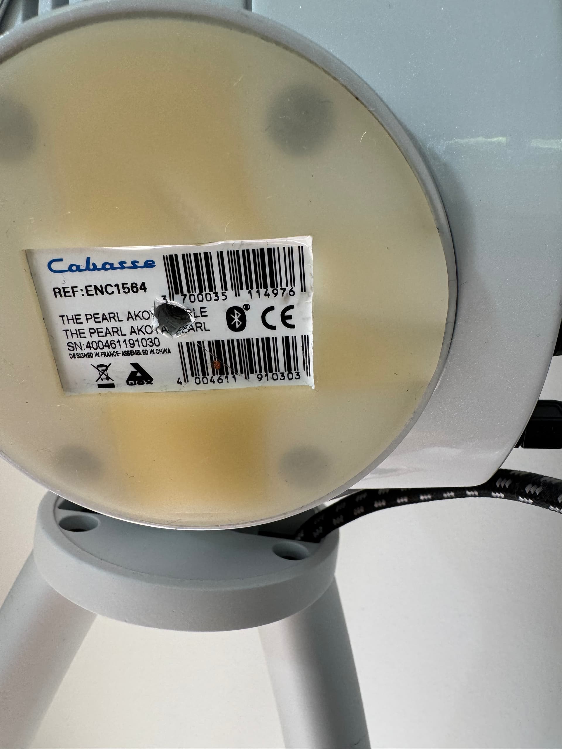

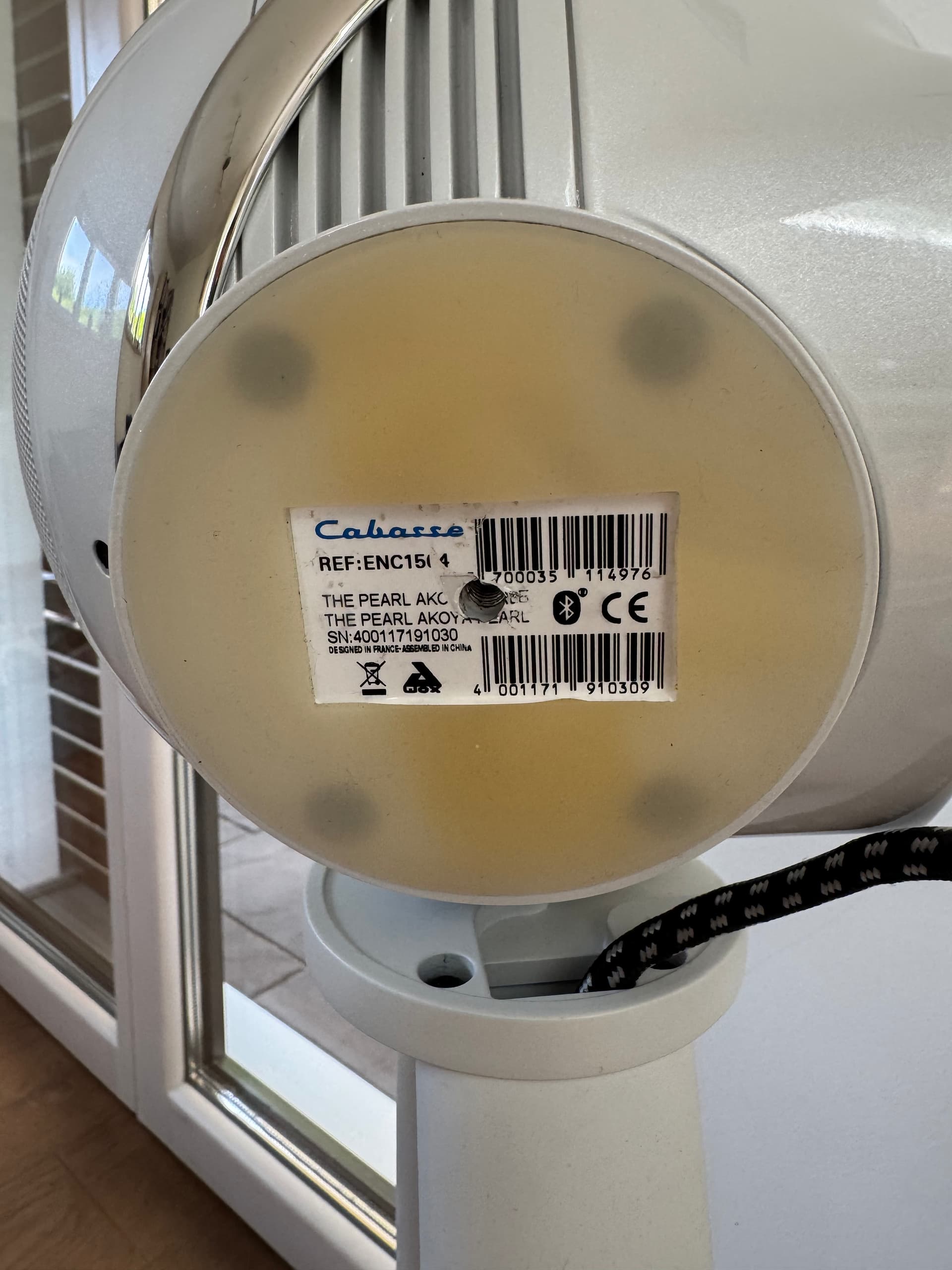

I already was in discussion with you about the topic but the talk was closed. i just send the request log files via File-Uploader.
I own 2 Cabasse Pearl Akoya speakers but did not find the serial numbers in the app.
Best, Dirk
