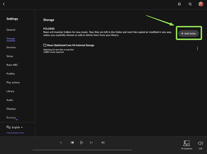

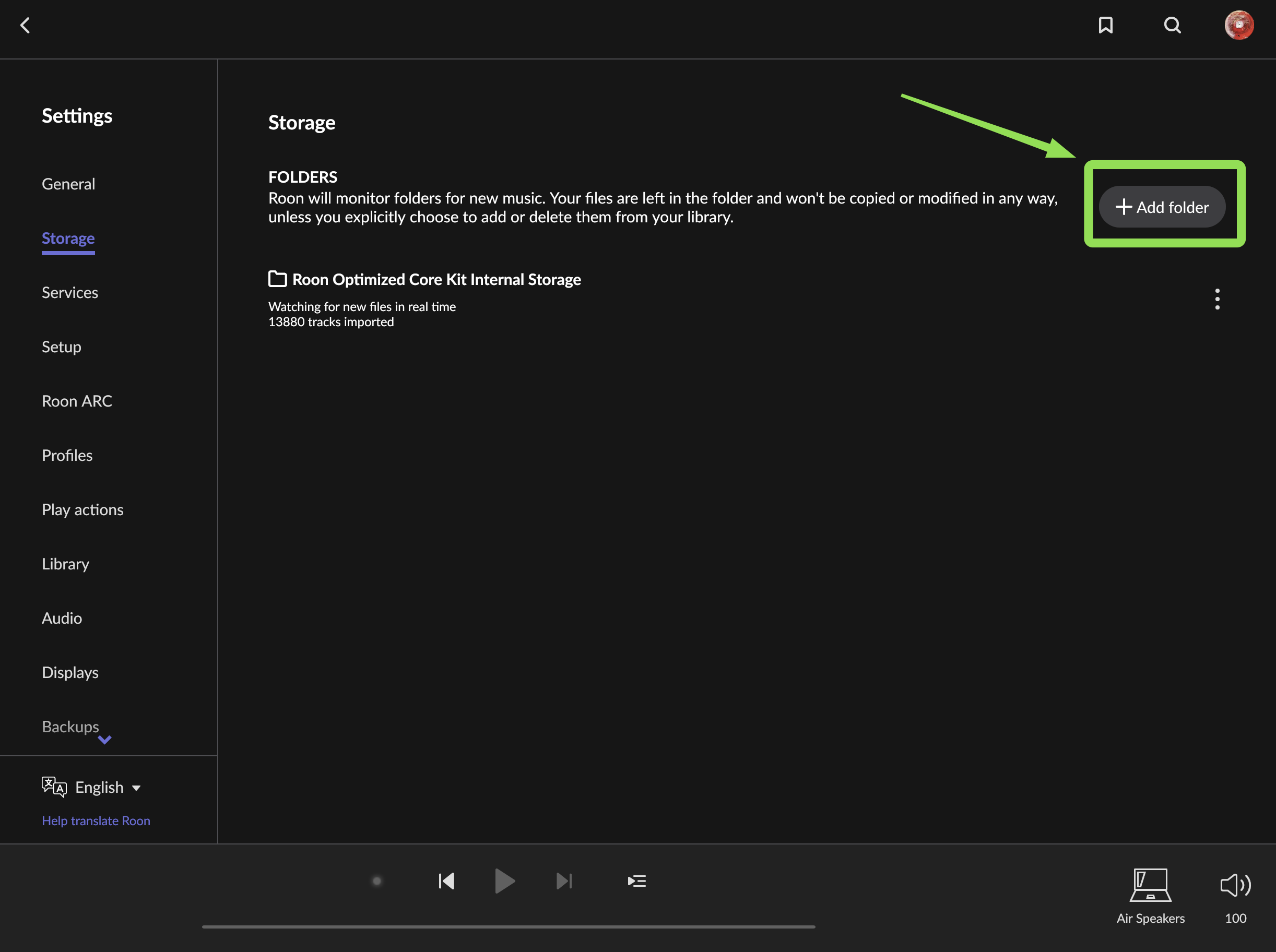

“It” does not store it at all. You put the music on the disk and then tell Roon where to find it. You can do so in Roon > Settings > Storage:
