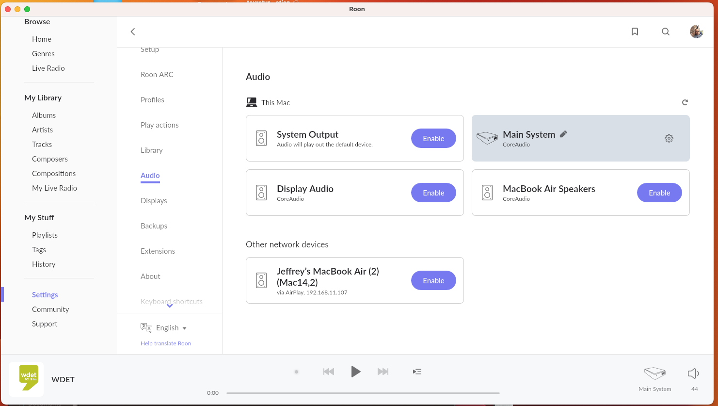

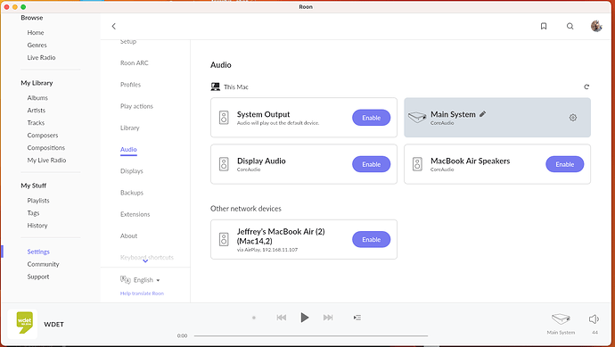

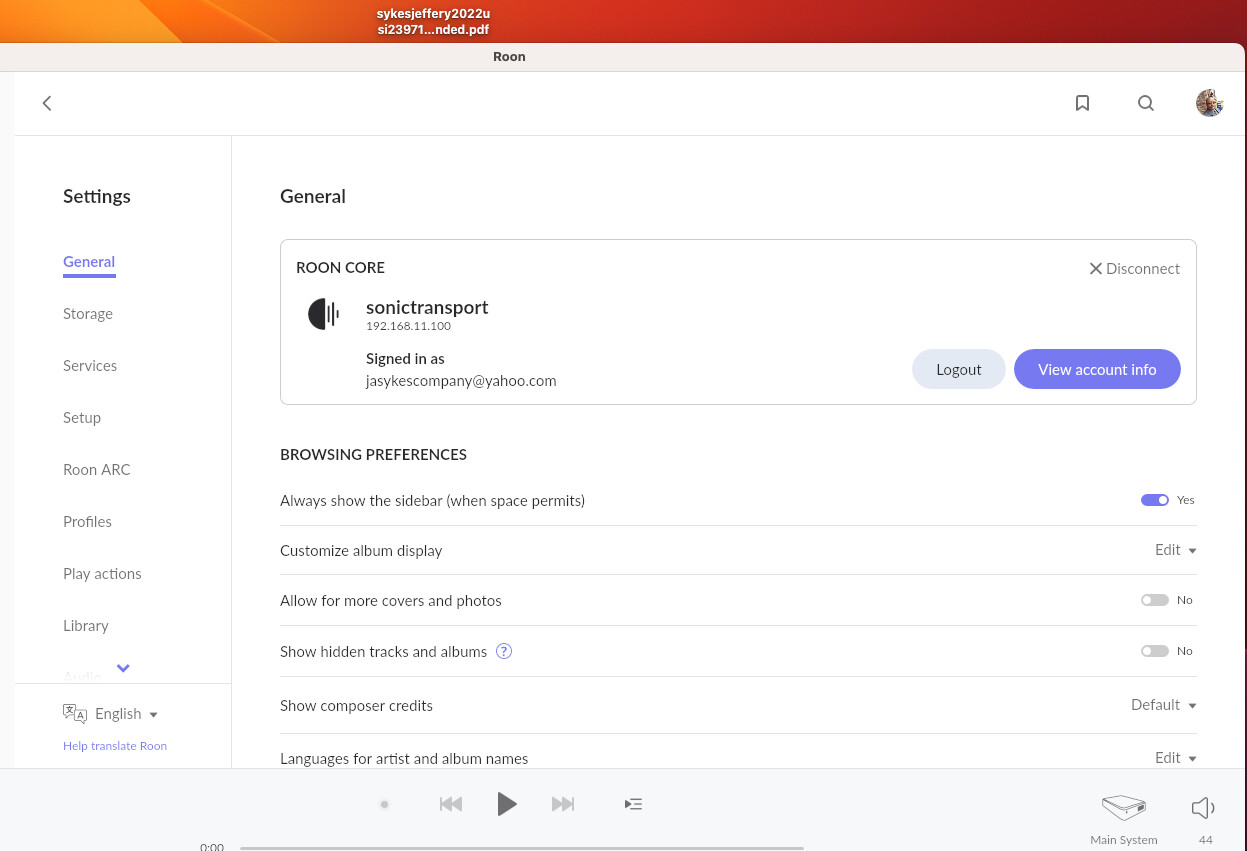

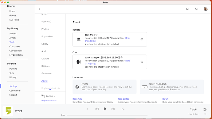

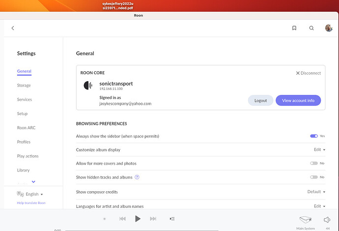

here are some screen shots of what I have in my Roon System. I hope some one can help solve this issue>
You seem to be playing your music through your Mac. Is this Mac connected to an amplifier or DAC? Or does it have its own speakers? Do you hear anything?

Your Sonic Transporter is your Roon core. It does not run Roon OS. This is purely for devices such as the Nucleus or Rock based systems. It’s Roons own operating system it has nothing to do with your system.

The mac can see the ST as the Roon core that is evident in your screen grabs , your mac shows the PS Audio dac is connected to it and the core is seeing this mac as an audio zone, your core has nothing directly connected to it audio wise so nothing shows up. So what is the problem? Roon only runs as a server on the Sonic Transporter you can only connect to it via other devices running Roon apps. It will see all Roon supported device over the network or via a DAC directly connected to it. There is nothing showing in you grabs as beinf connected to your core, just the mac via the network with the PS Audio device connected.

You images show you mac connected to a DAC via core Audio what is this?

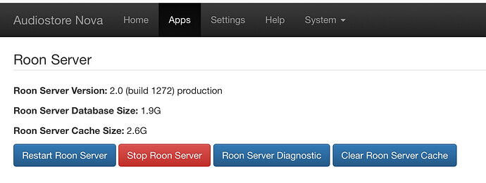

On top of what CrystalGipsy said, it also can’t hurt to restart RoonServer, here:

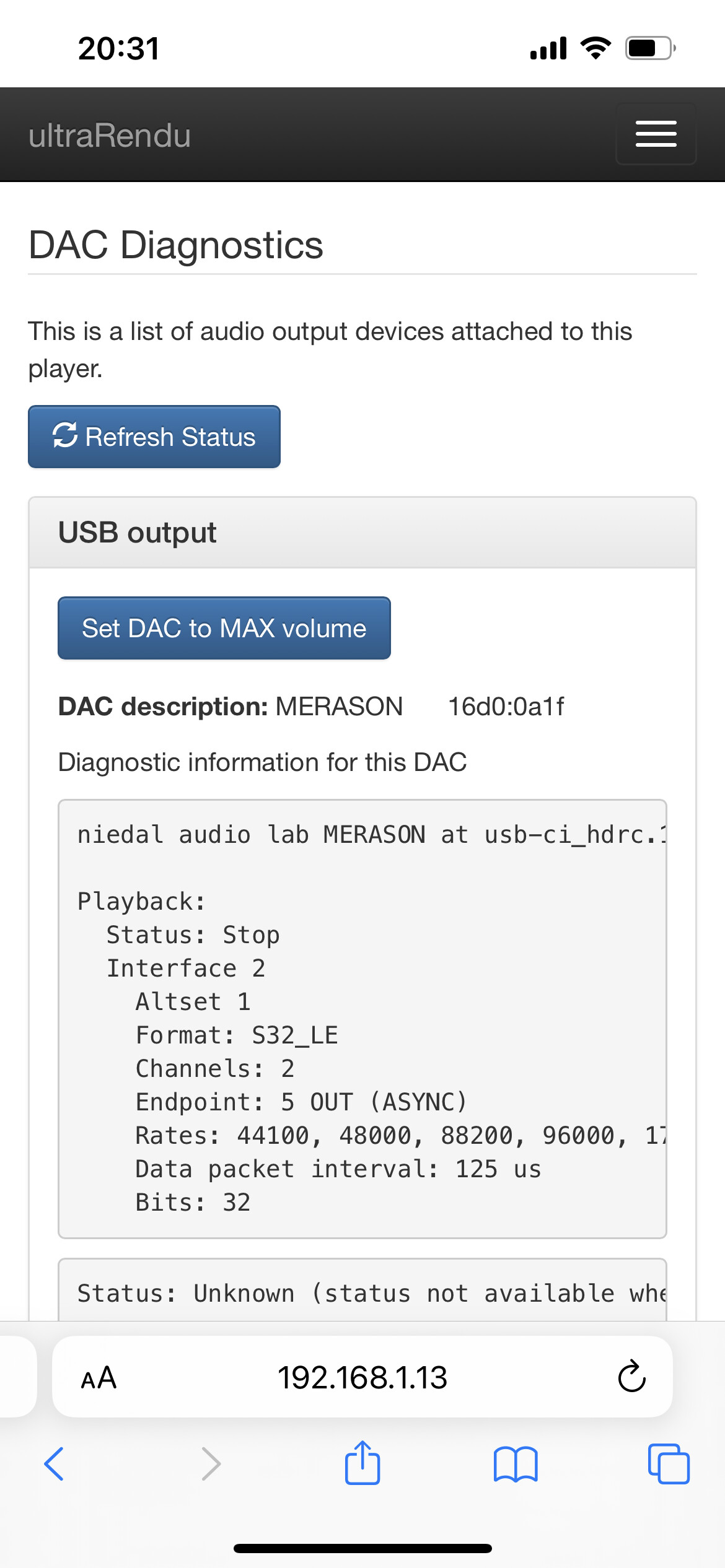

Go to the settings of your SonicTeansporter, there should be a “DAC diagnostics” app. What does it show?
Your issue is between ST and the DAC
I have an UltraRendu (player only) running the same SonicOrbiter s/w and here is what it will show when the DAC is connected
The same app displays an error when the DAC is not connected
