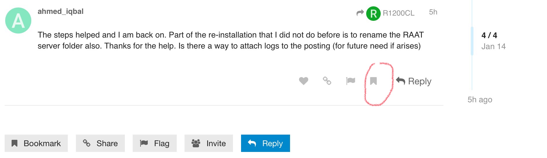

The steps helped and I am back on. Part of the re-installation that I did not do before is to rename the RAAT server folder also. Thanks for the help. Is there a way to attach logs to the posting (for future need if arises)
If I understood your question correctly. Maybe I totally misunderstood
No you can’t upload upload files in posts. Only pics.
