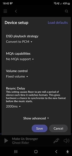

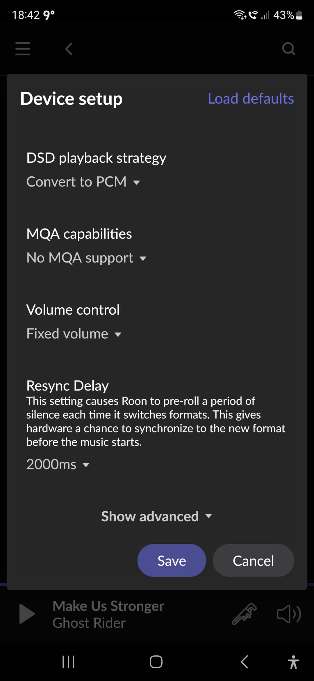

Are you aware that you can set a Resync Delay in Roon to avoid glitches in sample rate change?
Yes, I do, but it does not eliminate the glitches with the M2Tech DACs I own. It’s probably another firmware issue. I’m now waiting for M2Tech to tell me why the DSD crashes so severely with that song. Hopefully, they’ll do it.
