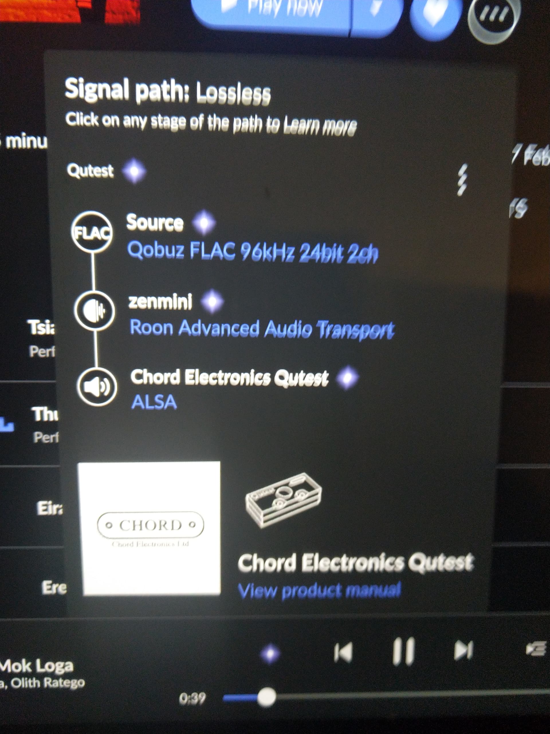

I have attached screenshots of the app (on iPad).

Thanks for the help. Looks like I mixed up the input selections on the Qutest and the zone selections on Roon as well. The problem seems to be solved, as shown on the screenshot. Maybe it’s better I’ll remove the BNC cable, so I can’t mix it up.
