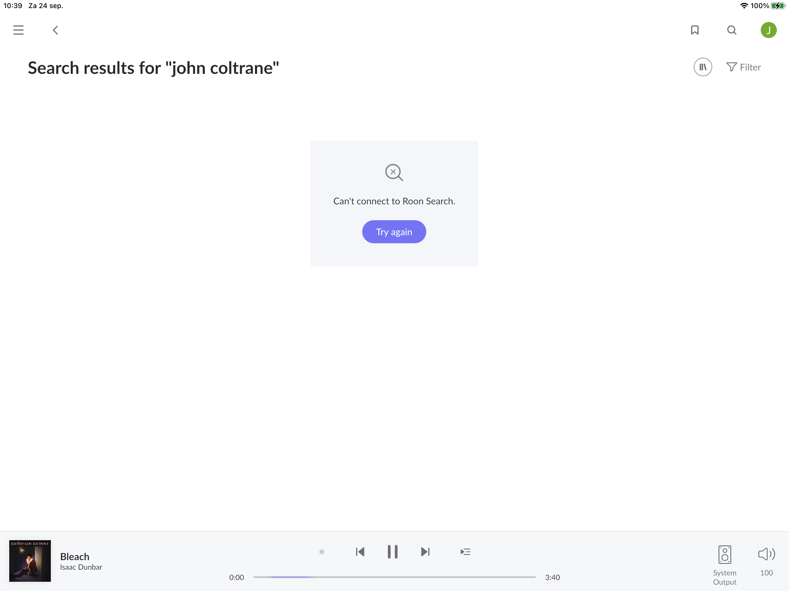

Can’t connect to roon search huge problems since update
Since the last update i am encountering a very slow roon en often receive “ can’t connect to roon rearch”. Today is John Coltrane birthday. Yet roon will not be overloaded with search results?
Extremely annoying as spotify get it within a second. Now i have been patient enough after roon’s update.
When search item prompted into tidal: a second.
The weird thing. I can enter albums in my library. When i select one of John Coltrane, i can select all of coltrane there.
But the search engine fails. Again…
Am i the only one with this issue?

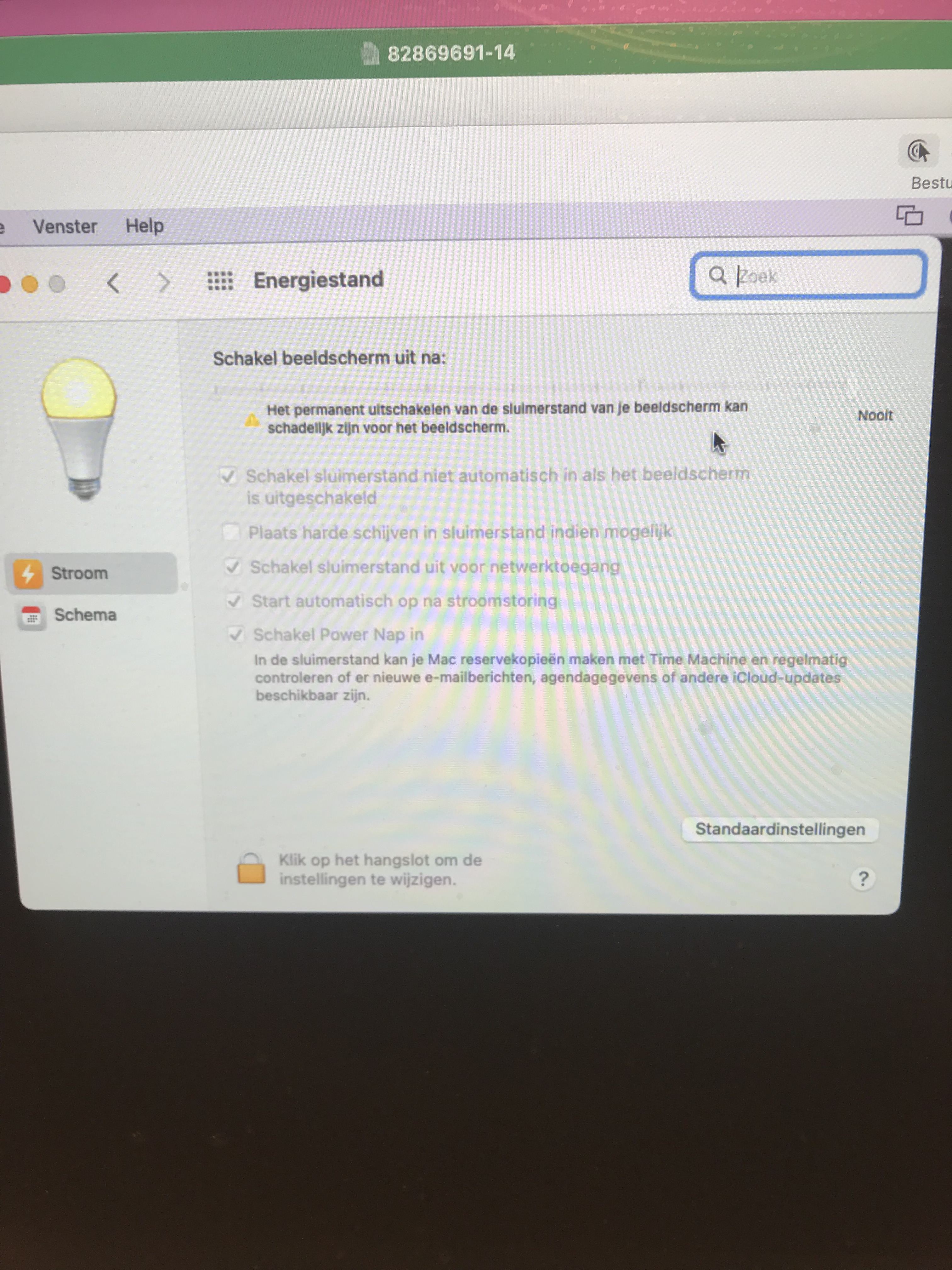

Can you give me a screenshot of your settings under Mac system preferences > Energy Saver? This can make odd errors happen since the Mac is tending to sleep regardless of what Roon is doing.

Screenshots as asked.
![IMG_5453.HEIC|375x500](upload://dSEOd5nVwirMNAE4mt6gkiVC0MK.jpeg)
