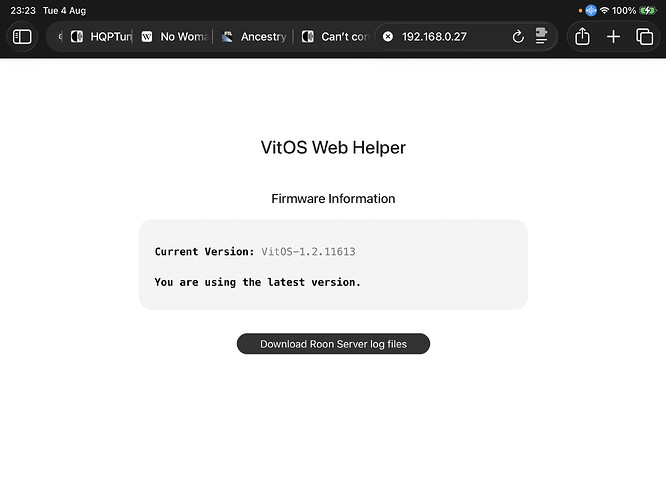

Hi Benjamin,
Your explanation of how you saw the update in the log files make sense. When I perform the update from the earlier version, it downloaded it in the iPad roon app and then lose connection permanently when trying to restart. When I check on vitos manager it just says stopped. So this time I restarted the silent angel and in the menu for Roon server app tap the start button, as you can see in the photo above of the webpage. Indicated it was running, but when I checked the roon app it couldn’t find the server, then when I went back to vitos manager, roon server app stopped again. It was after that that I downloaded the log files again, hoping it would give you the start-up process you asked for.
When I put the silent angel’s web address and I only have one option, to download Roon server log file files, as shown in the photo below. I hope this gives you what you need.

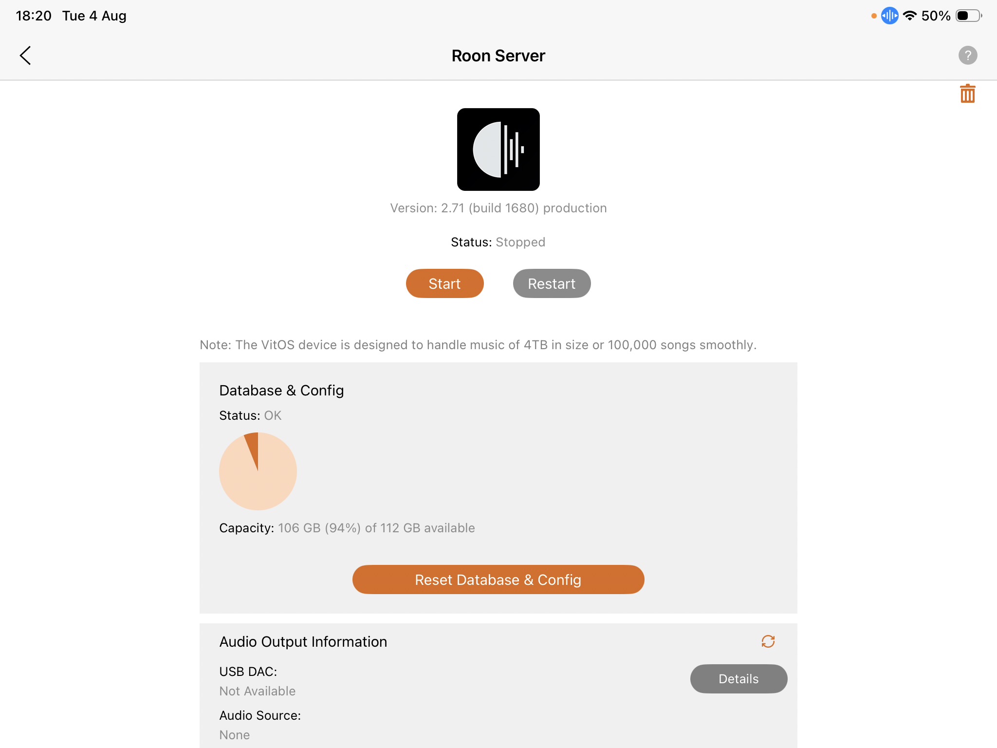

· Subject: Silent Angel Rhein Z1 V2 - Roon Server 2.71 (build 1680) won't start after update
Hello,
I'm using a Silent Angel Rhein Z1 V2 running VitOS 1.2.4397.
After updating Roon Server to Version 2.71 (build 1680), the server no longer starts.
What happens:
The update installs successfully.
The server starts for a few seconds and then immediately changes to Stopped.
Database & Config always reports Status: OK.
No database reset has been performed because I want to preserve my library and settings.
What I have already tried:
Rebooted the Rhein Z1 several times.
Uninstalled and reinstalled Roon Server from the VitOS Manager.
Verified that the network is working correctly.
Downloaded the Roon Server log files.
The older bundled Roon Server 2.0 (build 1483) starts and stays running normally.
As soon as I update again to 2.71 (build 1680), the problem returns and the server immediately stops.
This makes me believe that the issue is specific to Roon Server 2.71 (build 1680) on the Silent Angel Rhein Z1 / VitOS platform.
I have attached the latest Roon Server log files.
Could you please help me identify the cause or provide a workaround?
Thank you.
