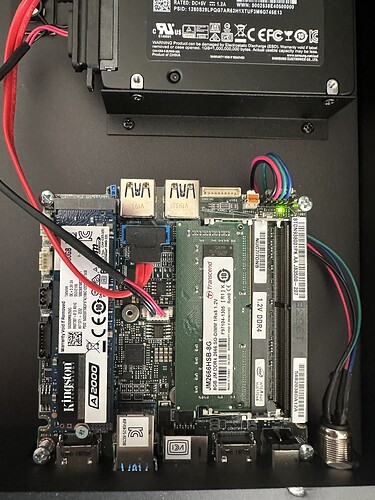

Following up here, can you check the internal LEDs when turning the Nucleus on? More information about the failure can potentially be found by opening up the unit and taking a look at the LEDs while it
is connected to power. Unscrew the bottom panel and look at the LEDs below:
Power Switch LED
There is a power switch on the board which powers on the board. Try pressing this. RevB pictured below:
Screen Shot 2023-05-23 at 4.30.40 PM
If the Nucleus powers on at this point it means the other power switch is bad and needs to be replaced.
If the LED flashes in a pattern, this pattern could tell us more about the issue. NUC blink codes can be found on Intel’s site. The most common one that we’ve seen is 3 blinks, meaning a memory error.
Remove the RAM, verify that the slots are clean and free of any debris, and then place them back in.
Sometimes this might fix the issue.
If not, an RMA is needed to replace the RAM.
I’ll be on standby for your reply. Thanks! :+1:
The LED comes on with the external switch, both the white and green. They are both on solid. I don’t see the Nucleus+ connected to my router. I have a static DHCP entry for it. I have also rebooted the router. I don’t have an HDMI cable handy but I expect it would be the same as when I tried it earlier.
Thanks for the additional information @Terry_Murray. I’ll follow up via PM with next steps on getting an RMA started.
