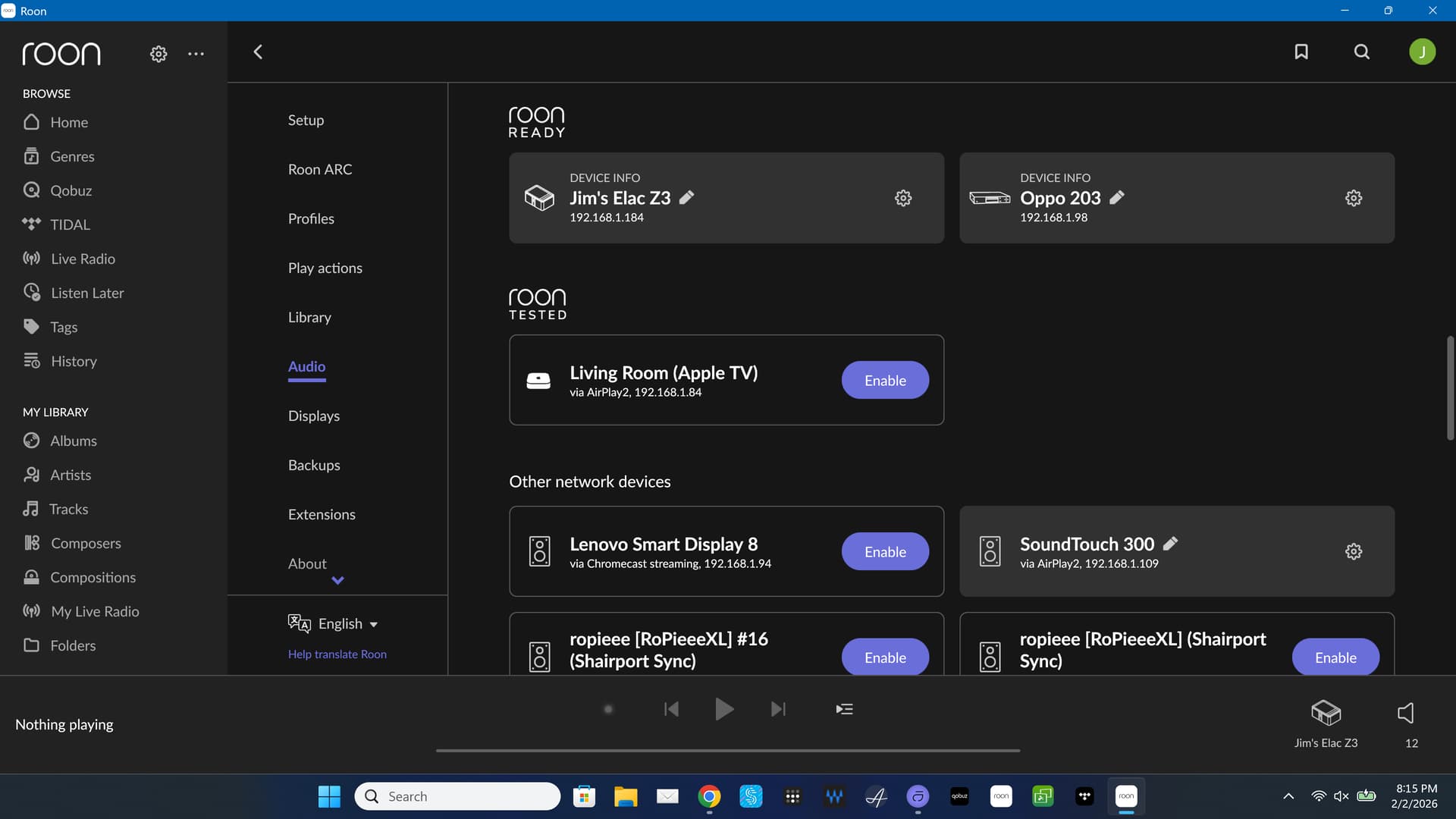

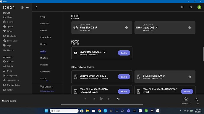

You gave me an idea. So, I moved my NucBox G5 to the family room next to my Bose Soundtouch 300 that is supposed to play 5.1 to all 5 speakers and subwoofer. I used HDMI directly from the NucBox G5 to the auxiliary HDMI input on the Bose. It will play Roon through the soundbar but nothing from the rear surround speakers. I have two streaming albums that are supposed to be 5.1.
Any ideas?
Have you checked the device setup - show advanced - to see what the channel layout is set to? Options are 2 channel 5.1 and 7.1. Is there any setup in the 300 for the HMDI input?
I’ve put it on 5.1. The Bose only does HDMI through the main input and aux input. The only setting choice I see is for CEC on or off.
AI says the Bose can’t do a PCM input as anything but 2 channel. It that my issue? Maybe I need to route through the Oppo 203 instead of direct.
I searched on Bose Soundtouch 300. AI had this responce:
Configuration: To ensure true 5.1/PCM, use the SoundTouch app: Settings > Speaker Settings > Advanced Setup > HDMI IN Direct Audio.
I’m just guessing here.
Thanks, I already had that set up properly. I’ll look to see if I can go through the Oppo 203.
