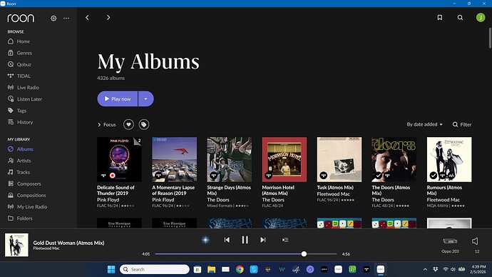

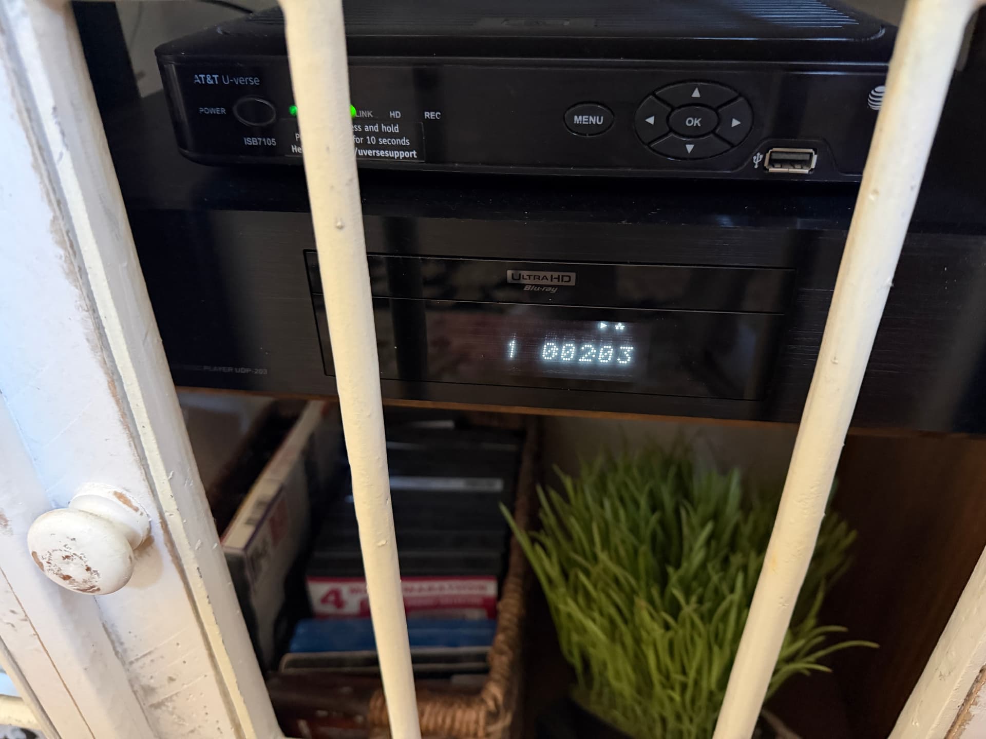

I got it working through my Oppo 203. Thanks.

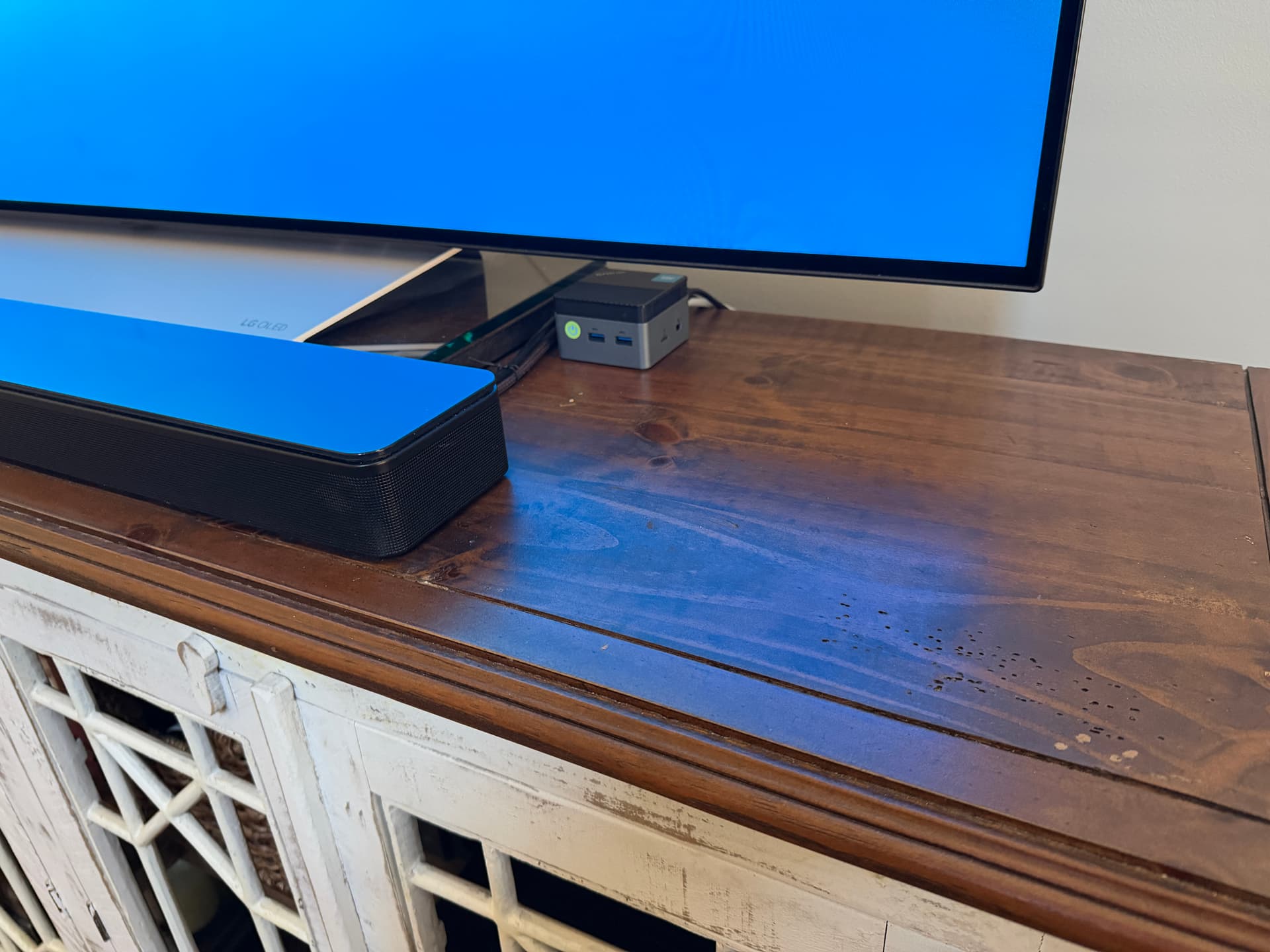

I use a little HiGole PC for one of my endpoints (I have it hooked to a stereo DAC/Amp, but it would work multichannel just as well). It has a small touchscreen so it works as a perfectly fine Roon client, too. A version without screen could work as a Roon Brtidge and be controlled from any other Roon client.

Just to summarize, if you want to play 5.1 using Roon, use an HDMI cable from your Roon server to your Oppo 205 auxiliary input (assuming you’re using the main HDMI input for something else). Then, you should be able to play 5.1 to your attached surround sound system.
If your Roon server is not near your Oppo 205, it might be easier just to add another Roon server such as the NucBox G5, etc. You can switch Roon servers back and forth easily with a single Roon subscription. I have four Roon servers for various reasons.

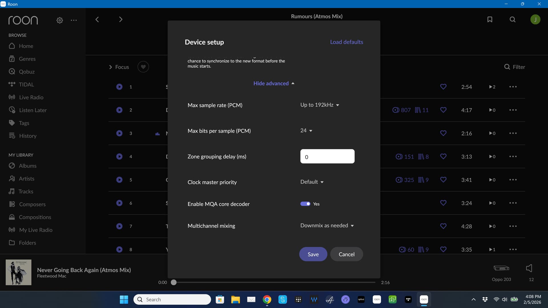

This is a Tidal Atmos Mix being downmixed by Roon to 5.1 since I don’t have an Atmos setup. Don’t use channel mapping for this or you will lose the extra sounds that exceed your speaker setup. Evidently, Atmos downmixed to 5.1 can often sound better than a 5.1 mix.

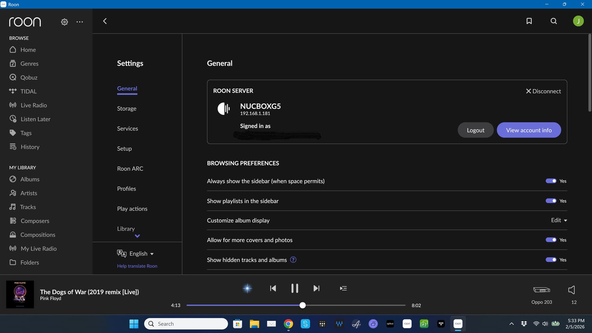

Yes, that’s what I am doing. When you activate a Roon server, you will deactivate the other. It’s very easy switching back and forth. It does mean that when Roon does an update, you will have two servers to update, but not really a problem. I update 4 servers and 4 clients with no issues. You can confuse yourself occasionally if you forget you’re not connected to the server you’re trying to use.
You don’t need to keep transferring your license back and forth. You can have a ROCK/NUC just as an endpoint to feed your OPPO via HDMI. You just don’t use the Roon Server in it.
This is a similar situation to an installation of Roon on a Windows PC or a Mac. The install has the Roon GUI, a Roon Server and the Output module. These are all independent from each other, you can mix and match according to what you need.

I don’t see a way to do that. For me, since the Oppo is a Roon Ready device, it connects to my Nucleus over RAAT and the connection via my NucBox G5 does not show up.
EDIT: Maybe it can be set up twice in Settings - Audio.
