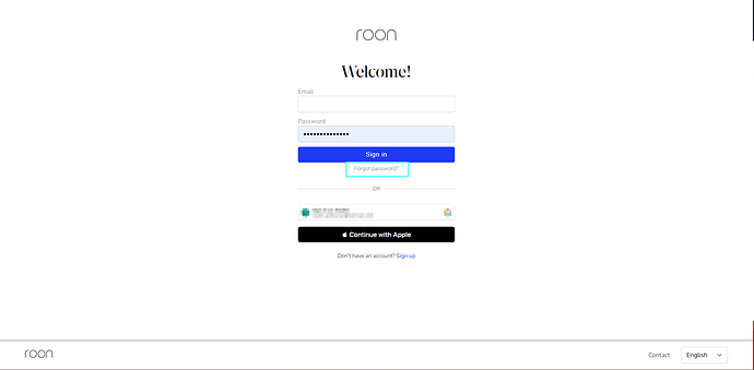

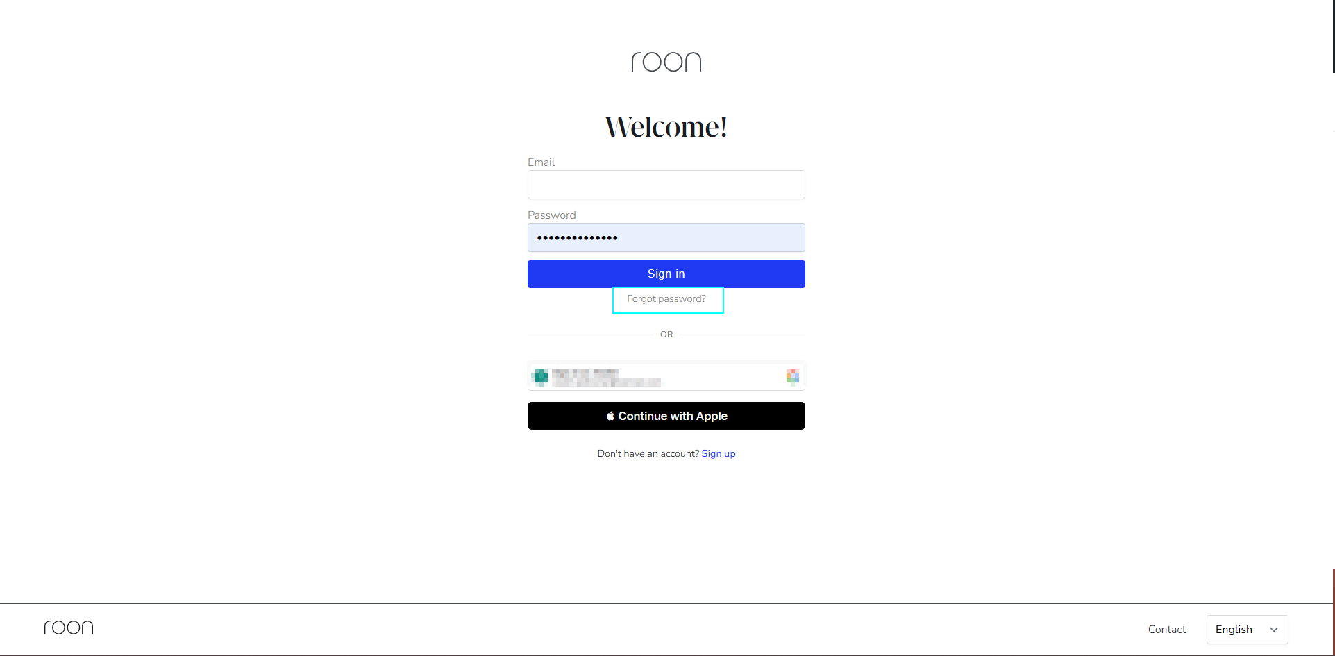

Hello @francisco_gaston,
Have you tried using the password reset link on the login page and following the instructions sent to your email address? Please let us know if the problem persists after resetting your password, and we will involve the team responsible for accounts to resolve it.
HI @francisco_gaston,
Diagnostics indicate that your RoonServer is online. If you’re encountering issues with login in Roon remote, it might be the result of adblockers/content blockers that are installed in your browser.
In whichever browser you’re using on this device, enter the Preferences or Settings page and ensure content blockers are disabled temporarily. Try logging in from the Accounts page in Roon and then open the app.
Let us know if this helps.
