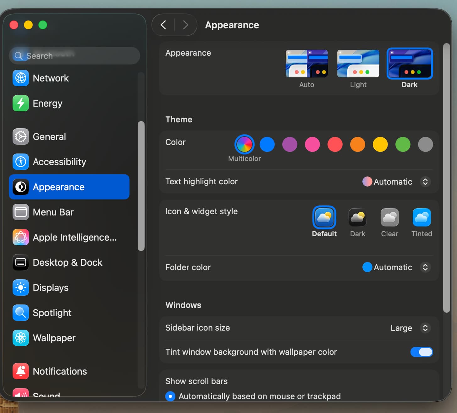

Here is a screenshot of the settings application onmac tahoe with the appearance on either dark mode or default mode Note that : dark mode is the problem to start the Roon application ( can not give a screenshot of that since it does not start up at all ) Thank you

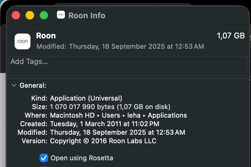

The other thing to check is to try to run the Roon via Rosetta, it is not helping to resolve all the Tahoe related problem in Roon, but it might be helpful with some of them until new release has come. Can you please try that ?
