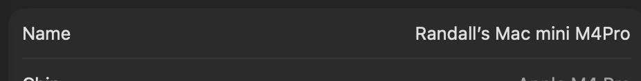

You can also find a Mac‘s name like this:

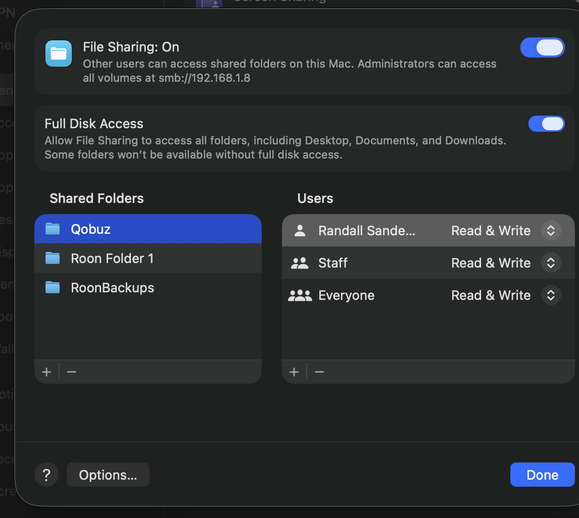

smb://RandalliniM4Pro/Roon Folder 1 shows as being shared as is /Qobuz

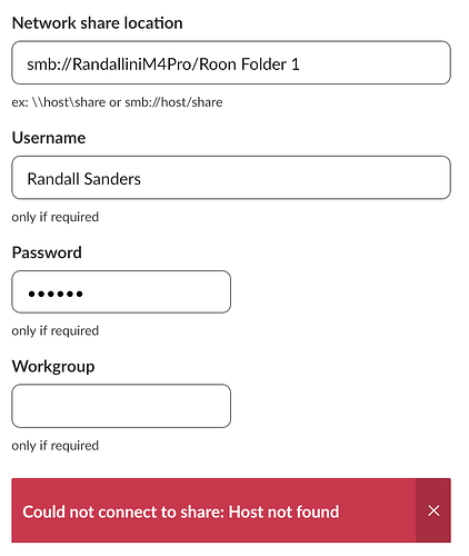

And does it work?
Keeps giving me an Error

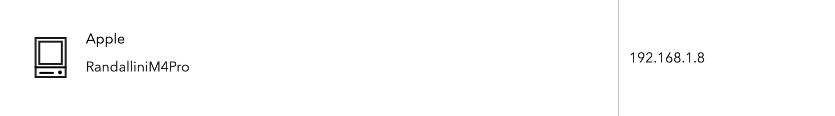

Where’s the RandalliniM4Pro taken from, the Mac or the router’s admin page?
Router admin page
Looks ok to me, so far. What’s the error that you get then?

Hm ok weird, if the router knows this name and then can’t find it.

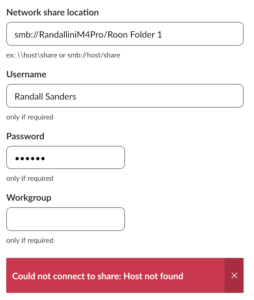

I realize that the error being shown might not be consistent with what I am about to say, but the username should not be your full name; it can’t have spaces.
