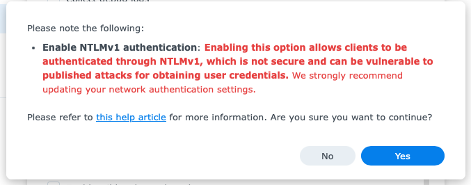

· Can't connect to backup on Synology NAS . Synology NAS shows a warning that connection using SMB1 is not permitted. Connection via Finder in MacOS using SMB is working perfectly fine.

Could you please check the Minimum SMB: On your Synology, go to Control Panel > File Services > SMB > Advanced Settings. Ensure the Maximum is SMB3, but try setting the Minimum to SMB2
In those same Advanced Settings, look for the “Others” or “Security” tab and ensure “Enable NTLMv1 authentication” is checked.

Min is SMB2 and max SMB3.
“Enable NTLMv1 authentication” not selected. I get a security warning when I do…
