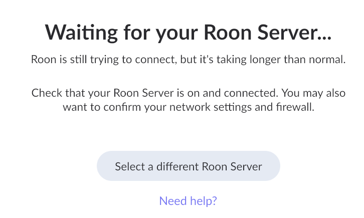

· "Waiting for your Roon Server"
What happens if you press the "Select a different Roon Server" button?
· I don't see Roon Server.
· *Linux Server* (Ubuntu, Fedora, ArcLinux...)
I can no longer connect to my Roon server since Roon today's upgrade
To access the internet from home, I use a livebox from the largest ISP provider in France (Orange) coupled with a Devolo extension. Everything was working perfectly fine until today's upgrade. Here are the details of my Antipode DS server Version: 2.5 Model: D2 IP Address: 192.168.1.17. Thanks in ad

You’re the second Antipodes user with an issue I’m aware of. As suggested in the other thread, please also open a support request with Antipodes support.
Hello @marc.escande,
Thank you for providing these details.
We are currently investigating a similar report where Roon fails to start following the latest update (you can check another thread here: community link).
To confirm if your Antipodes server is experiencing the exact same issue, we need to take a closer look at your logs.
Could you please upload your Event Viewer logs (or Roon Server logs) to our secure uploader here: Logs Uploader ?
Once we have the logs, we’ll be able to compare the error patterns and provide more specific guidance.
Thanks.

Apparently, the new version of Roon isn’t compatible with our Antipodes DX. In fact, they haven’t received any updates for quite some time. For those experiencing this issue, the question is whether it’s possible to roll back your latest update to the previous one, which worked perfectly?
Looking forward to your reply,
Christophe
Hi @Kerdiles_Christophe,
Thank you for your post. We understand it’s frustrating to suddenly be without a server.
Roon has updated our minimum requirements for both stability and security reasons; unfortunately, it won’t be possible to roll back to the previous build.
Unfortunately, the best path forward is to reach out to Antipodes directly to discuss options for the DX. They consider this particular unit a legacy Early Model, and it’s very likely deprecated for firmware updates.
