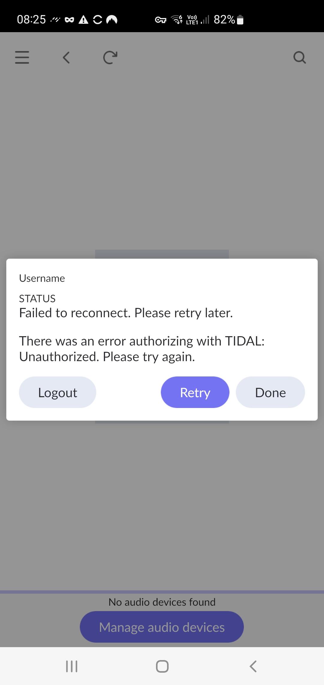

· 8:19 CET abd i also noticed browser telling "roon+tidal: you have successfully connected your tidal account" but still in roon app its not.
Suddenly I was logged out of Tidal in the Roon App. I tried to login again on Roon App on Android Tablet, on Android phone and on Windows PC where also Roon Server Runs. I can login tge Tidsl app but on Roon App I cannot connect to to Tidal anymore. I get linked to login page on browser and get a checkmark for success but Status in Roon remains "Failed to reconnect", error authorizing with Tidal. I turned of Roon Server but did not help.
ASUS TUF-AX6000 ROUTER, Minix Z300 PC, Asus XD4R Mesh router, but it worjed since 6 months abd i made no change at all yesterday when it stopped working. isp IS Sunrise.

Hi Noris, I can login to Tidal using the app and it was not a cache issue because the problem was simultanously there on my PC, on my smartphone and on my tablet.
Later today it suddenly worked again but I did NOTHING! It’s mysterious.

Today I’m again logged out. Its very annoying and I never had thT issue befoee 2.65.

Logs show Roon successfully logging into Tidal’s servers on startup, but when the session attempts to renew in the background, there’s a port binding error with the authorization request to Tidal’s servers.
Do you have BitDefender, Kapersky, or another SSL-inspection security software installed on this PC? This might be intercepting the HTTPS request. A Roon update can trigger different behavior in security software because it will appear as a new executable. Try safelisting Roon’s IP or testing with temporarily disabled SSL scanning.
Also make sure that RoonServer.exe is safelisted in the Microsoft Defender firewall.
No, I don’t have and I did not install anything new in the past months. It might be a Windows Update, but that would not explain why it sometimes works and sometimes not. Firewalls either block or do not. Therefore I don’t think it has to do with any security software on my side and I think I deactivated firewall and virus software on that PC.

Thanks for letting us know, @Marc2025 . I wonder if this failed request could be related to your DNS. We have seen users have a better experience in the past if they change their Router’s DNS servers from the ISP-provided ones to Cloudflare DNS, Quad9 or Google DNS. Can you please give this a try and let me know if it helps?

Nevertheless, in thIs case I did never change the DNS and it always worked before. I checked the DNS (also with LAN scan App) and I’m using the Google DNS 8.8.8.8 for Roon Core. So it should be ok.
