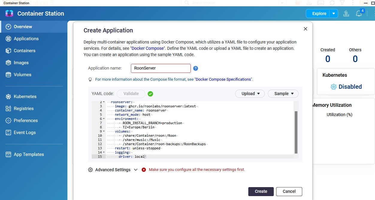

· I have a QNAP TBS-453A NAS and I am trying to set up the docker version of the server. I have installed conatainer, copied the YAML, valdiated it, when I press create I ge the message: "Make sure you configure all the necessary settings first."
· Fritzbox 7590
Then, by all means, please give the application a name (red border because there is an issue) that meets the requirements (click the question mark to learn more about naming requirements).
Hello @martingh
The error “Make sure you configure all the necessary settings first” is caused by the Application name format. As indicated by the red border around the “Application name” field in your screenshot, QNAP Container Station requires this field to use only lowercase letters.
Change the Application name from RoonServer to roonserver and click Create.
Thanks! I did not notice the red border. The error message is perhaps a little cryptic. Anyway, I have now entered a correct name, so let’s see if it all works…
