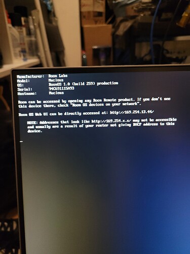

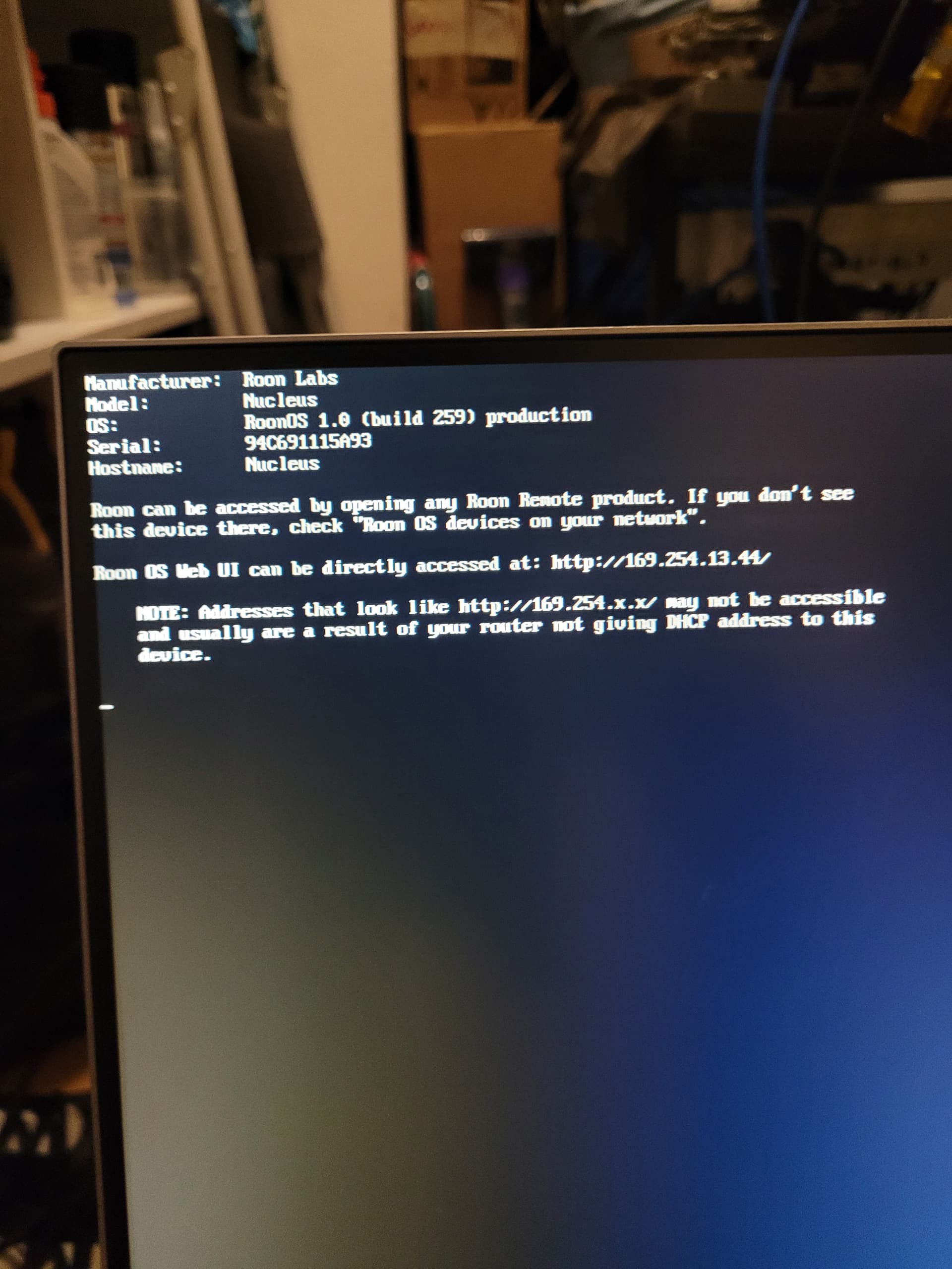

Thanks for reaching out. THe flashing Ethernet lights are a good sign, but it doesn’t necessarily mean that communication is working properly. Please connect the unit to a TV or Monitor and post a screenshot of what you see listed there, thank you!
Thanks all very much. Attached is a pic of what I see. Please let me know.
Thanks @bearFNF I see two ethernet devices,and one has to be the Nucleus as the other is a switch that is visble in the newtork. But no IP addresses there.

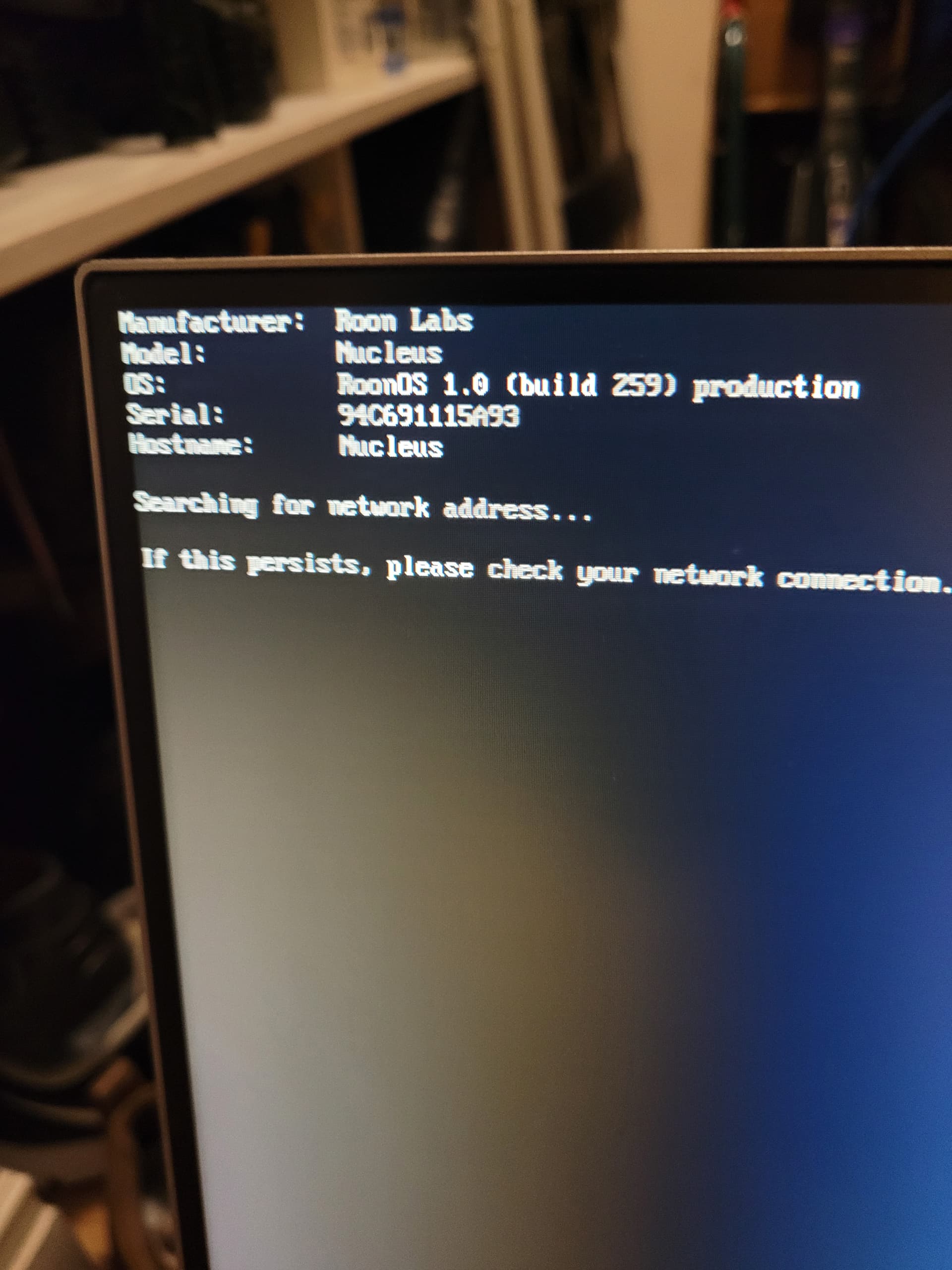

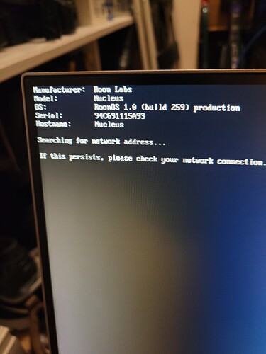

@benjamin I did find a USB keyboard. However, I was not able to connect after typing “resetnetwork”.
Here is a picture of what I am seeing on the monitor connected to Roon now
Also I believe I am seeing the Nucleus now with a 192.168… IP address in the Verizon Router admin app. So it seems like the issue may be that I need to reinstall the Roon OS or something? At least that is what ChatGPT is telling me. I believe I figured out how to do that from here: https://help.roonlabs.com/portal/en/kb/articles/roonos-recovery#Option_1_Windows__Mac_OS__Linux

I did try to reinstall the Roon OS by using the image at the link above and using Balena Etcher to copy the image. However, even after reinstalling the OS on my Nucleus, I got exactly the same message as above.
