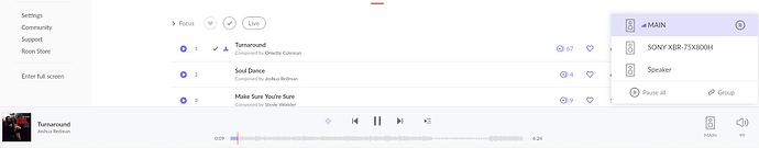

Click on the chain links. If you don’t get a chance to group zones, it’s because only like zones can be grouped.

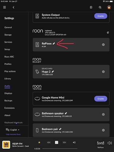

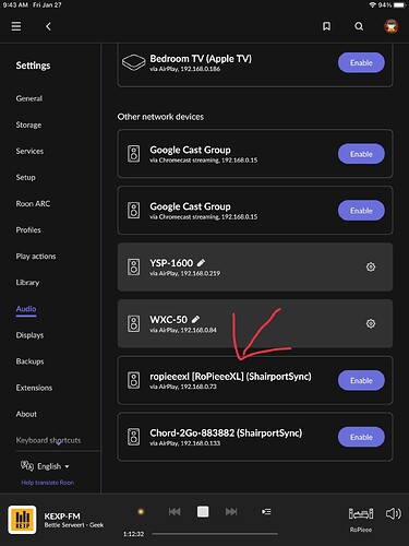

I don’t use Nvidia Shield so this next part is just a guess and may not be applicable to you but if you look in Roon Settings>Audio you may see your audio device can be enabled in different protocols.
In my case I have the Ropiee enabled to use RAAT (via ALSA) but I could enable it to use AirPlay.
You’ll want to have your devices enabled on the same protocol, if possible, if you want to group them.

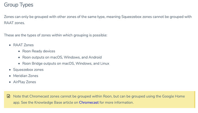

I think you will find that you can group Volumio and you can group Nvidia, but not with each other.
From the link in the post above yours:
