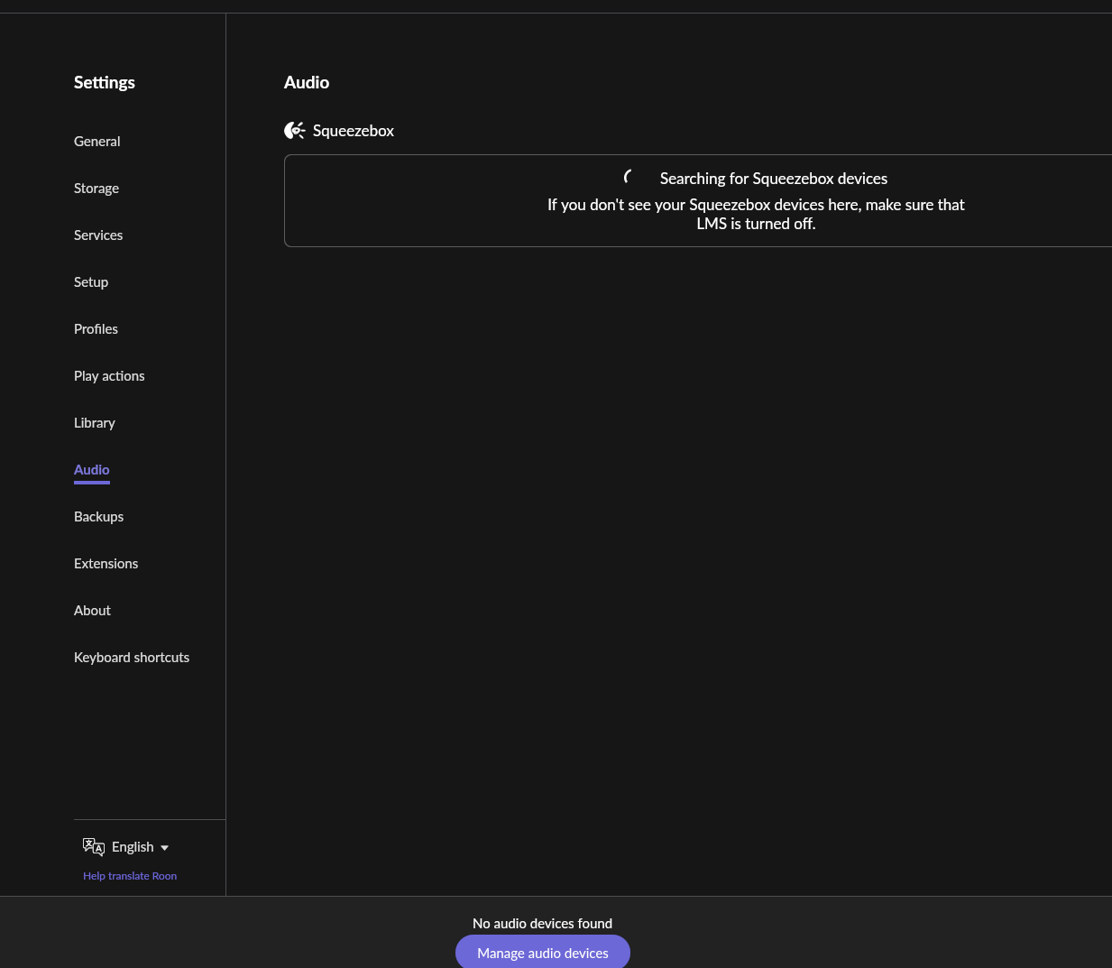

Roon finds and lists my music folder but no music is added.
No devices are being discovered either. Not even the core mac Mini! It used to find all my Sonos, SB and Apple devices no problem.

Hi @Ray_Masters,
In Roon’s Settings, the option “Find Roon OS” looks for devices that are running Roon OS (this is Roon’s operating system, not to be conflated with Roon Core the music application) … typically devices running Roon OS are Roon’s Nucleus and NUC’s running ROCK. I don’t believe you are running either of these on your network hence there is nothing to discover / configure here.
This tells me that the Roon Core is running on your Mac Mini, so that’s not the problem.
I can see that screen shot you posted is just blank. Is there a firewall running on the Mac Mini?
If so as a test try disabling it.
The screen shots you posted suggest Roon Core is running.
When you start the Roon app on the iPad what do you see? Can you post a screen shot.

I have turned off the Firewall.
No change.

So here are the latest screen shots from the moment I open the app on the mini…
