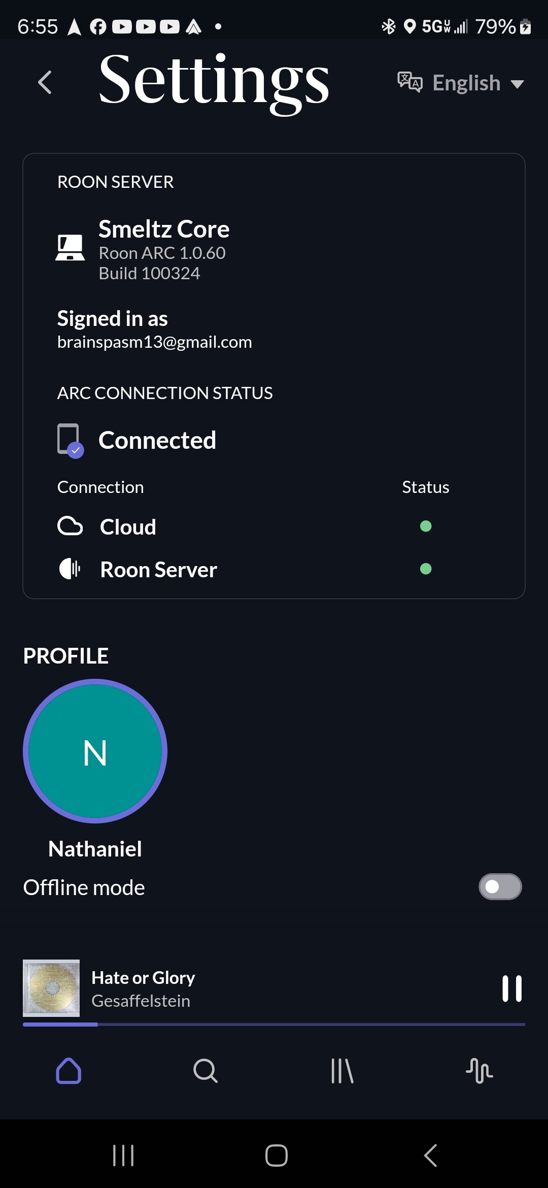

Here is a screenshot I took of Tidal after an unsuccessful playback on ARC, 12/4/24 at 7:58.
I tried to reset my cellular settings as suggested, no dice. I just got a SIM card for my phone today. I haven’t been able to activate it yet. Currently using an eSIM. Not sure if that would make any difference.
I’m wondering if there just something wrong with my phone.
