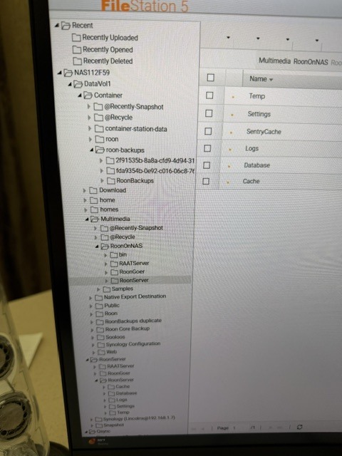

Look at your first screenshot. Inside RoonBackups you have:
  • roon_backup_root
  • 2f91535b-8a8a-cfd9-4d94-3141c020ecd8
  • fda9354b-0e92-c016-06c8-76b804dd178b
  • RoonBackups ← and your third screenshot shows this one has its own roon_backup_root inside it
That’s a backup root nested inside another backup root, and Roon won’t accept it. That’s the InvalidRoot.
Two things follow from this. First, 2f91535b… ,your old library, is already sitting in exactly the right place, right beside the container’s own folder. You got that part right. Second, this location used to work; Roon read the container’s backups from here happily before. So one added item broke it, and removing that item should un-break it.

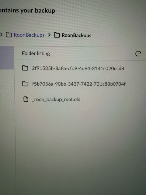

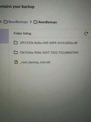

Thank you for your note. In QNAP file station, I went into the inner RoonBackups folder and renamed the file there to roon_backup_root.old, as seen below.
When I select this inner RoonBackups folder, I receive the message, “No backups found. Please check your backup location.” If I choose the RoonBackups folder containing the inner one, I see a list of backups from July 15 to August 13. I had turned off automatic backups.

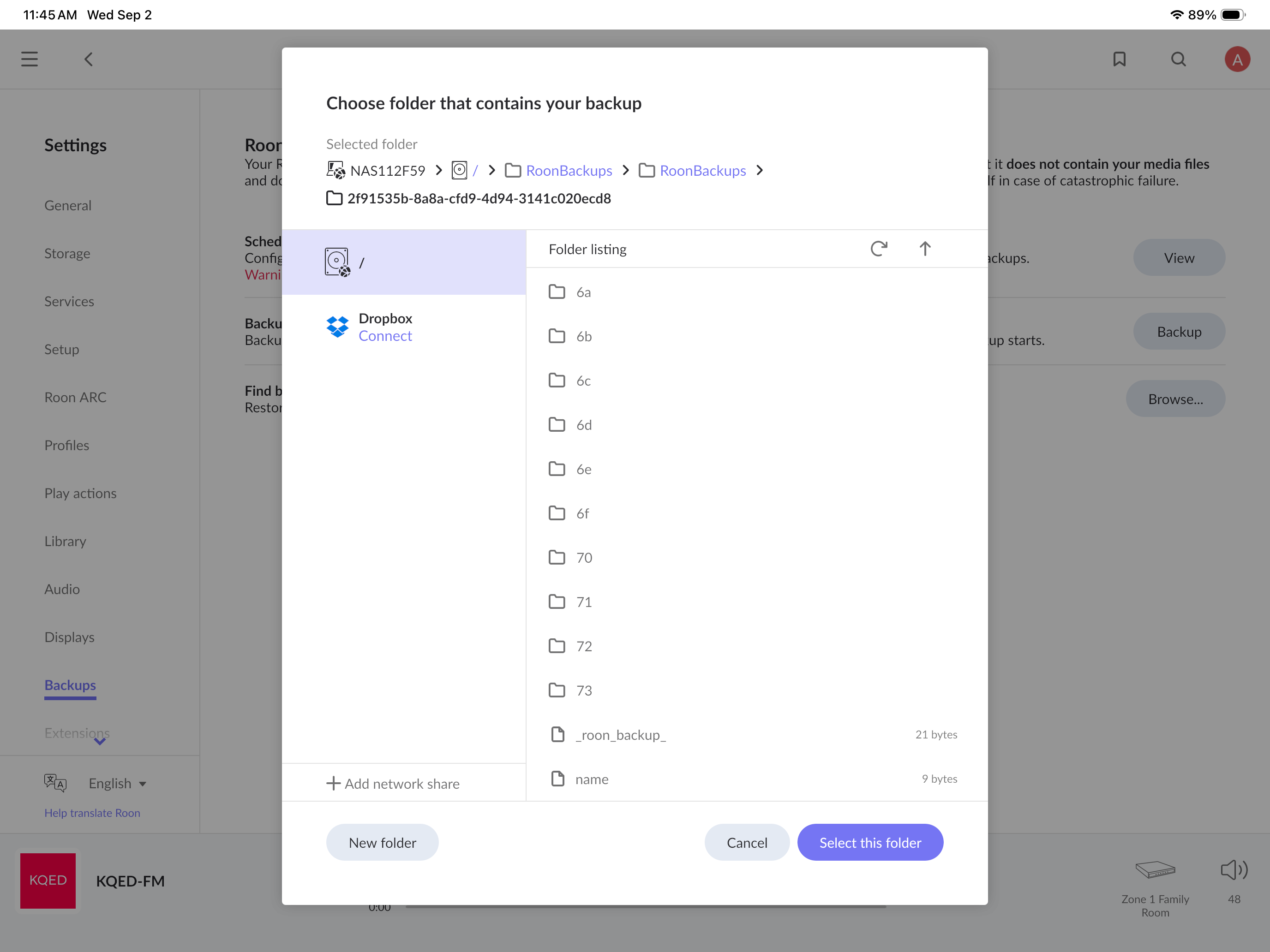

Thank you for your note. Using my Windows PC, I copied the Synology roon_backup file into the same-named folder on the QNAP.
Unfortunately, I received the message, “No backups found.” The file I copied is only 21 bytes. I’m thinking I copied the incorrect file. Please let me know.
You asked what I see in 2f9153. Below is a photo.

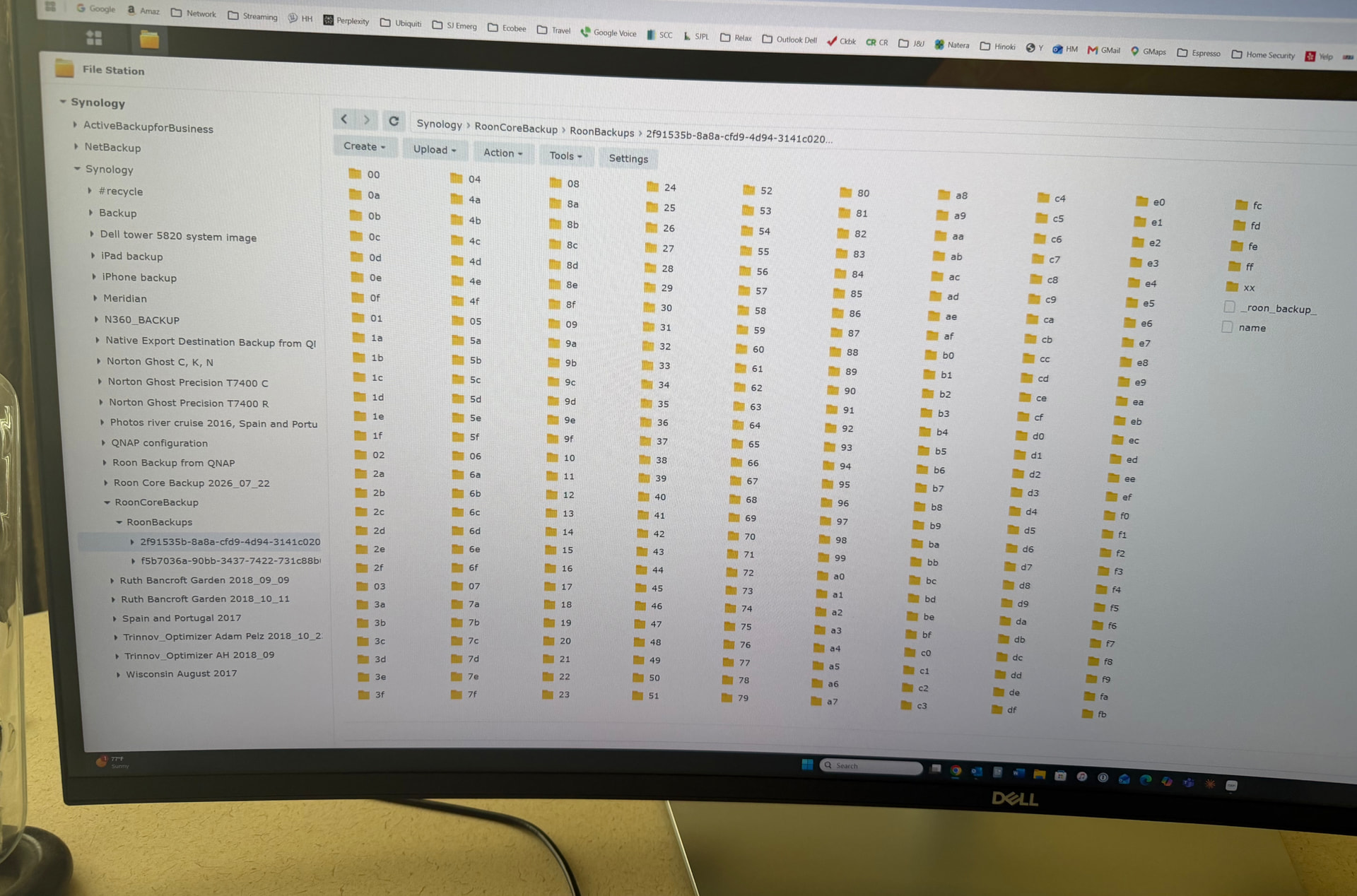

Thanks for the photo @Alan_C! That’s exactly what we needed, and it explains the failure.
Good news first: the 21-byte file is the correct one. roon_backup is just a tiny marker file, and 21 bytes is what it should be. You copied the right thing.
The actual problem is that the folder copy never finished. Compare your two screenshots:
  • On the Synology, 2f91535b-8a8a-cfd9-4d94-3141c020ecd8 contains folders 00 through ff, plus xx, 257 folders in total.
  • On the QNAP, that same folder ends at 73. Everything from 74 to ff is missing.
So roughly half the backup data never made it across. That’s the same failure as the File Station “Failed to access the file” error from a couple of weeks ago, the transfer starts, then quietly stops. Roon sees the marker file, looks for the data, and reports “No backups found.”
Two things also worth correcting: in your screenshot, the selected folder is 2f91535b-8a8a-cfd9… itself. Find backups needs the folder above that , the one holding roon_backup_root. And that nested RoonBackups inside RoonBackups is what caused the earlier InvalidRoot error, which is why we asked you to rename the marker. Both of those go away with the approach below.

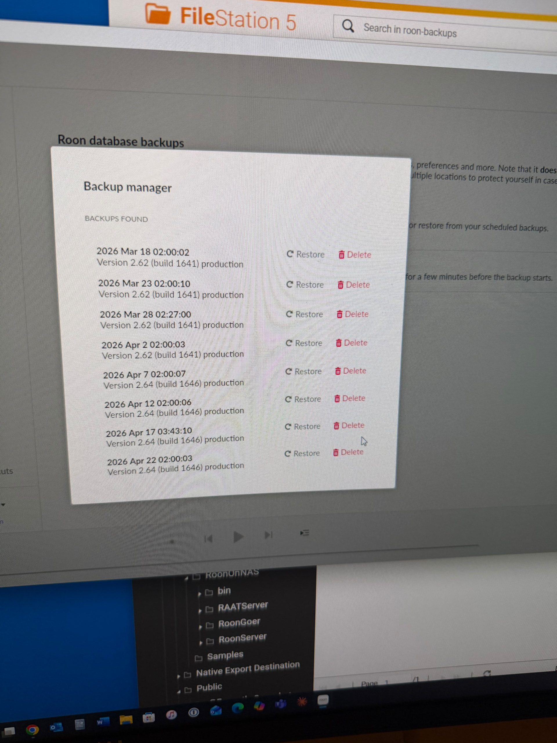

I was not successful going the PC route. However, it looks like I was successful compressing the Synology RoonBackups folder, copying it to the roon-backups folder in the QNAP container, and unzipping it there.
I don’t see the 04/27/2026 backup, but I think 04/22 is close enough for me. Shall I select the 04/22 backup in the Roon app under Settings/Backups/Find backups?

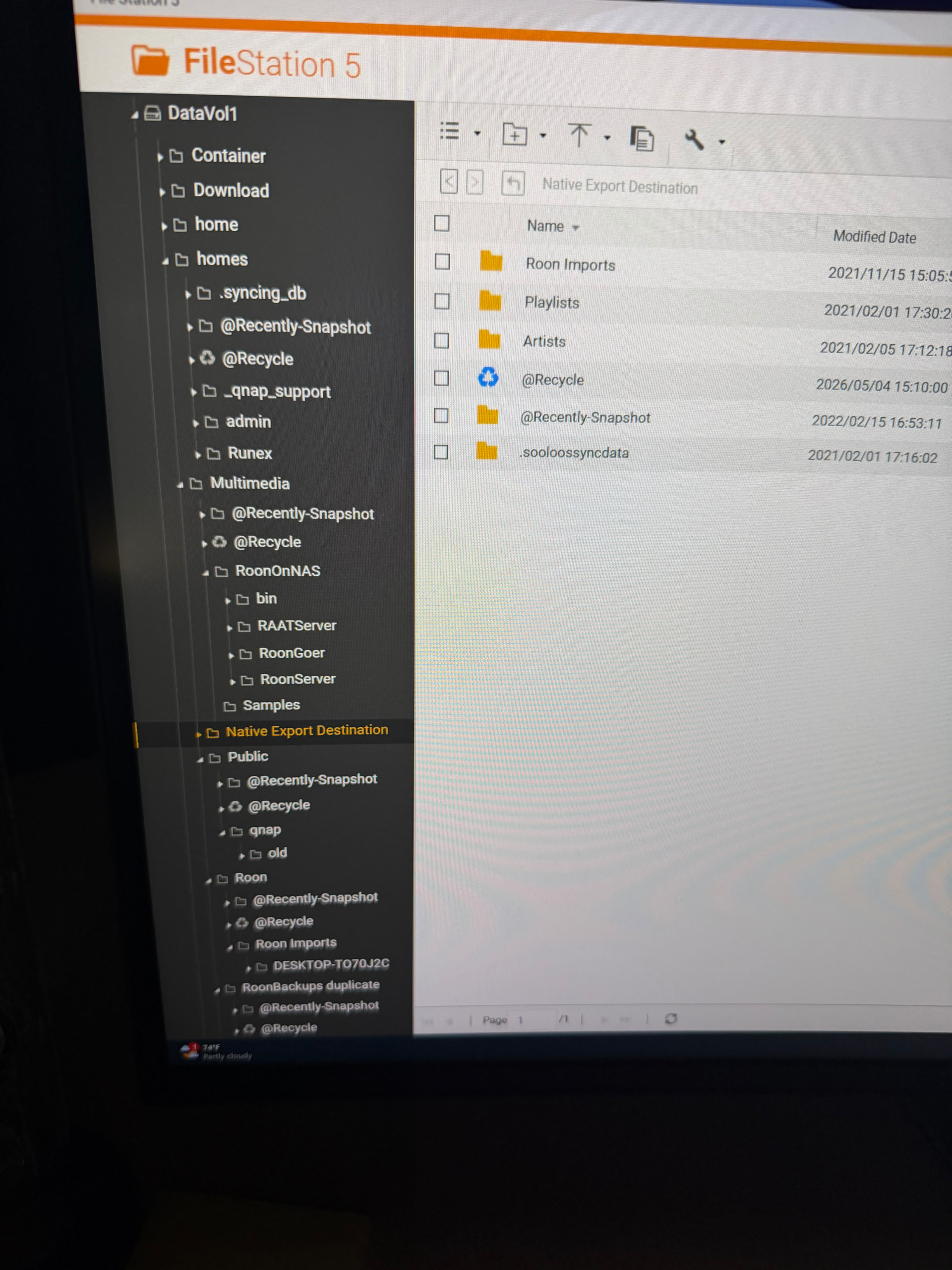

One other thing. The QNAP has a Native Export Destination folder (screen shot below), although the folder modification dates for Artists and Playlists are from 2021. (The folder below those two, Roon imports, contains only a couple of files, also from 2021.)
The Native Export Destination folder on the Synology NAS contains the same 3 folders with modification dates of 2021.
Thank you!
