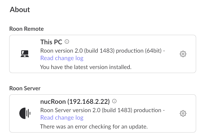

Hardware: NUC5i5RHYH (5th gen i5 processor) - runs the roonserver
Hardware: Asus GL752GW, laptop, windows-11 - runs my Roon client
Software nuc: Roonserver (nuc/linux) 2.0 build 1413
Software nuc: Ubuntu 20.04.5 LTS (Focal Fossa)

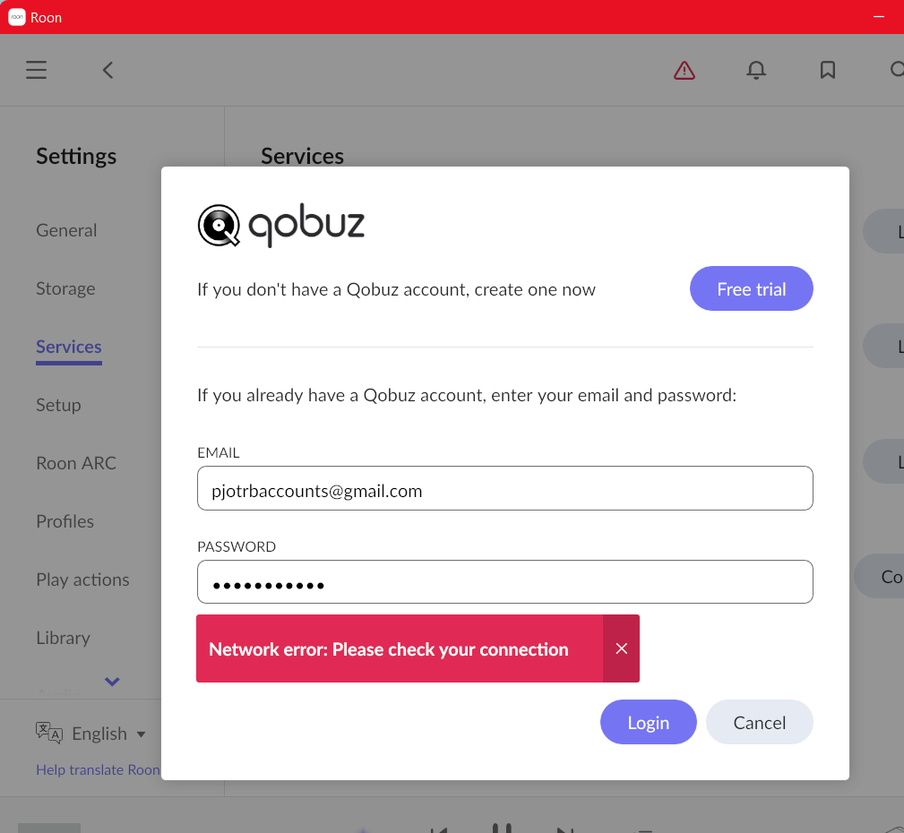

Thanks for the reply, but no, it did not work.
I changed the DNS servers in my Fritzbox router to the google dns servers 2001:4860:4860::8888 and 2001:4860:4860::8844 but the issue remains the same:
“Network error: Please check your connection.”

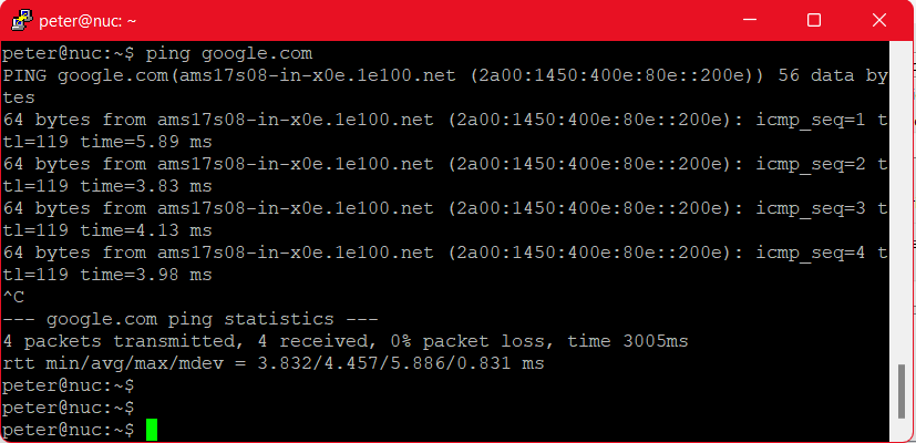

Can you access https://www.qobuz.com or the mentioned ip-address from another machine in your network? Just to see if it is a problem only with the machine running Roon Server.
And did you also change the DNS server for IPv4?

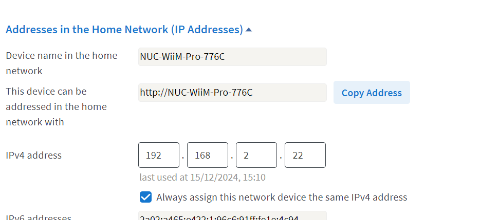

Thanks for the reply.

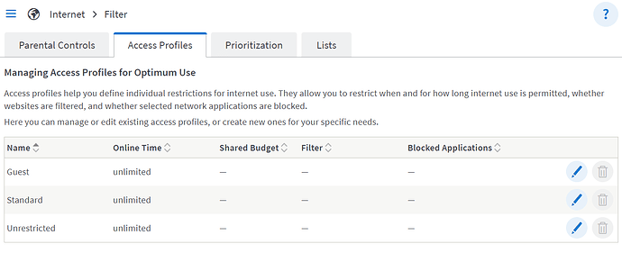

I found the “Internet > Filters > Access Profiles” option where the access profiles “Guest” and “Standard” both have a “Filter websites” option. Only the Guest option was enabled (but contained an empty website list). Still I disabled it to be sure and restarted the router.

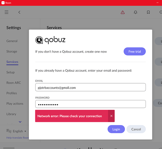

No change, still showing when trying to sign into the Qobuz service: Network error:Please check your connection
My qobuz app works fine, also when changing the router back to the ZTE the qobuz service works fine, so there is no problem with qobuz itself.
As for IPv4, I have activated this and set the DSN servers to 8888 and 8844. And restarted the router.

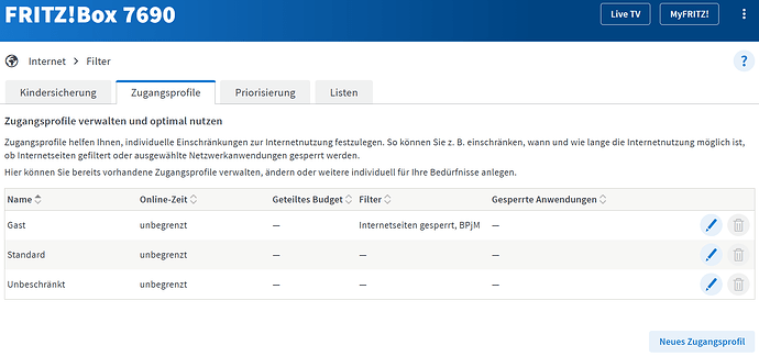

Here are my default (standard) settings for 7690:
Don’t know if it can be of any help
Torben

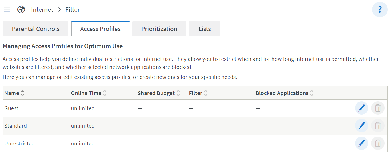

This is my setting, no filters at all :frowning:

It appears that Roon Server can’t reach the internet. Did you check if you can access the internet from your Ubuntu server? For instance using ping or wget or curl?
With the change from ZTE to Fritz I assume your home network has changed slightly.
Can you confirm you are using DHCP for all devices (no static network settings for IP address, network mask and gateway on any device)? DNS needs to point to the Fritz router too.
Also, Fritz reserves LAN4 port for guest network by default. Checked that?
Just checked, no problem pinging nu.nl or google.com:

Checked some stuff after reading your suggestions.
  1. Set the Fritzbox DNS settings back to the recommended settings.
  2. Somewhere I actived checkbox that allows Guest to use LAN4.
    however, in the frizbox overview page only lan1,2,3 are shown. Dont know if that is correct.
  3. When logged in as user on my NUC (where the roonserver runs), I found that I cannot ping to 104.22.14.70 (seems to be a roon IP, see logfile below). When I do the ping from the windows laptop it works. So this seems to be the issue!
  4. Do you mean static ip’s are not allowed? See screenshot, my NUC has a static IP.

If the Fritz router runs pretty much to its default settings I would expect
A) the router to be 192.168.178.1 (subnet mask 255.255.255.0 and gateway(!) 192.168.178.1 too)
B) this means your network devices (when using static IP settings) have to adjust: IP such as 192.168.178.x (x=2-254), subnet mask 255.255.255.0, standard gateway 192.168.178.1 (or whatever IP the Fritz router has)
If the ZTE router had a different IP and subnet than the Fritz, and you did not adjust the NUC’s network settings your problems make sense.
Best option: Don’t do static IP settings. Run DHCP for all network devices and make DHCP reservations if you want one device (like the NUC) to keep the same internal address forever.
Many thanks Bernd_Kurte!
It seems like the fact that my IP range was indeed not matching with the Fritzbox defaults.
Changing to the 192.168.178 range solves the probem!
Not sure if I have addressed every aspect of this issue, but for now everything seems to work correctly.
This issue can be closed.
