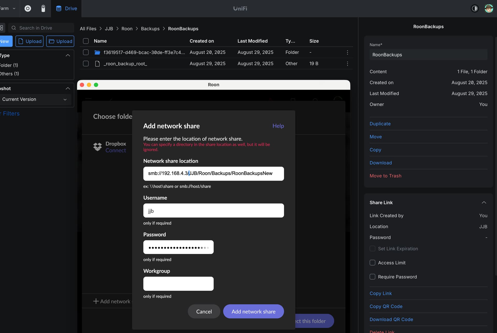

The first screenshot shows the Roon Backup page on top of the Unifi NAS page showing the folder path where I want the backup to go, and the second shows that the smb://192.168.4.3 is (hopefully) correct.
In the Roon NAS Troubleshooting Guide it suggests removing any special characters from username passwords, but the Unifi NAS UI won’t let me do that - there are a couple of “@” & “!” in the password that I can’t delete.
Any idea where I might be going wrong?

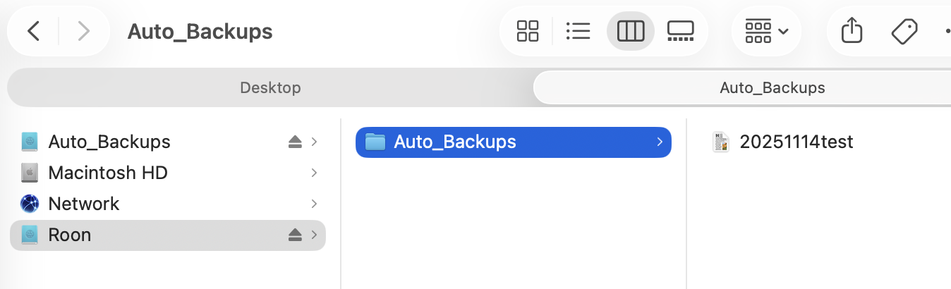

In order not to complicate things with my admin user and password (which to be honest I didn’t really want to “share” with the Roon software :zany_face:, I have created another “root” folder on the NAS called Roon, and created a sub folder called Auto_Backups ; I put a temporary textedit file inside called 20251114test. I created a new User with its own username called roon & a new password.
When I type smb://192.168.4.3/Roon/Auto_Backups in to a browser it now opens up a browser window and shows the textedit file after prompting me for the username & password. All good so far.

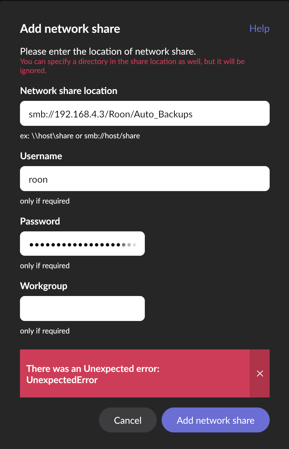

But if I put the same smb://192.168.4.3/Roon/Auto_Backups in to the Roon backup Network Share Location, along with the correct username & password, it comes back with an Unexpected Error error.
So … the NAS can see the folder, the MacBook can see the folder within Finder, Roon can see the NAS too play stored music, but it doesn’t want to put a backup on a network share …
I’m confused!

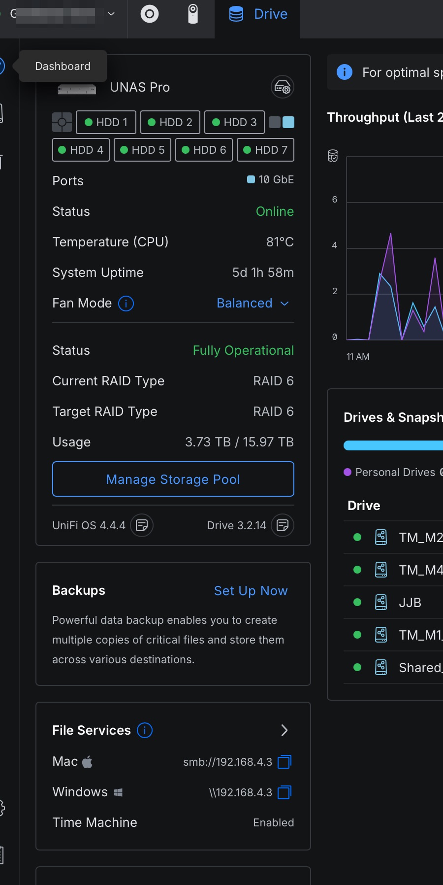

Can you send me a screenshot of the SMB protocol settings for the NAS server? Is there such a thing as smbv1, smbv2, smbv3?

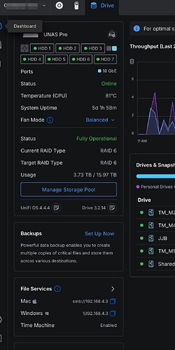

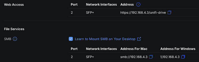

Is this what you mean?
There isn’t much information!
And in terms of shared files, are there any specific settings?

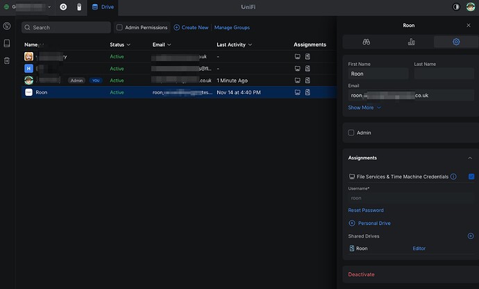

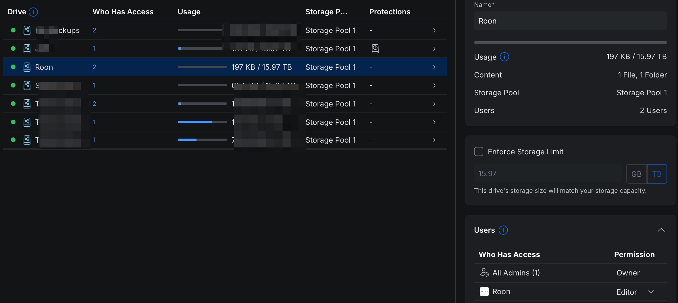

This is the Admins & Users page of the NAS control Panel, with some details redacted. It shows the Roon user that I created for the Roon automated backups
This shows who has access to the Roon folder, ie me as Admin, and Roon, a user I created specifically for the automated backup routine.

Can you increase the permissions (from editor to administrator) for testing purposes?
Regarding sharing the music library, you need more rights. That’s all I can think of!
