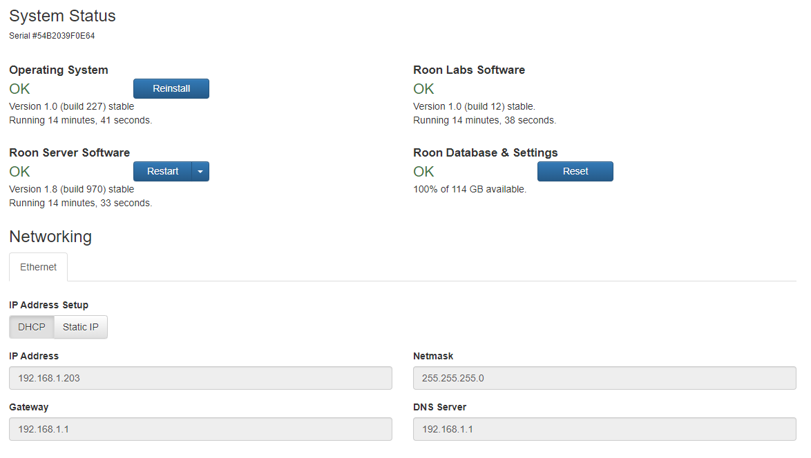

If I click on the link at the bottom to configure RoonOS, I get this. So it sees it no problem as far as actually seeing the Nucleus. Notice that this is showing the red dot, so even though it sees it, it can’t connect
All of the network setting appear to be fine.

Laptop IP settings and Nucleus settings.
Does your managed switch pass multicast and broadcast traffic? Is flow control set? By simplifying things, you can eliminate issues.
I allow it to pass everything. Not really using any of the manage features. I have the Roon on the same switch as my Synology NAS.
