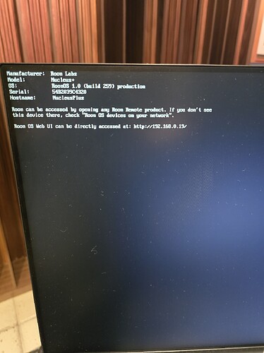

  1. connect the keyboard and external display via HDMI to your Nucleus
  2. turn the nucleus on
  3. when it boots up → press Enter → enter “resetnetwork” → hit Enter
  4. Try to connect again from your devices
Also, if you have any network complication (like network switches) we’d recommend to remove them for test purpose and try to connect again to the nucleus and confirm that the remote has the same IP range as the Nucleus (i. e. first 3 octets should be the same - 192.168.0.xxx).
Let us know please whether it is working for your nucleus.
Regards.

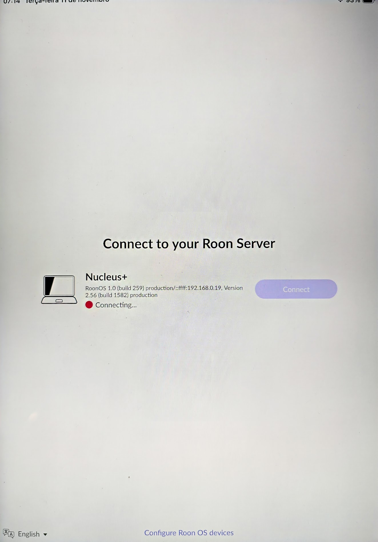

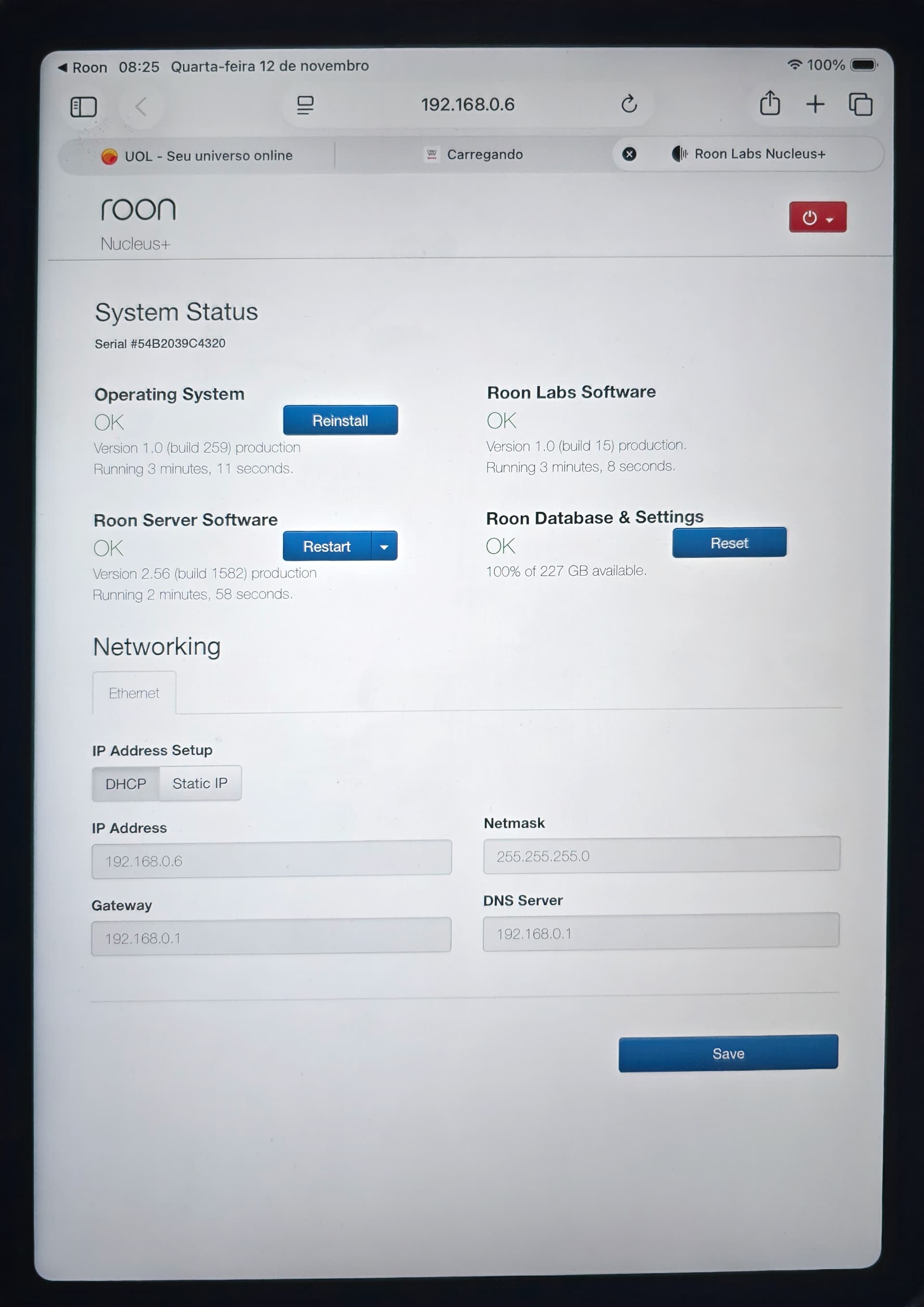

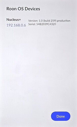

Hi, thanks for your quick return.

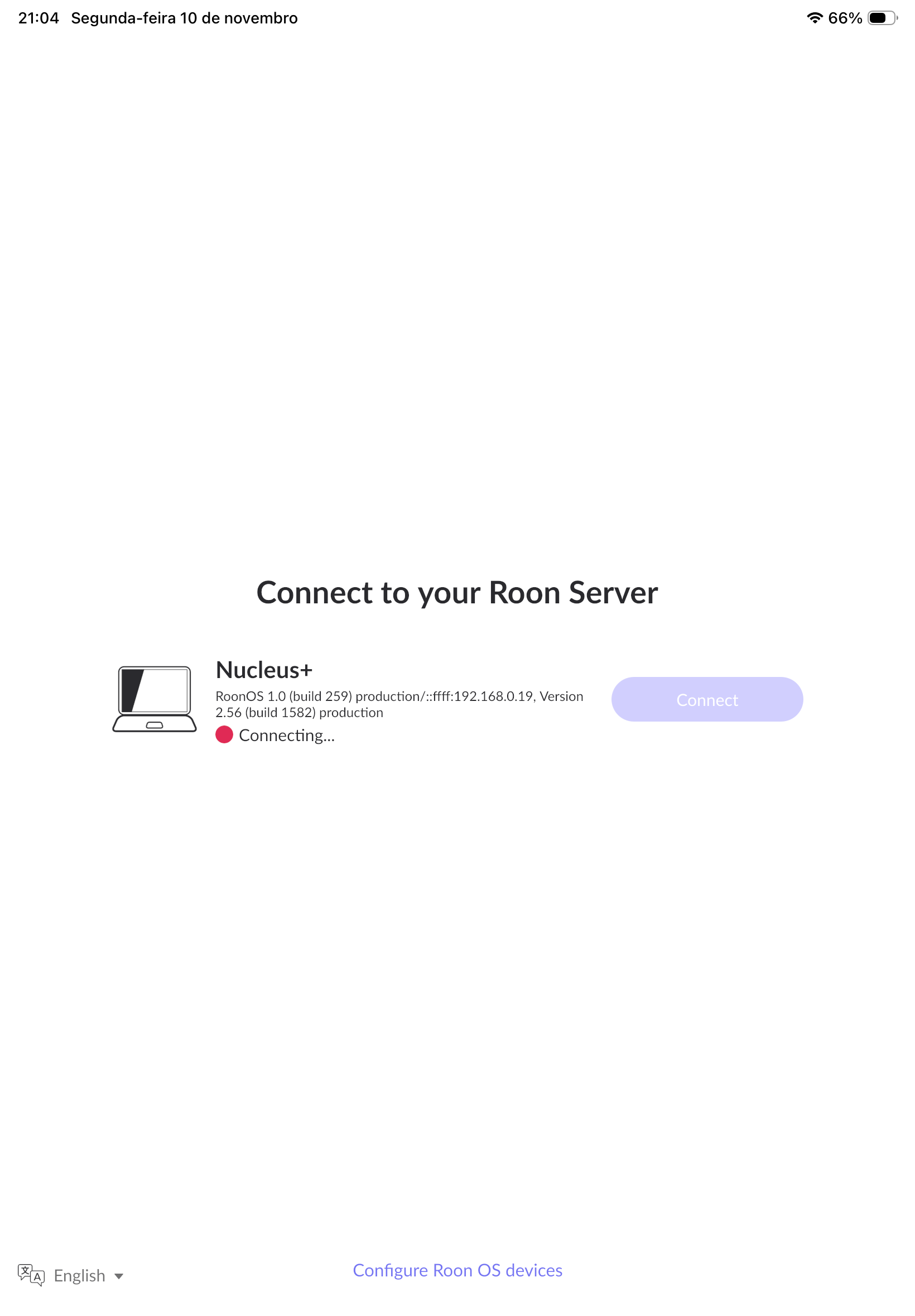

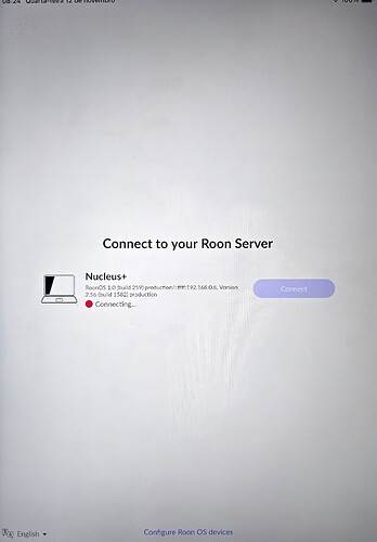

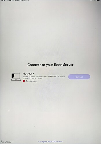

I did everything you told me to do, some pictures are attached.
I did the resetnetwork, then connected the nucleus directly to the router, without the switch.
But it’s still the same, it’s not a network problem, it seems that my nucleus can not load any of my info anymore.
Is there anything else I can do?
Regards,
Theophilo
![PIC2|376x500](upload://qwzjTjEfwPPB4ewD1Q7kNalxur5.jpeg) ![PIC3|349x500](upload://nSNWc48EQq3MRmZPJQywH3oIU8q.jpeg) ![PIC4|374x500](upload://nsSQPEFqv2hU6bWFUobugKQKZSV.jpeg) ![PIC1|374x500](upload://4T2F6aiDjXHtUGUOFViIFmC0zwt.jpeg)

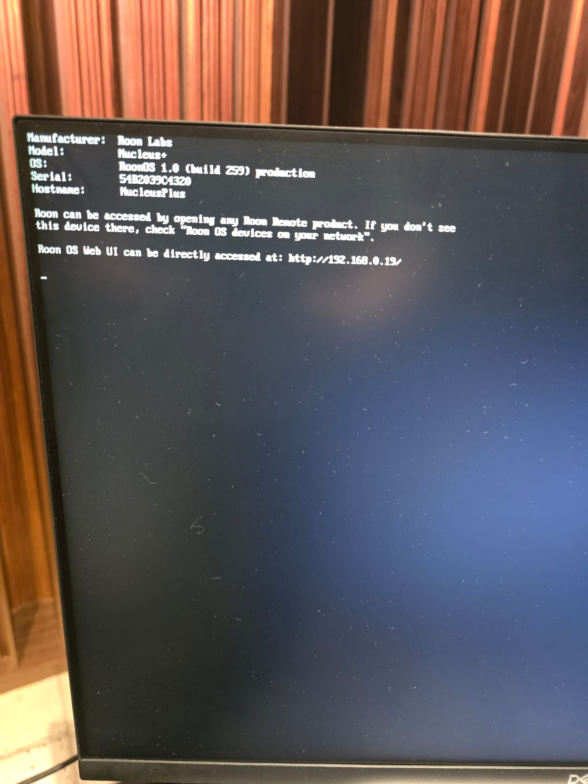

Hi, I’ve already connected via WebUI and reset and reisntalled everything there. The problem persists. Now I’ve connected Nucleus with TV and keyboard but need your help from there.

Thanks, but I’ve already did that and did it again now, but it didn’t connect.

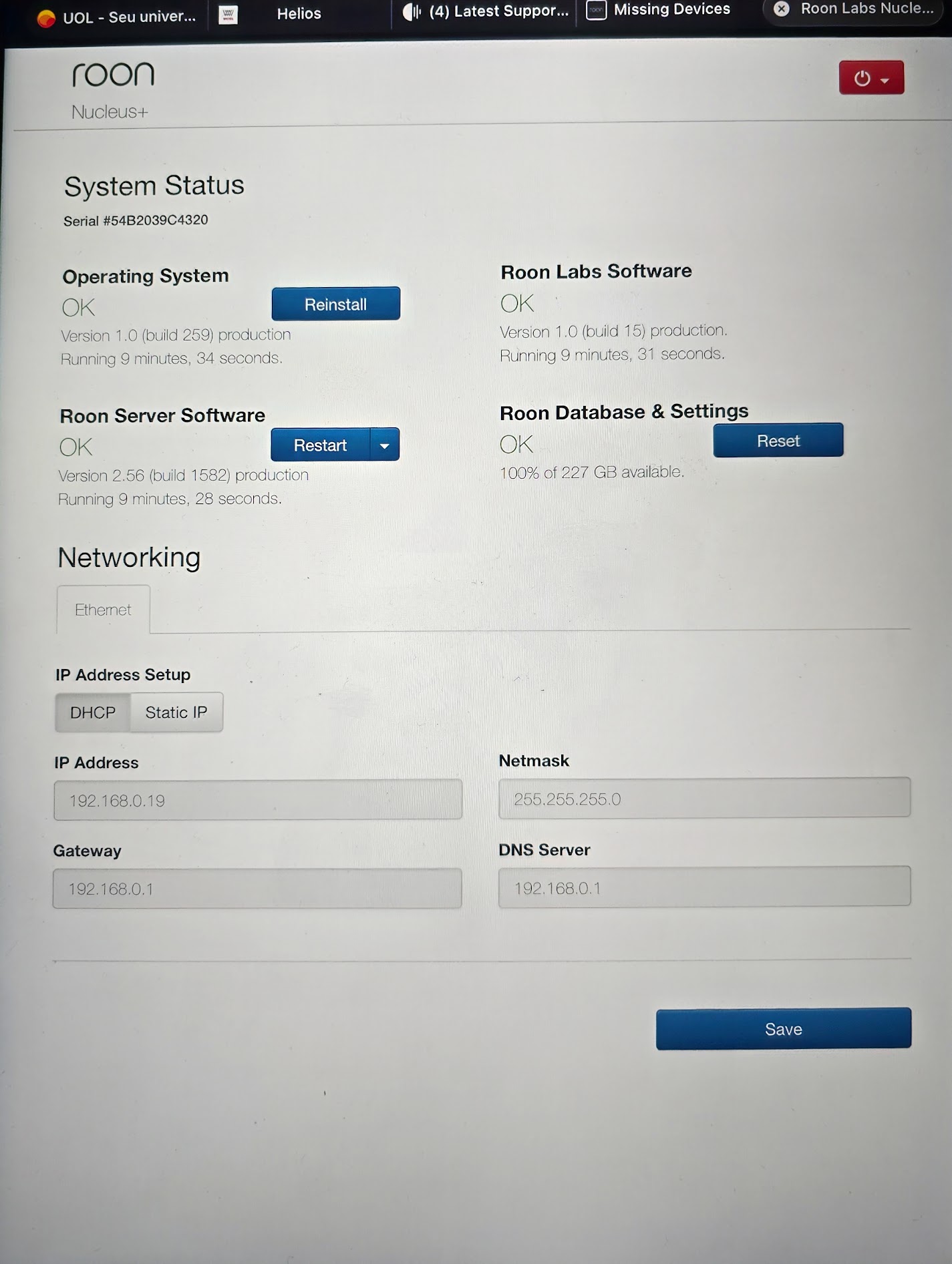

Hi, I did exactly what you asked me to. I’ve connected the Nucleus directly to my network, bypassing the switch. The same, it connected, WebUI ok, but could not access any of my files, neither Tidal nor Qobuz. Is there anything else I can do to make my Nucleus work again?
Thank you.

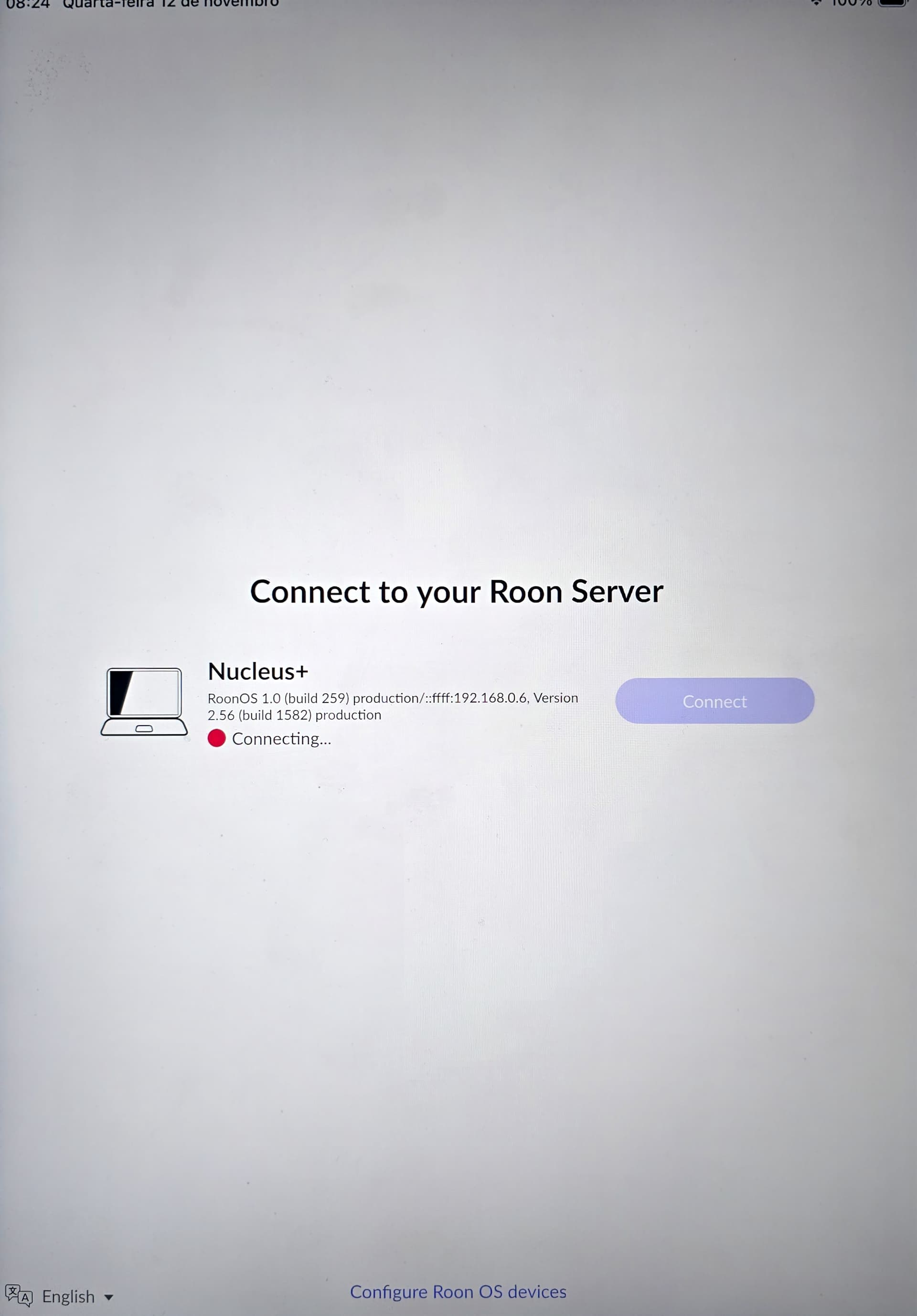

Hi, I am still unable to connect. Screenhots attached.
