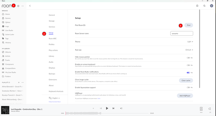

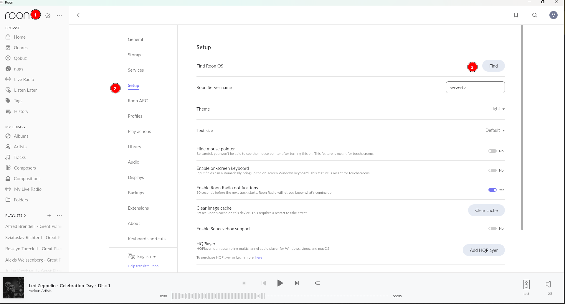

The easiest and most reliable way to bypass this and connect to your internal drive is to use the Nucleus’s direct IP address in the Cmd + K menu. You can easily find this IP address using the exact steps highlighted in the second screenshot you provided:
  1. Open Roon and click the Settings gear icon (marked as 1).
  2. Navigate to the Setup tab (marked as 2).
  3. Click the Find button next to Find Roon OS (marked as 3). This will open a pop up showing your Nucleus’s IP address.
