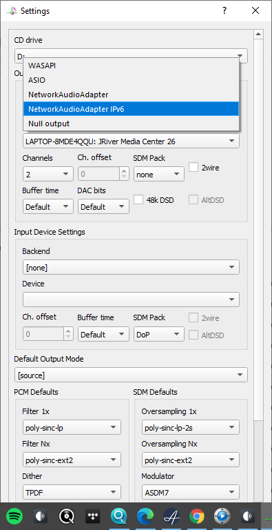

When I start HQPlayer desktop this is what I see in my settings, some examples below
Which setting should I use, is it one of the Networkadaptors given I don’t have NAA inbuilt on either my SA30 amp or Chord 2Go? If so what should I select as my Device?

What device are you running the networkaudiod (NAA) program on ? If it is the same computer as HQPlayer then I have confused you.
The NAA program is intended to be run on a network device that is connected to your network and to your DAC, not on the same computer as HQPlayer.
Neither your amp or Chord have NAA built in, so you either have to get a network device that can run NAA or connect one of your amp or DAC directly to your computer.
See this article in the Roon Knowledge Base about setting up an HQ Player Zone in Roon.
The HQPlayer manual was unpacked into the HQPlayer directory when you installed HQPlayer. Have a read of it, particularly the sections relating to Backend and Audio Device.
In short:
  • if you want to send output from HQPlayer to a network device running NAA then choose NAA as Backend and you should see the device as a selection under Audio Device. If it is your only NAA device then it will be the only entry;
  • if you want to send output from HQPlayer to a DAC or other Audio Device which is directly connected to your computer by USB then choose ASIO as Backend and select the DAC or other device from the list of available Audio Devices. Note that your DAC may need to be on with the USB input selected for it to show up.
