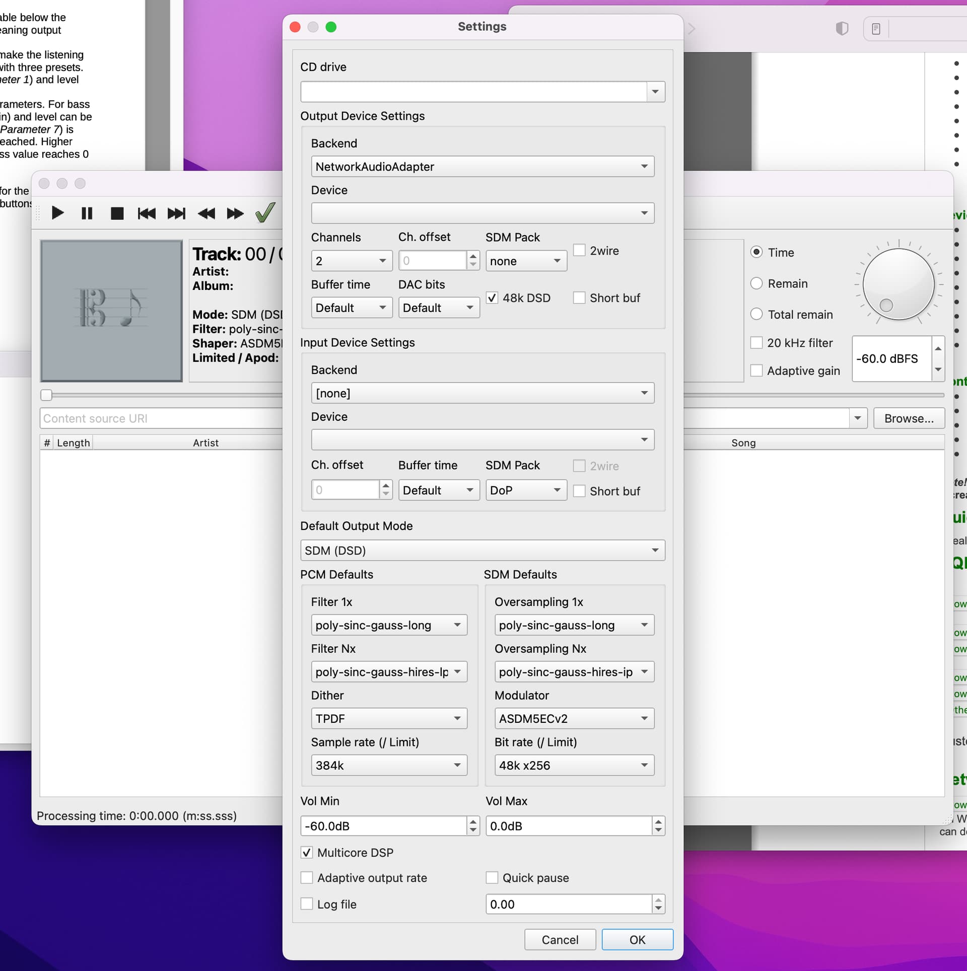

I’ve just got a Mac mini M1 and an Up Gateway endpoint running the NAA binary to drive my Holo Spring 2. The Mac mini is up, the Up Gateway shows up on the network and can be pinged. but I can’t seem to HQPlayer Desktop to the endpoint. I choose NetworkAudioAdapter on Output Device Settings, but I’m not allowed to select anything for Device. The Mac mini and the Up Gateway are on the same UniFi switch. Desktop is in demo mode, as I wanted to check that everything works before buying the license. Am I missing something?

Thanks, but that seems to be for the input side, what I’m not getting is the output side. In any case, toggling that does not allow me to configure the output NAA endpoint.
It’s for output but if it isn’t doing anything I can’t figure what could be the issue.
Can you share a screenshot of what you see?

Tried IPv6, no difference. I’m not allowed to enter anything in the Device field.
