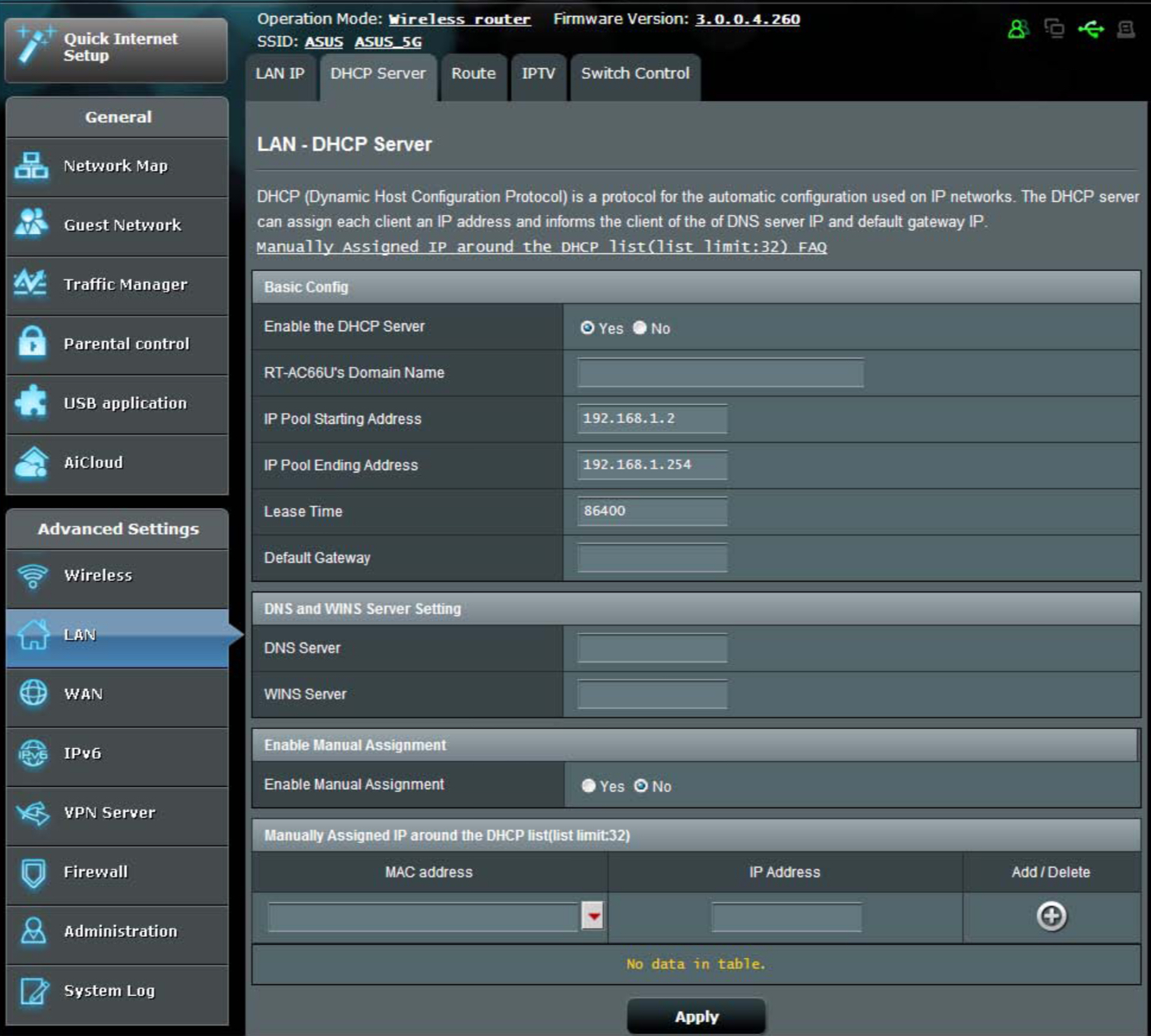

It’s all right here at the bottom of the screen:
Any problems you are having manually assigning an IP address to your NAD fall squarely on Asus’ shoulders and no one else’s.
The NAD has no way of knowing it is being assigned the same IP address by the DHCP server. This has nothing to do with Roon.
I would say ā€œmanually reserving an IP addressā€. Otherwise, you might get the idea you can set an IP on the NAD itself.
@Rugby
Look at the actual words used by Asus on the screen! You are manually assigning the address the DHCP server hands out to a particular MAC address.
Can you supply a screen shot ala SpeedRacer’s, showing the static IP config in your router.
