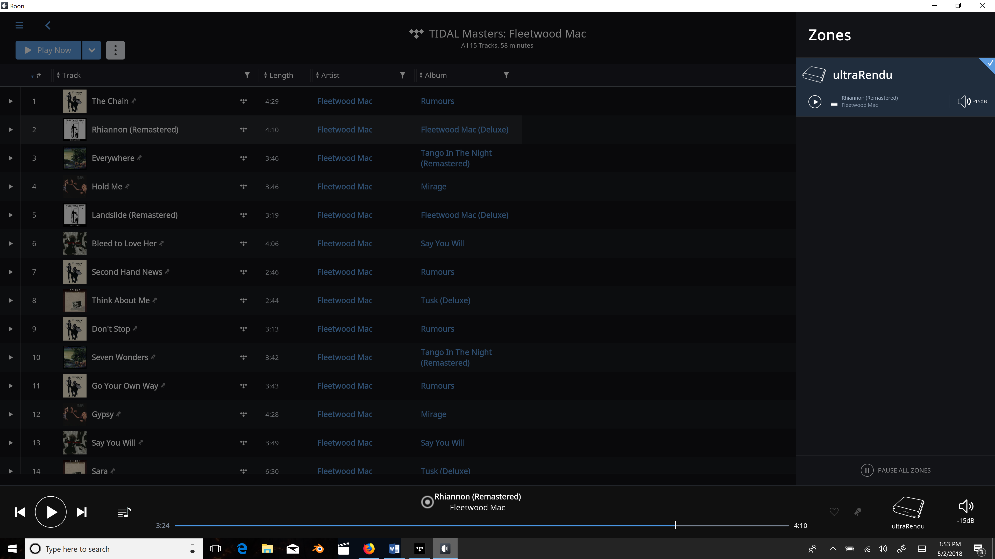

Hello @George_Zimmermann,
Can you confirm for me that when you click on the zone picker, which is the button that is located to the left of the volume reading on the bottom of the display, that “ultraRendu” is selected, and not “System Output”?
-John
yes it is:
george

Hi John!
my brief love affair with playing MQA files was short-lived.
I downloaded the new version of Roon on my Ipad Pro and Yes i do now show MQA files (hurray!!) and i also downloaded the new version of Tidal on both Surface and IpadPro
BUT now using either the iPad Pro or the Surface Pro
i am back to not getting the Mytek to light up and play/decode MQA files…both controllers (Surface and IPAD) still seem to have all the same settings that we had before
but not neither surface Pro or Ipad Pro get the Mytek to play MQA files
help (again)
sorry…
george
Go to the “Device Setup” screen for your ultraRendu, and make sure that “MQA capabilities” is set to “Decoder and Renderer”.
-John
bingo!!!
MQA decoding again using either controller
thanks again…time to immerse into the music
george
