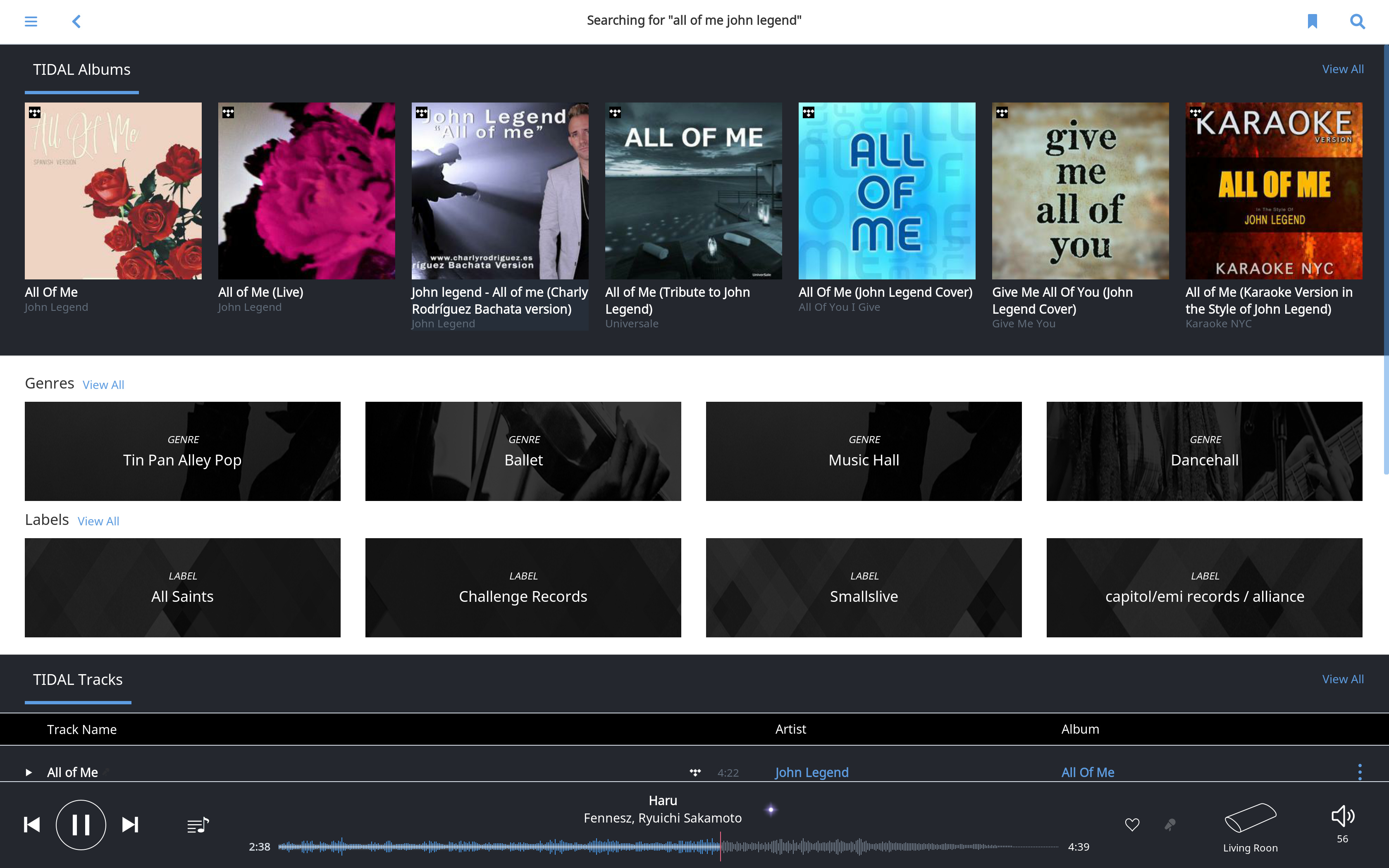

I searched for “all of me john legend” and got the following, with All of Me (the album) and All of Me (the track) as first result in their respective Tidal listings:

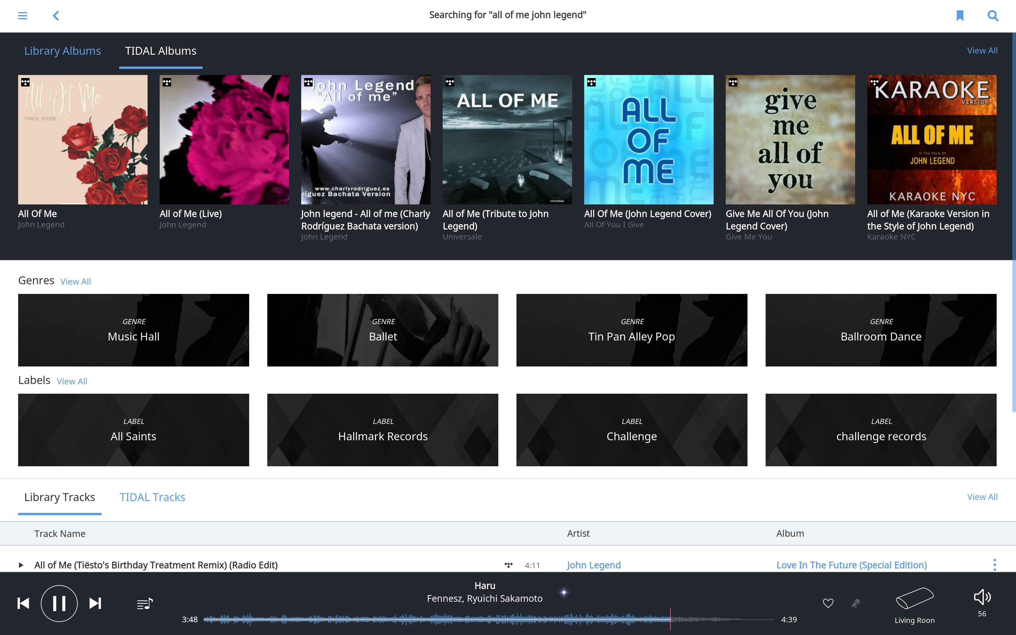

Note that this is without John Legend in my local library. When I add one of his albums, Roon presents the local Library results first:
Click on Tidal Albums and Tidal Tracks (right next to Library Albums and Library Tracks) to see the non-local Tidal results:

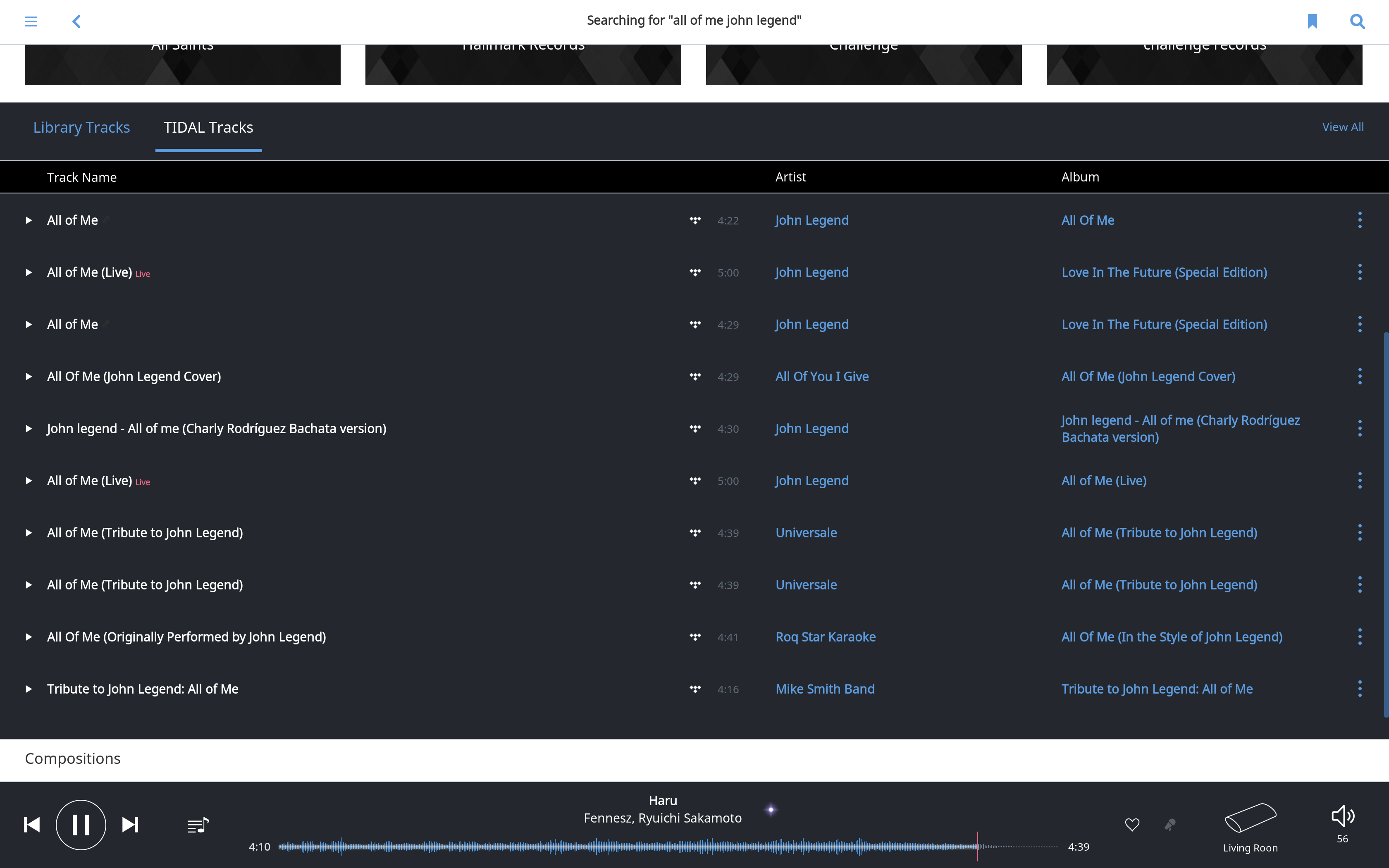

The first three Tidal tracks all seem relevant:

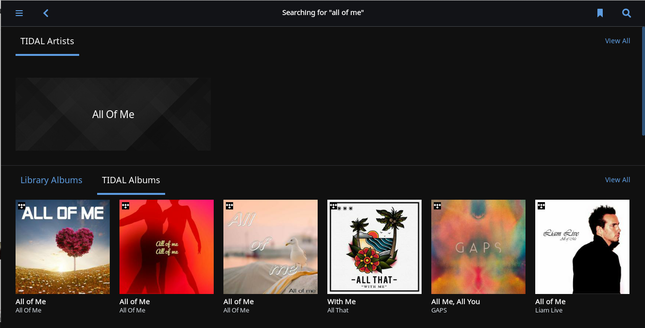

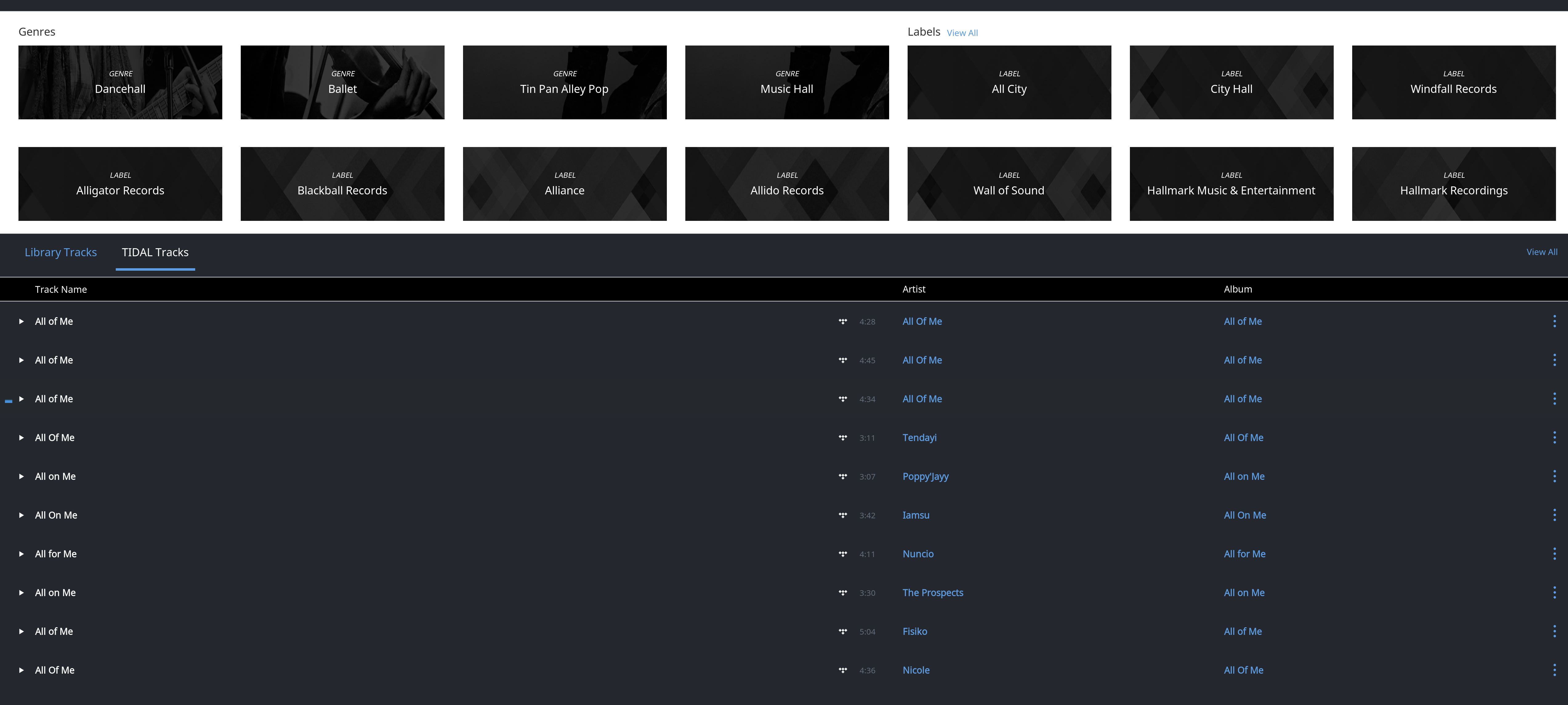

This is what I get when I search “all of me”:
When I search “all of me John Legend”:

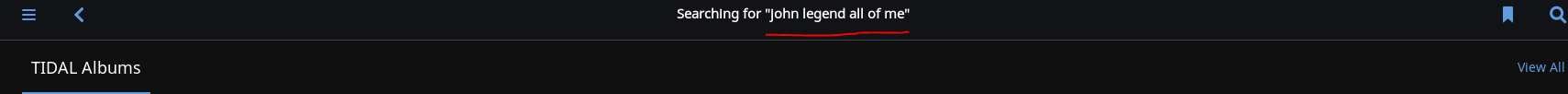

When I changed the search around:
I get the correct song in the track list, as shown circled:
