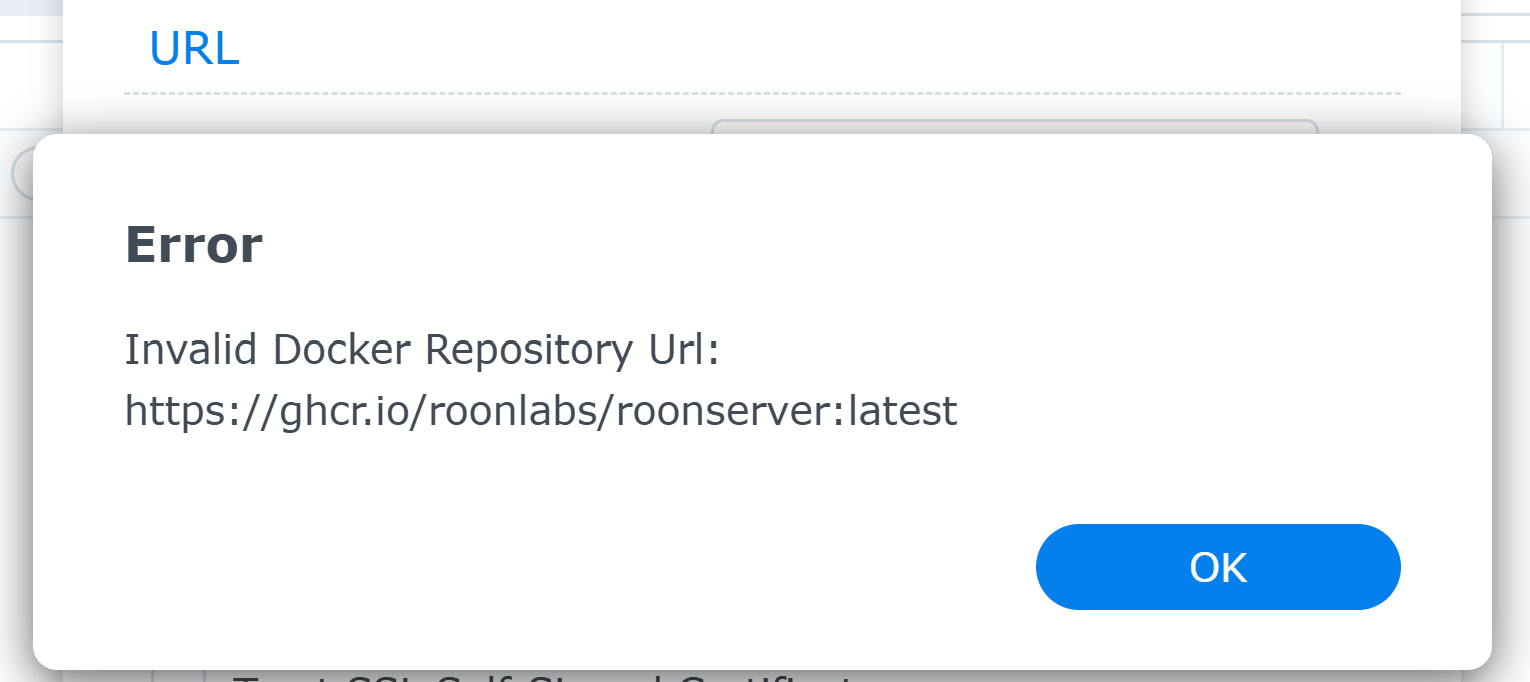

Can't install on Synology docker, invalid URL!
I get this error msg, what is the correct URL?
Can you try again, but without https://?
I’m receiving the same error message even after deleting the https://
Same problem!!! Invalid url

Update your Synology to 7.2 or 7.3, it will work fine.

@Twista_XP & @Zhang_Minxiang I’ve found some people can’t upgrade because the device is too old. If you use the docker-compose approach it seems to download the image just fine. I’m trying to get my hands on a synology from someone in my local community to better understand the UI workflow.
There is a manual update option for old devices like mine (DS918+). I did it manually.
They can download the firmware from Synology official website.
