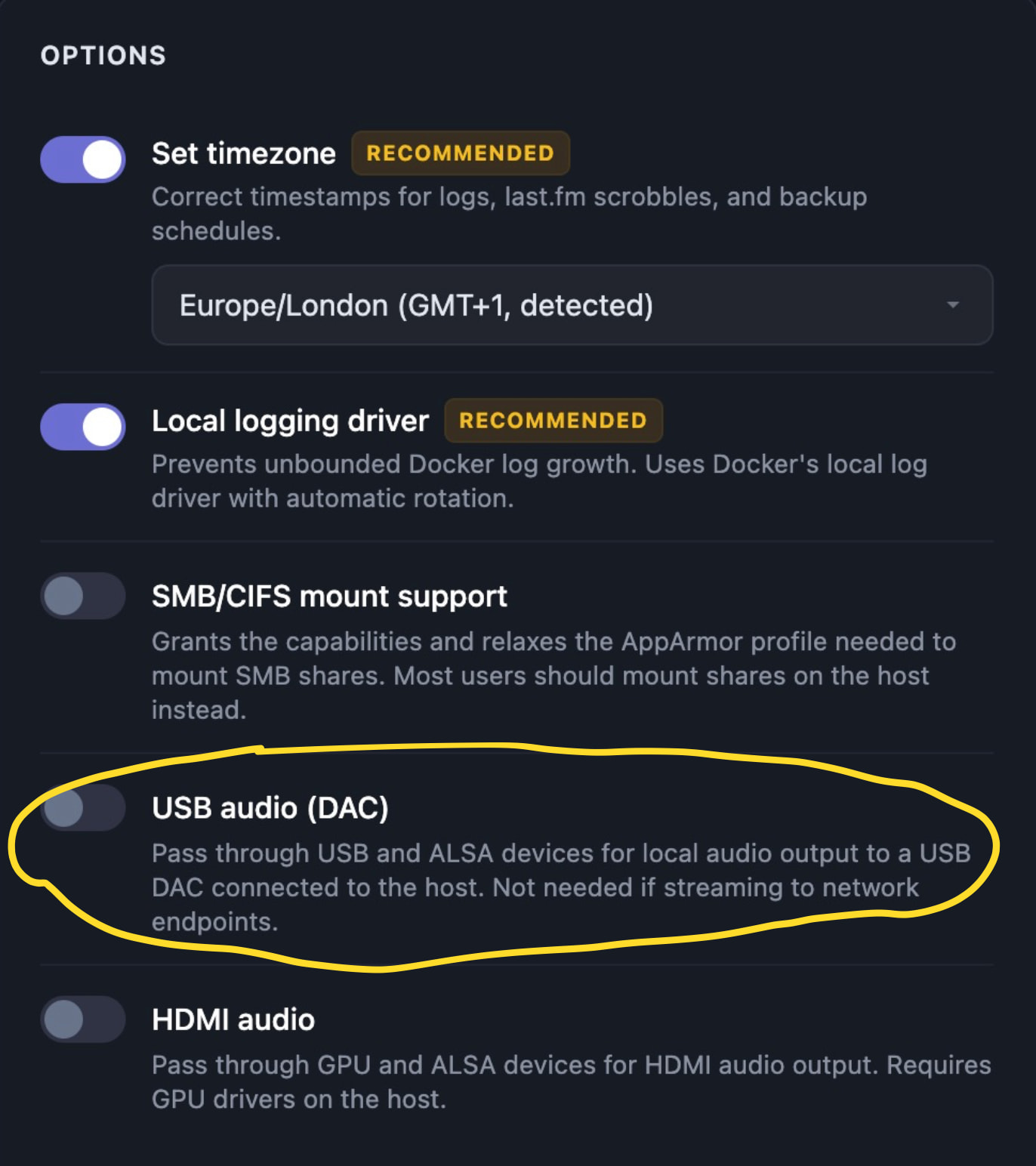

Did you enable USB in your Docker configuration file?
I didn’t turn it on :slight_smile: Thanks a lot. I didn’t notice. Maybe it will get better after the initial disappointment.
