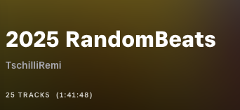

One structural detail that stands out: the play queue is logged as ordered count 8000 shuffle count 8000 , your Tidal playlist is being managed as an ~8,000-track in-memory queue, and every transition triggers a “queue got oversized, trimming N items” operation. That’s a plausible contributor on a low-power fanless device like the Z1C, and worth testing directly.
But the playlist only has 53 tracks – see the attached image. I simply can’t make sense of this information. Where on earth are all these tracks supposed to have come from? I’d never create a playlist of that size – I’d completely lose track of it :wink:. But yes, background music playlists can sometimes contain 300–500 tracks.
And as mentioned, I’ve noticed that the delayed track changes mainly occur when I want to skip several tracks in a playlist or when I want to listen to a different track from the library (which is being streamed to the playlist). The loading time of 1–2 minutes is the biggest challenge there. That’s why I’ve presented my list with the time blocks so clearly for you.
As an easy next step, can you test out a smaller subset of tracks and queue, something around 10-20 tracks?

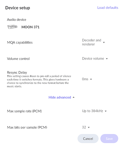

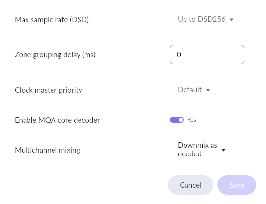

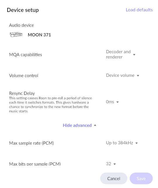

A couple more things to narrow this down. First, does this delay happen on every zone/output you have, or only on this specific one?
I have two zones, and the issue occurs in both of them. I have also tested it with individual devices as well as with multiple zones, but the behavior is always the same.
Second, could you please check that zone’s audio settings (Settings > Audio > device setup for the zone) for “Fade” and “Resync Delay”? If either is enabled or set to a non-zero value, please try turning them off and testing again, they can add delay on top of whatever else is going on.
Please see the attached screenshots.

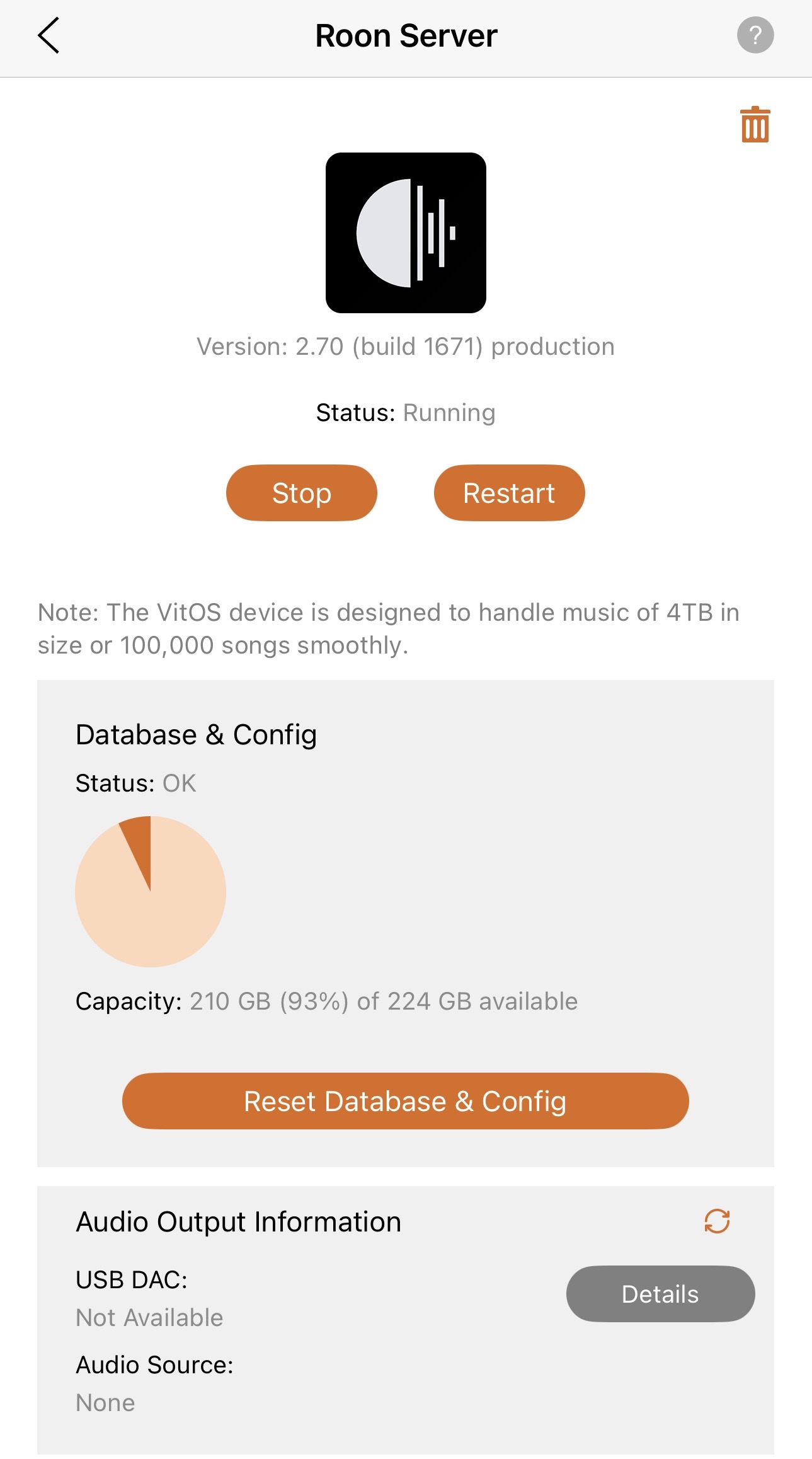

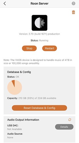

Now for something quite interesting: Early this morning, Roon installed an update (see the third screenshot attached). Interestingly enough, everything is now working exactly as I would expect. Between 5:30 PM and 5:45 PM, I tested it extensively, and track changes were immediate and everything worked perfectly.
Could this have been fixed by the update?
How would you recommend we proceed from here?
Thank you very much for your continued support and assistance.

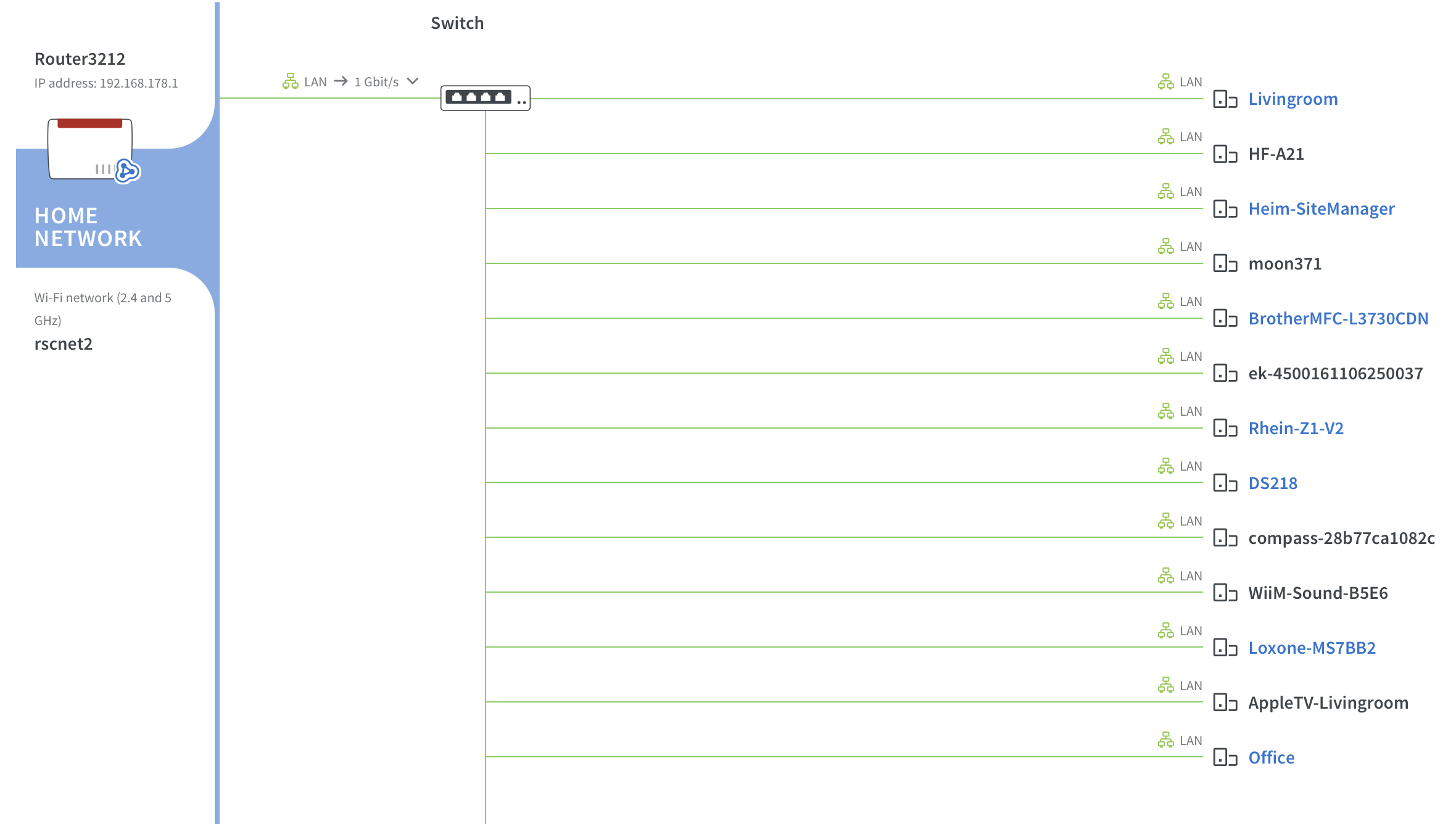

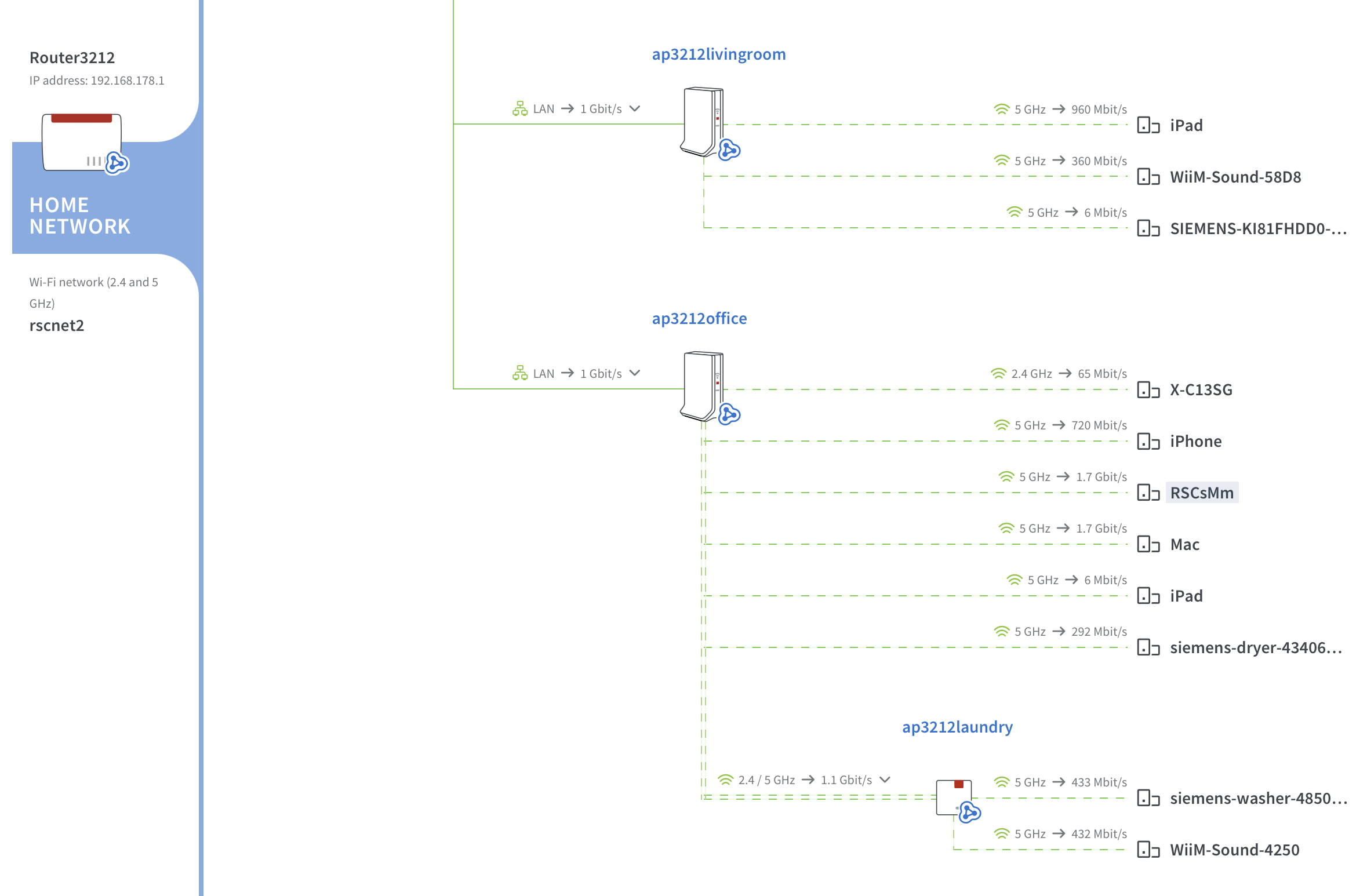

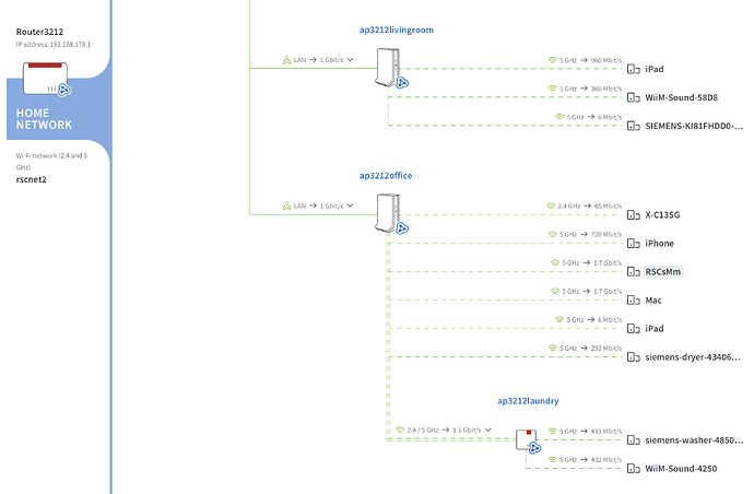

Thank you very much for your interesting and detailed explanations. I really do appreciate your support.
I’ve tried to provide you with a printout of my home network topology. Unfortunately, AVM doesn’t seem to offer a particularly useful print or export function – or perhaps I just haven’t found it yet. :wink: I hope, nevertheless, that the attached overview will be of some help to you.
I’ll try to give you a basic description of the setup:
• Internet access via Huawei – fibre-optic router operating as a modem
• FritzBox – router, Mesh master, DHCP server
• Zyxel switch (not a smart switch), used solely for distribution
• Fritz-repeater (living room) – mesh client – wired
• Moon music amplifier – wired
• Wiim Sound – kitchen – wireless
• Various Siemens household appliances – wireless
• Fritz-repeater (office) – mesh client – wired
• Bluesound PowerNode 1 – wired
• Bluesound PowerNode 2 – wired (back in use since last Friday; had been out of service for a long time)
• Wiim Sound – Bedroom – wired
• Fritz repeater (Laundry) Mesh client – wireless
• Wiim Sound – Bathroom – wireless
• Various iPads, iPhones, MacBooks, Mac Minis – all wireless
• Loxone home automation system, solar inverter, heating, doors/access, roller shades, etc. – all controlled centrally :wink:
• All network components are new and have been replaced

Hey @Remo_Schild,
Thank you for the thorough write-up and the network diagrams, that’s genuinely one of the most useful topology descriptions we get, and it let us line up your setup against the fresh Roon Server logs precisely. Let me share what we found.
Your hardware history actually points toward the answer, not away from it. You’re right that the problem survived Sonos, then Bluesound, then WiiM, and I understand why that makes a hardware/network cause feel unlikely. But the one thing that never changed across all three generations is the pattern: synchronised multi-room groups playing to endpoints that reach the network over Wi-Fi. Roon’s audio transport (RAAT) keeps every endpoint in a group sample-accurately clock-synced in real time, which makes it far less forgiving of small timing hiccups than Sonos or AirPlay, which hide them behind large buffers. So the same marginal wireless path that Sonos papered over tends to surface in Roon as dropouts. The constant across the years wasn’t the brand, it was grouping over wireless.
What the logs show. Over the ten days we reviewed, every single dropped/killed stream and every buffer error occurred on a grouped zone that included your wireless WiiM zones. Your solo zones, and your wired-only group (Office + Bluesound), played cleanly the entire time, no errors at all. The tell-tale sign is a run of RAAT “sync timeout” messages to a WiiM immediately before the group’s stream is torn down. In one case the error was even reported against your wired MOON 371, but only because it was grouped with a WiiM that had stalled; the MOON itself was fine. And notably, one of these failures happened on a 128 kbit/s internet-radio stream, which tells us this isn’t about bandwidth or high-resolution files at all, it’s about timing and synchronisation across the group.
A quick test that will make this visible to you. If you’d like to confirm it yourself:
  1. Group only your wired endpoints (e.g. MOON 371 plus a wired Bluesound) and play something for a while, this should be rock-solid.
  2. Then add a single wireless WiiM (Kitchen or Bathroom) to that same group and play the same content.
If the dropouts return only after the wireless endpoint joins, we’ve located the mechanism precisely.
What will actually resolve it:
  • Where you need whole-home synchronised groups, the WiiM endpoints really do need a wired connection. Grouping Wi-Fi endpoints with wired zones is the specific combination that fails.
  • Your laundry repeater is running on a wireless mesh backhaul, so any audio endpoint behind it is effectively two wireless hops from the router, the hardest case for RAAT. I’d avoid placing audio endpoints there, or give that repeater a wired backhaul.
  • On the FritzBox, set a fixed IP (DHCP reservation) for each Roon endpoint. We can see at least one device has already changed address between captures, and re-addressing forces Roon to re-establish connections.
On your restart question, this is a great observation, and the behaviour is intentional. Your zone groupings, settings and library live in the Roon Server database, which is persistent by design; a restart is not meant to reset them, so nothing is stuck or corrupted there. What a restart does clear is the transient, in-memory state, the live audio connections and device discovery. So retained zone groups after a restart are exactly what we’d expect. One thing worth mentioning: the logs for this period show the Roon Server software itself started only once, so whatever restart you’ve been performing may not be cycling the Roon Server process. In practice, if you want to clear a stuck audio path, power-cycling the endpoints (the WiiMs / repeaters) tends to help more than restarting the server.
If you run the test above, share the result and we’ll take it from there.
