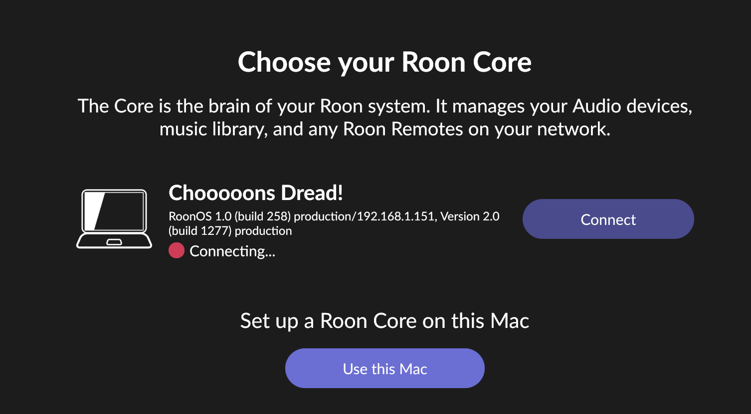

Rebooted the ROCK (Intel NUC) but makes no difference! It’s on the network and seen by the Roon app running on my Mac but won’t connect. (I’ve attached a screenshot)
You can see in the screenshot, the IP from the old router before I changed to this eero 6+ mesh router the other night - which has allocated a different IP, (as you would expect when changing the network).
Assumed my endpoints / Mac etc would just find it on the new IP as it’s all on the same network. But no!
Have also deleted the Roon software from my Mac and reinstalled… still can’t connect. Same screen comes up in Roon software - just in white now…
Shows ‘connecting’ but does nothing. The Connect button is greyed out and can’t be clicked.
Help!!

You say that 192.168.1.151 (from the screen) is the IP address that ROCK used with the old router.
Where did you see this and what is the address that is ROCK using with the new Eero router?
