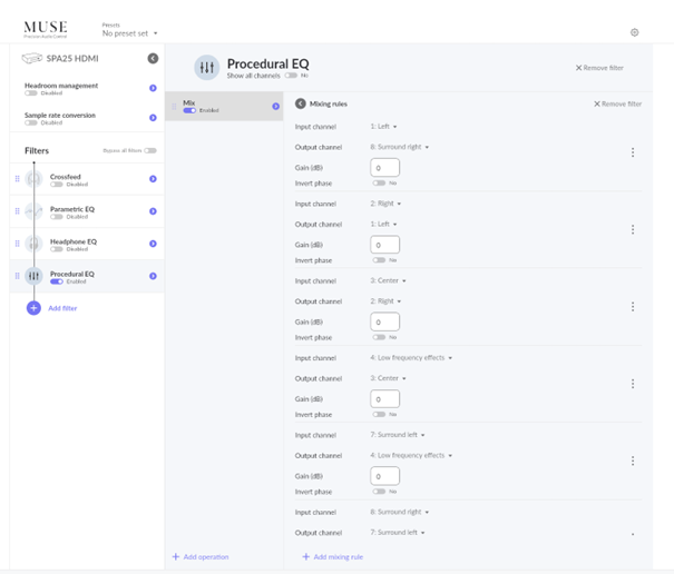

After update 2.48 Build 1517 on the Nucleus One, the channel mapping using HDMI to my Primare SPA25 has moved 1 channel. For now I solved this by using the MUSE Procedural EQ Mix and added rule that Input 1 is output 8, input 2 is output 1, input 3 is output 2 etc. I tested this with a channel ID file. It is both on stereo and 5.1 content that the channel mapping is off. Before update 2.48 this problem was non-excisting. For stereo content using network playback, there is no issue. Could you take a look what is happening? Thanks.

@daniel Hi, thank you for the steps. I followed those but the problem remains. Only with Procedural EQ Mix on, the music is played in the correct channels. This is a good workaround anyway, but still strange that it needs to be used with Roon Ready AVR.
