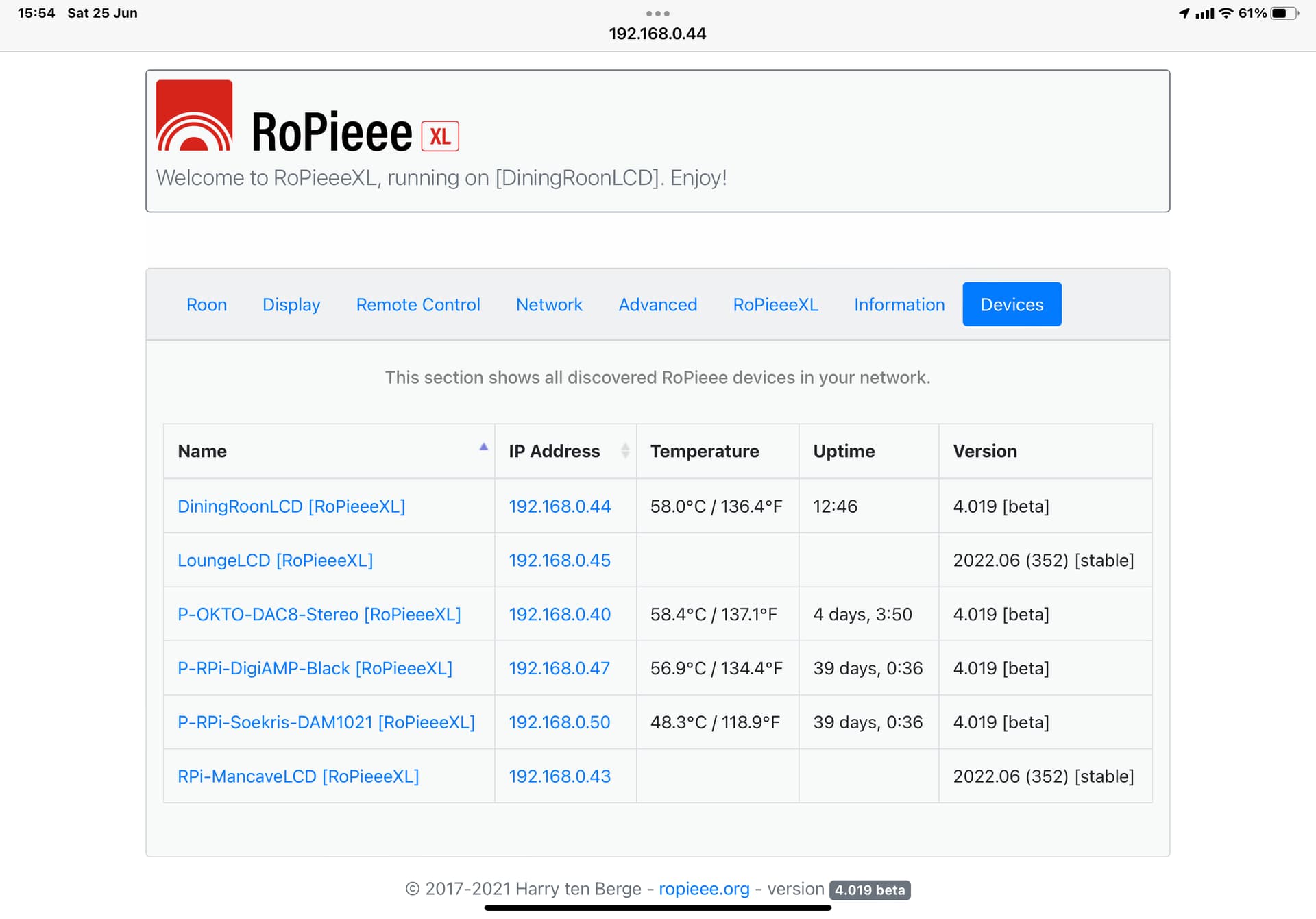

I’ve run upwards of 10 ropieee endpoints at one time and WiFi on a robust network is normally not an issue up to say 24/96 bitrates
Some of what is running now
