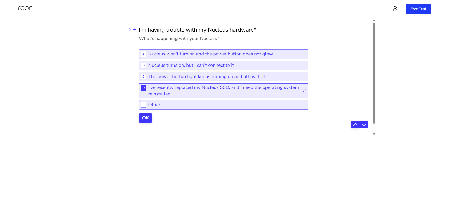

It looks like ROCK was installed on your Nucleus, and to restore the correct Nucleus OS, our RMA team will need to reinstall it remotely. This process will return the device to its intended factory software environment.
Please submit a request using the link below, and follow the guidelines shown in the screenshots attached:
:link: Technical Support Request

Hi Vadim,
Thank you for your support and detailed guidance.
I wanted to let you know that I have completed and submitted the requested support form as instructed. I will be waiting for the next steps regarding the remote reinstall of the correct Nucleus operating system.
