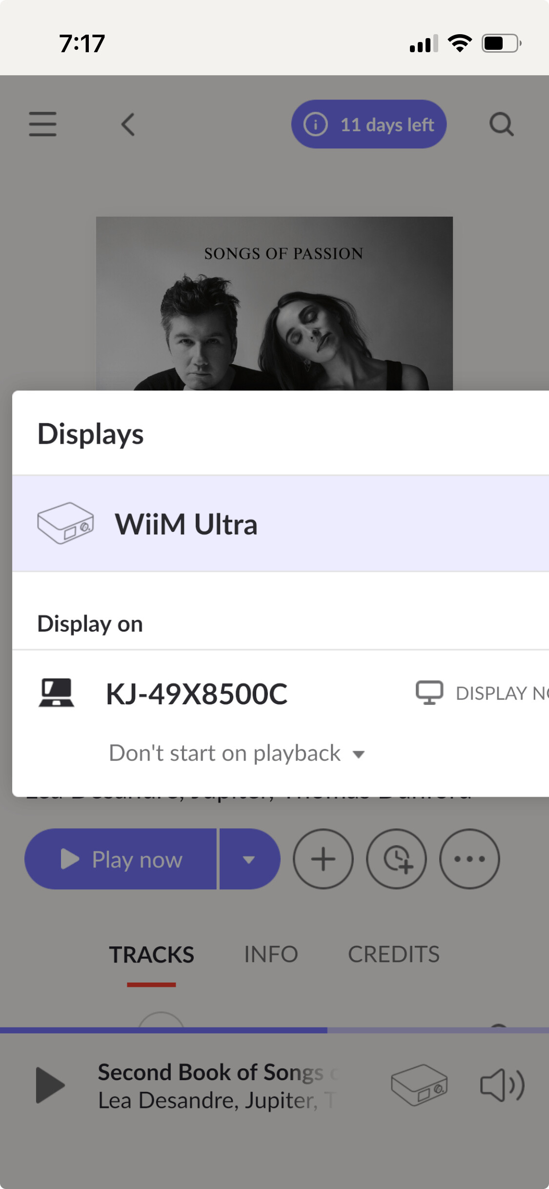

When I try to use "Displays" to Chromecast a display to my Sony Bravia KJ-49X8500C, it shows a black screen on the TV for about 30-40 seconds, then stops. (Web display works fine.)

Can you please confirm that we understand you correctly, that you are trying to display the lyrics and track progress via Chromecast display as on the screenshot (

Yes, that is correct. I am trying to display the track progress and lyrics on my TV screen, as in this screenshot of my phone:
