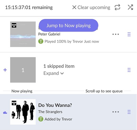

Hi Vadim,
Thank you for the quick response. I have just recreated the issue, which occurred at 13:25. One track was skipped (the previous and next track along with the skipped track
all on Tidal), see attached <div 1">
Add images
screenshot. This occurred on zone Living Room TV. I hope this is the information that you require.

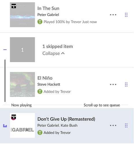

Good morning Benjamin,
I followed your instructions and the first skipped track (in fact 2 tracks skipped) was at approximately 7:32. I have attached a screenshot.

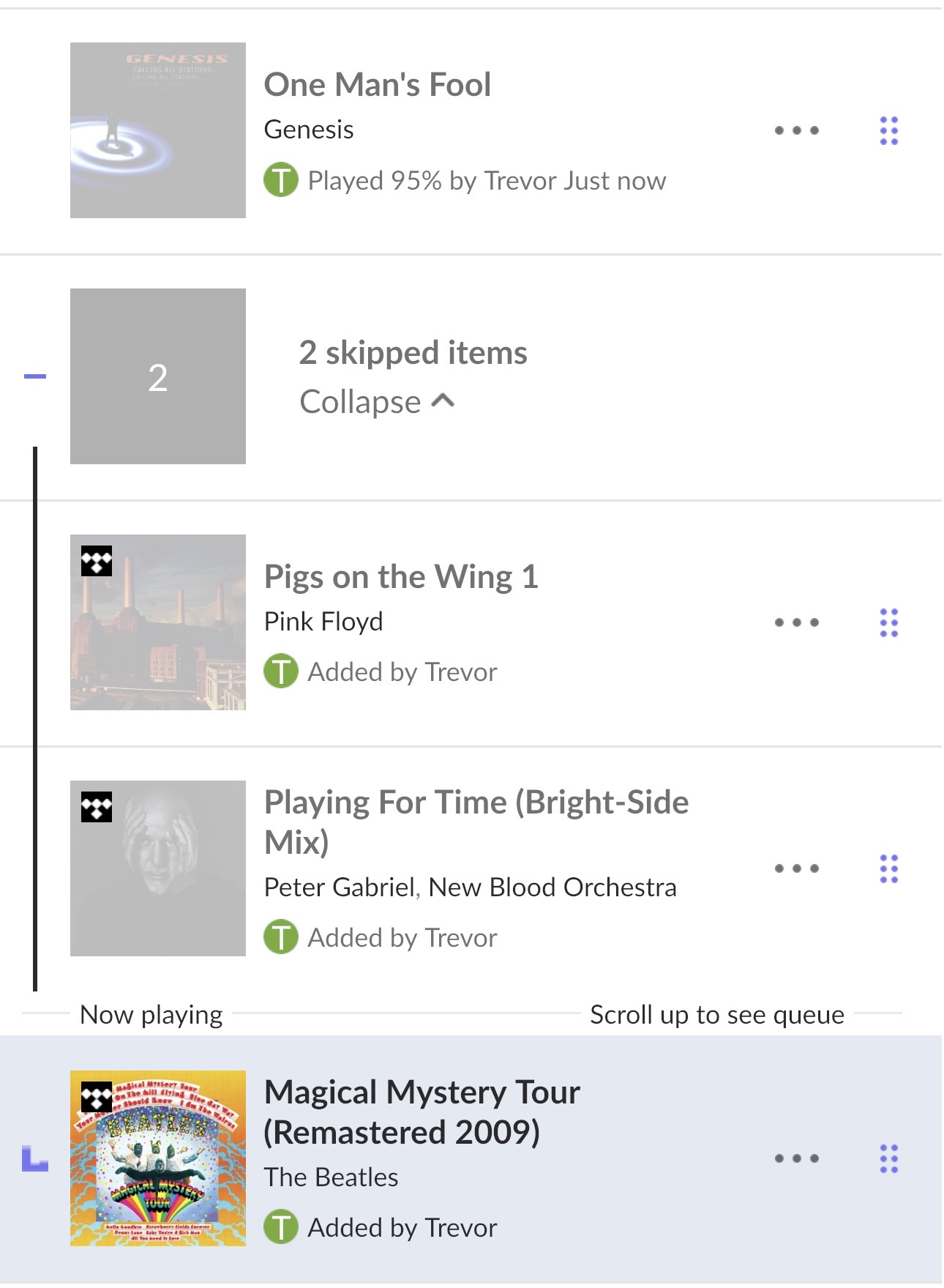

No problem Benjamin, I rebooted the server twice and started shuffling my playlist. One track was skipped at 19:24, see attached image
You have my apoloigies @Alexandre_Sagala we’re having a difficult time enabling diagnostics on your HomNAS Roon Server, could you please use the directions found here and send over a set of logs to our File Uploader? Once logs have been uploaded, please let us know so that we can check the server for your files, thanks!
Wonderful, thank you @Trevor_Penny - we’ve captured what we were looking for and have shared it with our development team.
What we did notice is that the specific track was being converted AAC to FLAC, and was then hit with a 404.

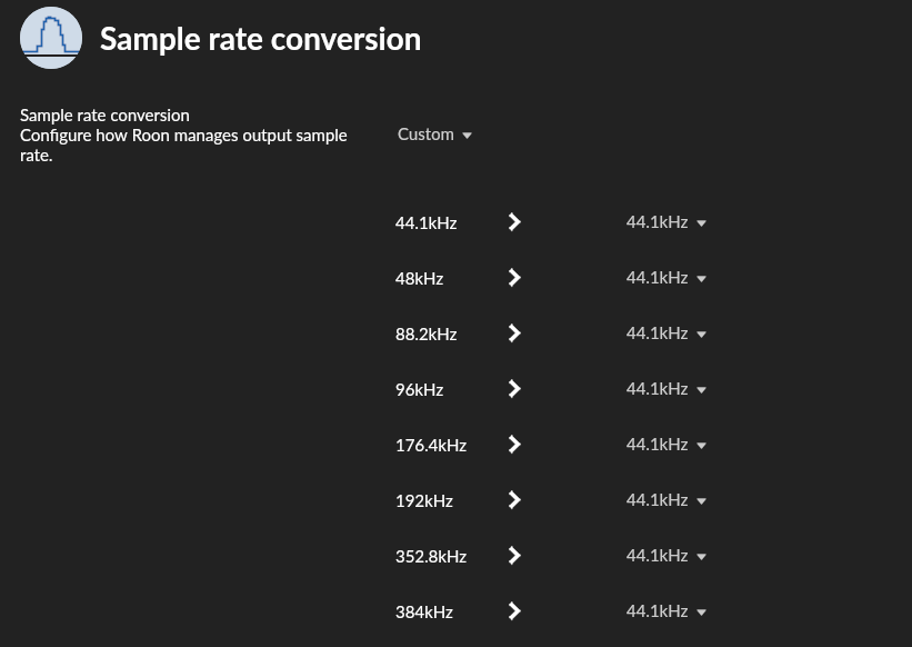

Another follow-up test for you - if you set a sample rate conversion to force all resolution formats to 44.1kHz, do you still run into the issue?
To do this, enable sample rate conversion > select ‘custom’ and manually set each resolution type to convert to 44.1:
Let me know if that changes any of the behavior. Thank you! :raising_hands:

Hi Benjamin,
How do I get to these settings. I’ve looked everywhere but can’t find them,
Regards
Trevor
Hi Benjamin, ignore my last message, I have discovered the settings, will update you when I’ve tested.
