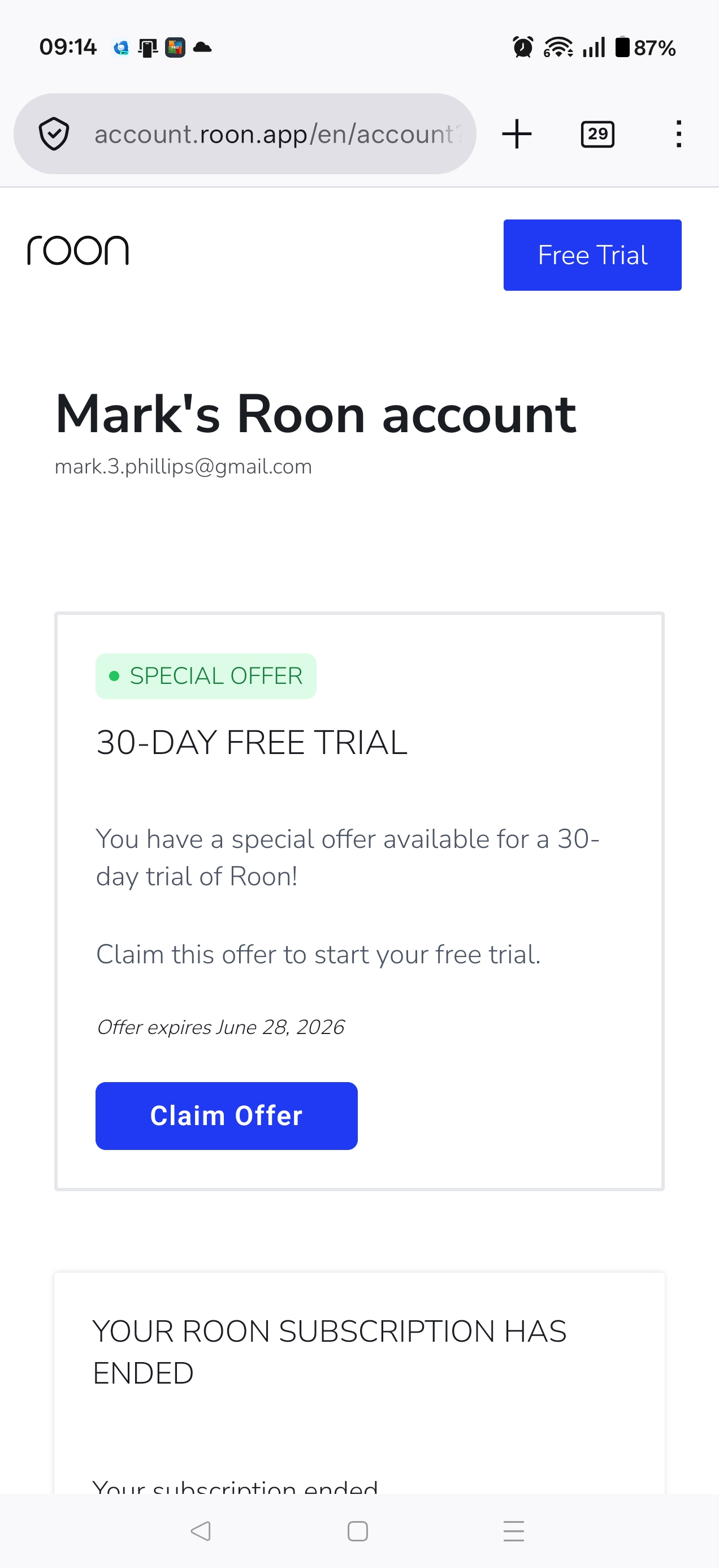

· I've been offered an extended trial to try and get Roon working by Customer Services. The claim offer button on my account page doesn't work so I cannot claim the offer or start the subscription?
· I'm accessing my Roon account via a Win 11 pc and have tried 3 separate web browsers.

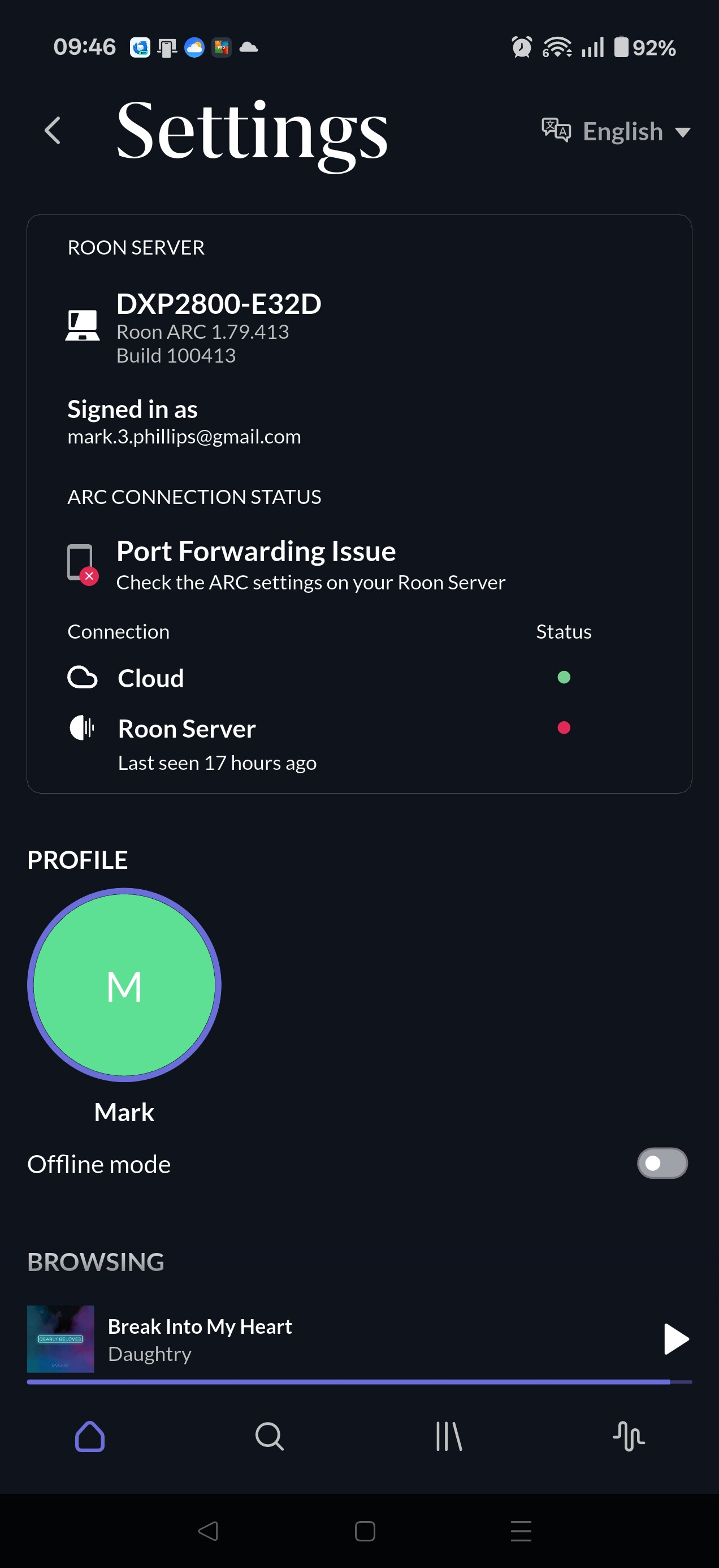

I can run android Roon over a Tailscale VPN and access the library when not connected to my local network but Roon ARC will not connect to it either with it without the Tailscale VPN. My router has multiple Roon ports forwarded as instructed. Disabling firewalls doesn’t seem to make any difference.

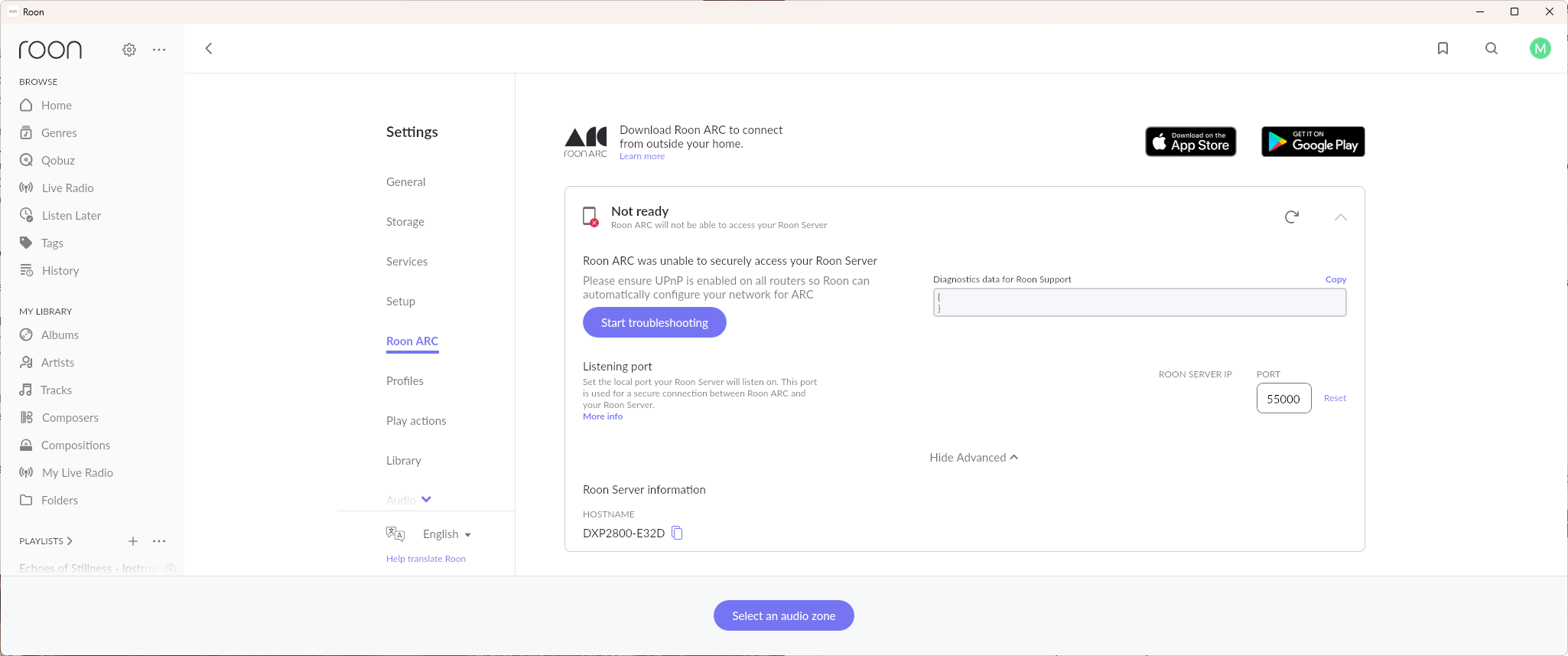

I am now at the same stage I was before with Roon ARC. When I check the remote connection option in Roon settings the image below shows there is no diagnostic info to send on?
I would be grateful for any help to resolve this.

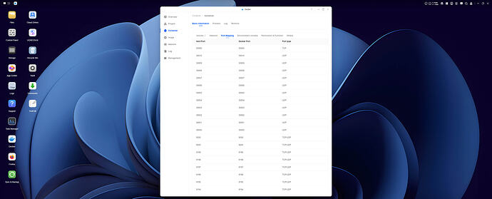

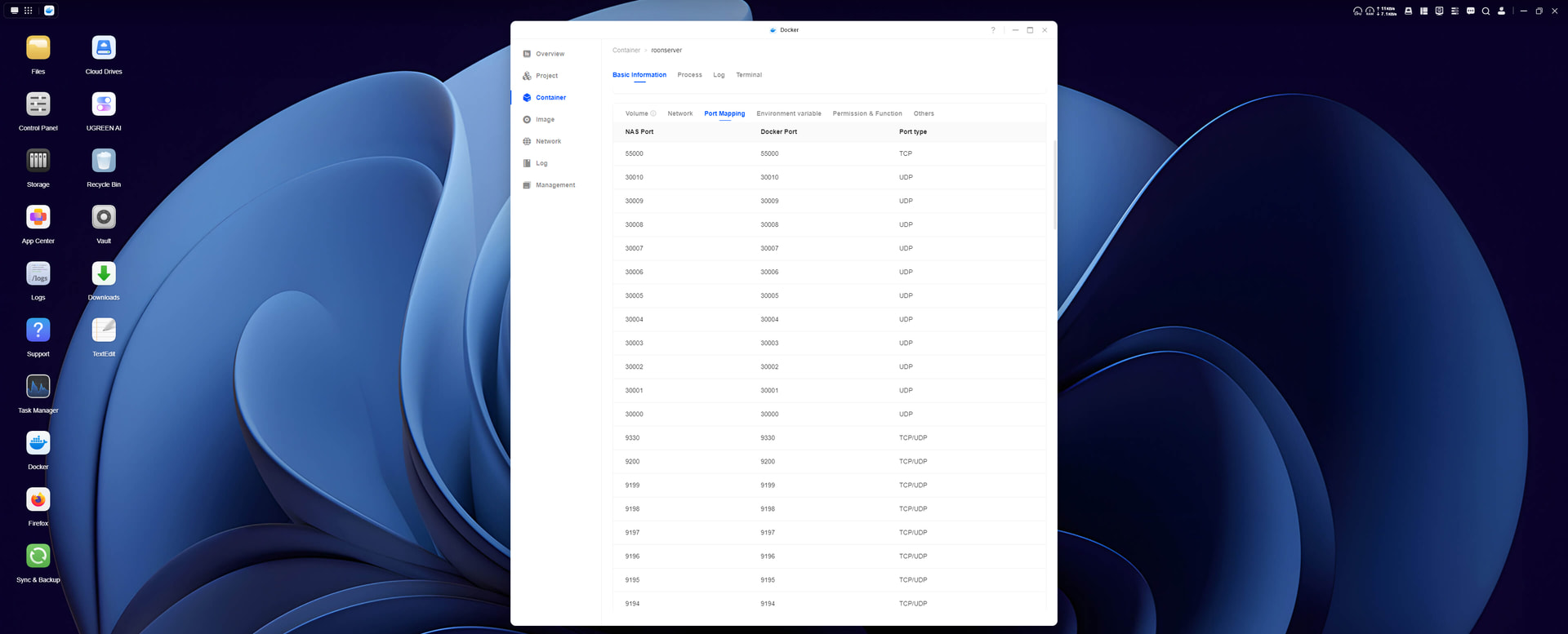

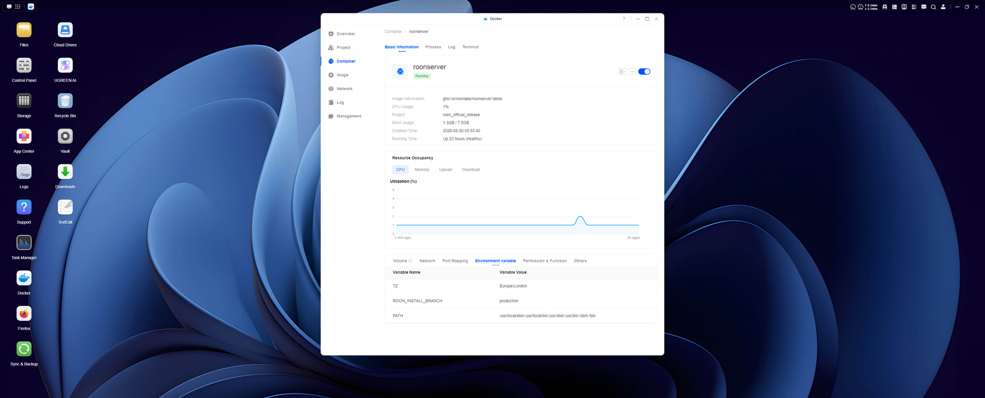

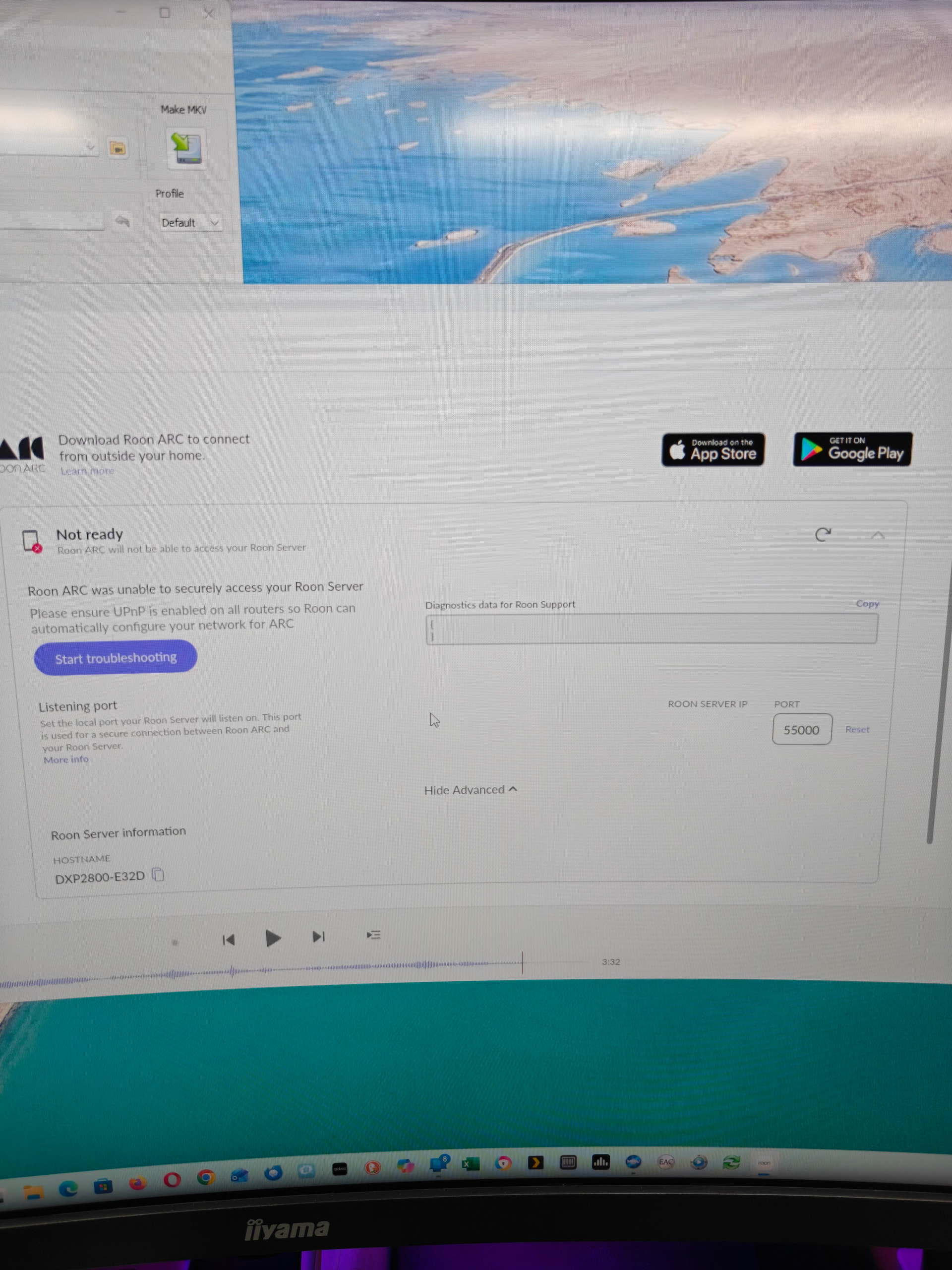

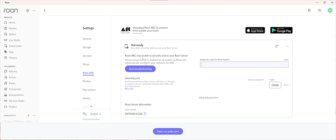

1. I’ve attached a screenshot of the Roon Arc Settings screen from the Roon client and from the Roon ARC client as requested.
2. My topology is that I have a Windows 11 AMD Ryzen 9 PC (192.168.0.63) connected to a 2.5Gb ethernet switch which my Linux Ugreen DXP2800-E32D NAS is also connected to. I have the official Roon server release software loaded on the NAS via a Docker container. The switch connects to a Deco X55 cellular router (192.168.0.1) using the Vodafone Network
3. I have attached a screenshot of the port details from the Docker container. In addition on my router I have port 55000 TCP open to 192.168.0.53 (NAS Server).
4. The local IP address of the NAS is 192.168.0.53.

Hi @mark.3.phillips,
Thanks for the update!
Interesting that it seems like you have a single router in your setup but are running multiple local subnets - is that correct? If you temporarily disable all but a single subnet, and reboot your devices to ensure everything falls onto the same subnet, do you see any sort of port forwarding error code in Roon Settings > Roon Arc?
