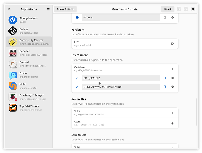

The easiest way to set this up is by installing Flatseal. This is an app that allows the configuration of Flatpaks in a graphical way. If you select Community Remote and scroll down to Environment you can add a new variable. This is what it looks like for me:

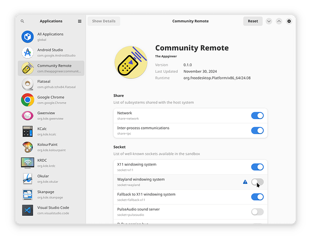

What I see is that on Wayland I have to disable the “Wayland windowing system” for the GDK_SCALE setting to take effect.
Yes, that uses X11 and on a Wayland server, it uses XWayland, which responds to GDK_SCALE.

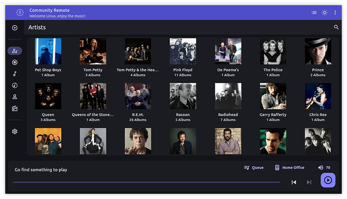

Community Remote version 0.2.0 is now available
This release brings a few updates to the user interface:
Grid View
The app bar now has a toggle between the known list view and the new grid view. The grid view makes the artist and album art more prominent, for a more graphical browsing experience. For those browse menus that don’t provide art the list view is used independent of the view type, this just gives a better appearance.
Queue Hiding
With the grid view in place it made sense to have the option to let it take the full width of the window, for this the Hide Queue option is added to the menu. This settings works independent of the view mode and thus also allows for a full width list view. When the queue is hidden it can be accessed via the Queue button in the Now Playing area at the bottom of the window.
Close button on full screen dialogs
Till now the full screen dialogs, like Now Playing, had no close button and someone had to guess that the Esc or Back key should be used for closing. This is now fixed by having a prominent close button at the top left of the screen.
Grid View in Action

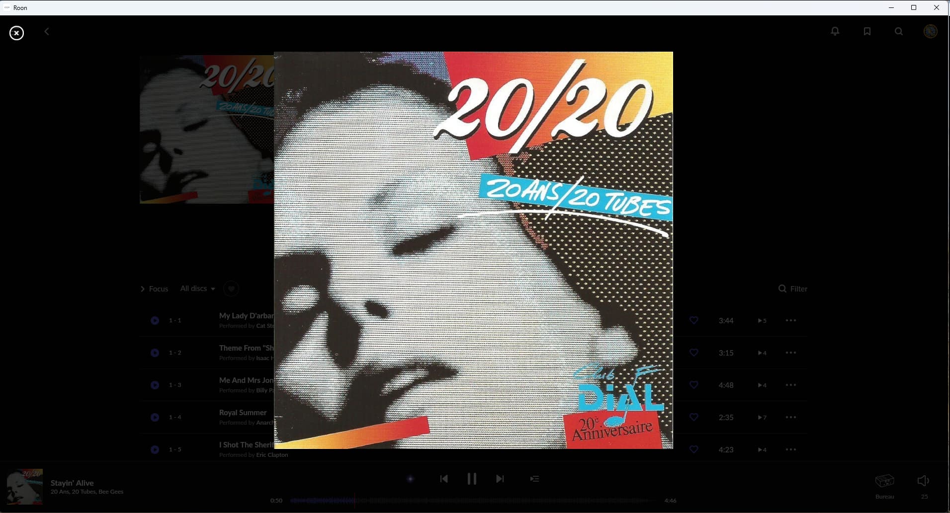

Hello everyone and happy new year,
@Jan_Koudijs

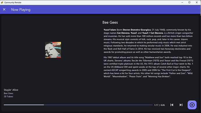

Jan do you know why the image displayed on the « Now Playing » page is so small sometimes ?
while she is normal in Roon
dp

Seems that the bigger image did not get requested from the Roon server and therefor the smaller thumbnail is used. Is there any pattern in when this happens? Is it for example when Now Playing is open and the song changes, or when opening Now Playing, something else?
@Jan_Koudijs
Thanks for your reply. I will look into this more closely to try to answer your question.
@Jan_Koudijs
I just observed it now.
I launched a playlist on Roon Remote, displayed now playing on Community Remote. The image of the first song is correct, not the following ones.
I looked at the Community Remote logs, only the first image was requested in 1000x1000, the following ones were requested in 100x100.
I’ll send you the log by email.
