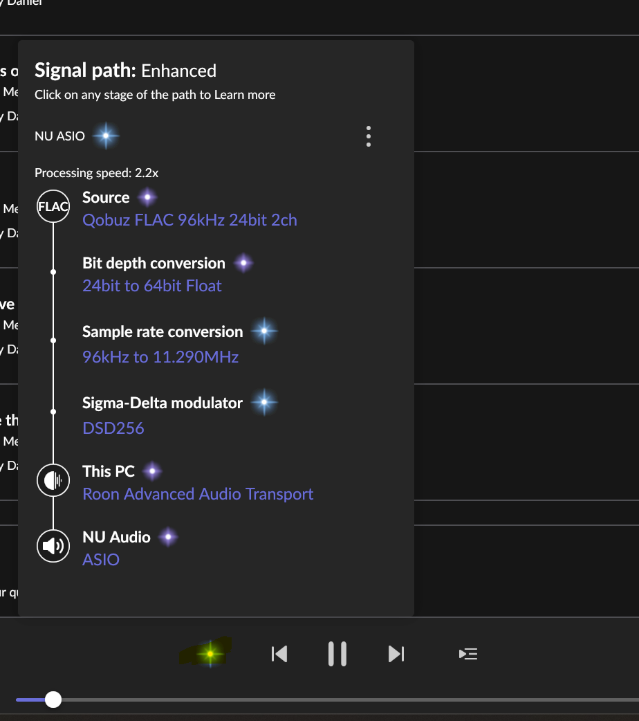

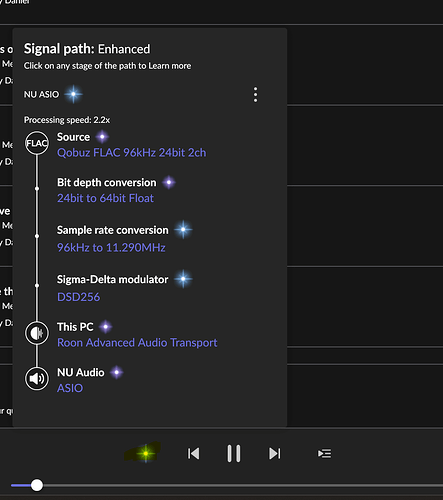

When you are asked for the signal path, you are being asked for the signal path as shown in Roon.
Like this…
It is accessed by clicking the dot which I highlited in yellow on the play bar. As you can see the Signal Path shows what ROON is doing, what it is sending etc. In my case, I’ve set Roon to upscale to DSD256 and you can see it is doing that.
Keep in mind, with DSD make sure there is no DSP going on, no volume leveling, etc as that can stop the conversion to DSD.

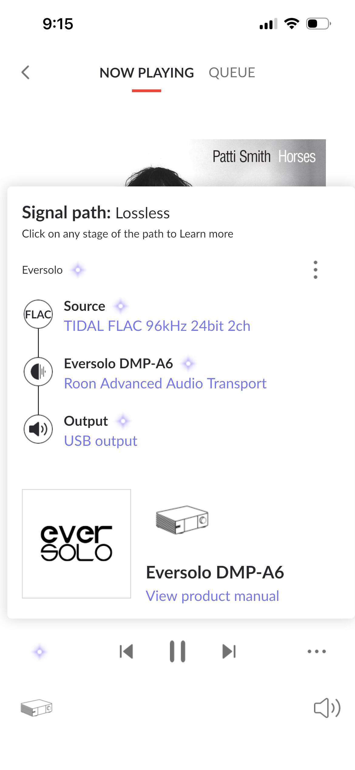

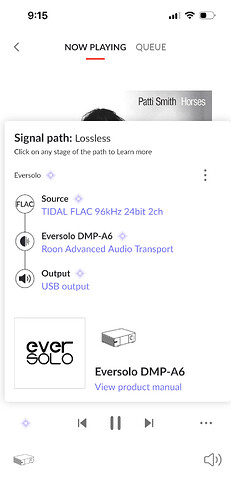

Great I can live with that if it shows DSD. Thanks for the heads up. I figured signal path meant the same thing as signal chain. I have seen that. I now have the Eversolo working to display the screen and output to my Musician Pegasus via USB. I had to also switch the Eversolo to DSD over PCM, along with my Pegasus and IPhone before it played music. Here is my signal Path:
Your signal path show the source is FLAC, and no conversion or DSP takes place. Output to the DAC is lossless, but there is no DSD in this example.
Right. That’s the problem. I bought the device to have the Nucleus One convert PCM or FLAC to DSD, and then send DSD to my DAC.
It’s not doing that and the product describes it can do that. How do I get it to do that.

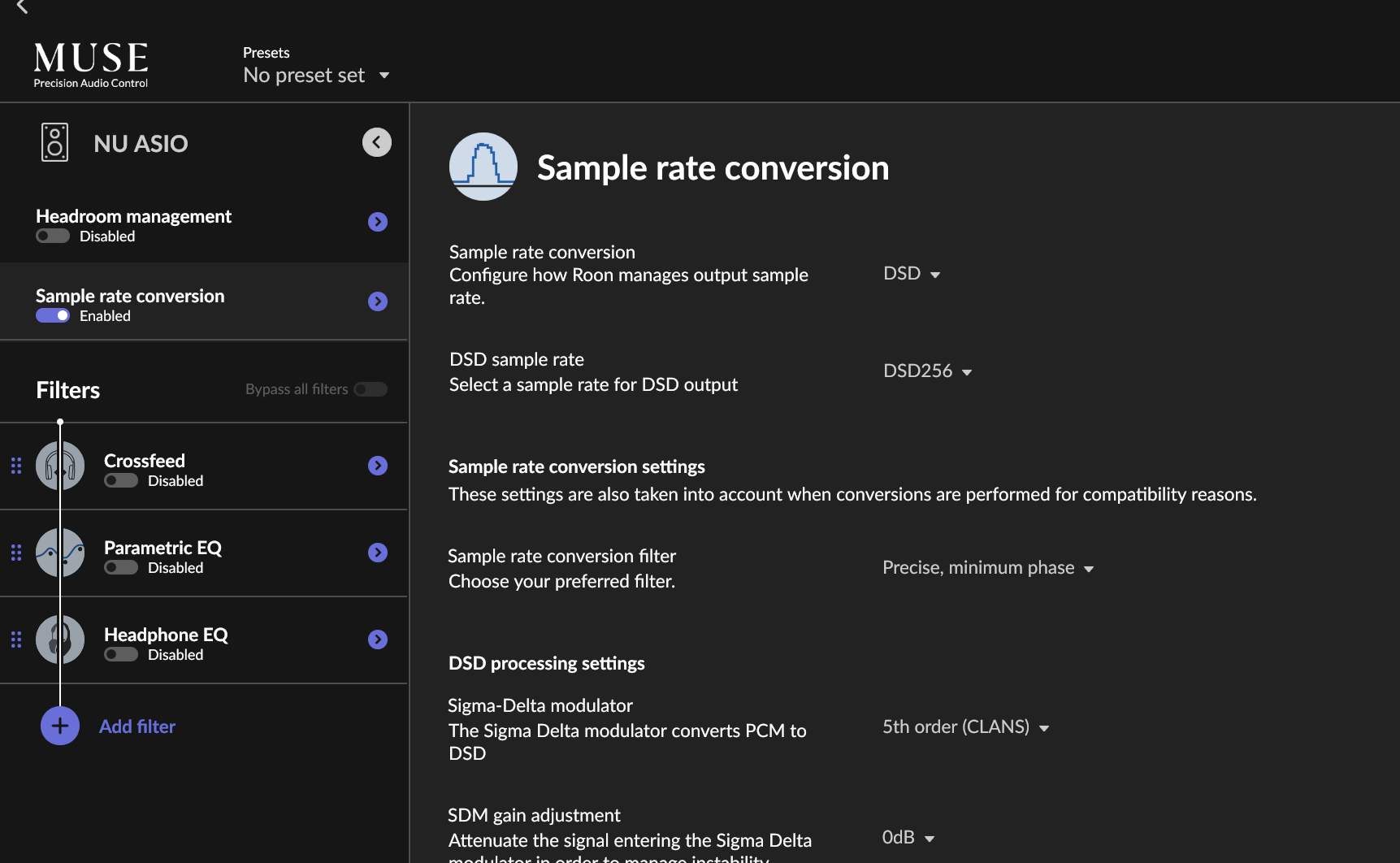

It will only do this if you setup Muse to perform the conversion.

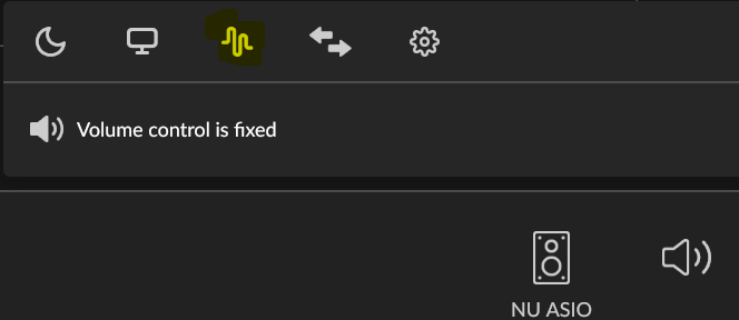

If by product you mean Roon, then go to the MUSE settings for the output and Choose DSD. From my previous post, here is the Muse settings for that Audio Endpoint.
But, when it comes to DSD every step has to handle it right or it will reconvert back to PCM. You need to find out if your DAC and the Eversolo can pass Native or DoP, and then set that correctly on the Eversolo. Note that with DoP, you will loose the highest DSD rate (meaning if your DAC can do DSD 512 Natively, it can only DSD 256 with DoP).

Choose your Audio Endpoint, then click on the volume icon to bring up a menu, the Muse Icon is the one that looks like a little sine wave. I’ve shaded it yellow in the screen clip below:
