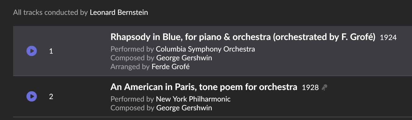

Yet, when I click My Library → Composers on my Mac Roon Client (ver 2.0, Build 2011 as well), Gershwin does not show up. See the snapshot below, with Composers in alphabetical order by last name.
No idea what might be causing this one, though. Can you show a screenshot of your search result screen please? It finds albums for me (and I don’t even have any in my library)’
So, can’t find those albums searching by composer - that is the problem.

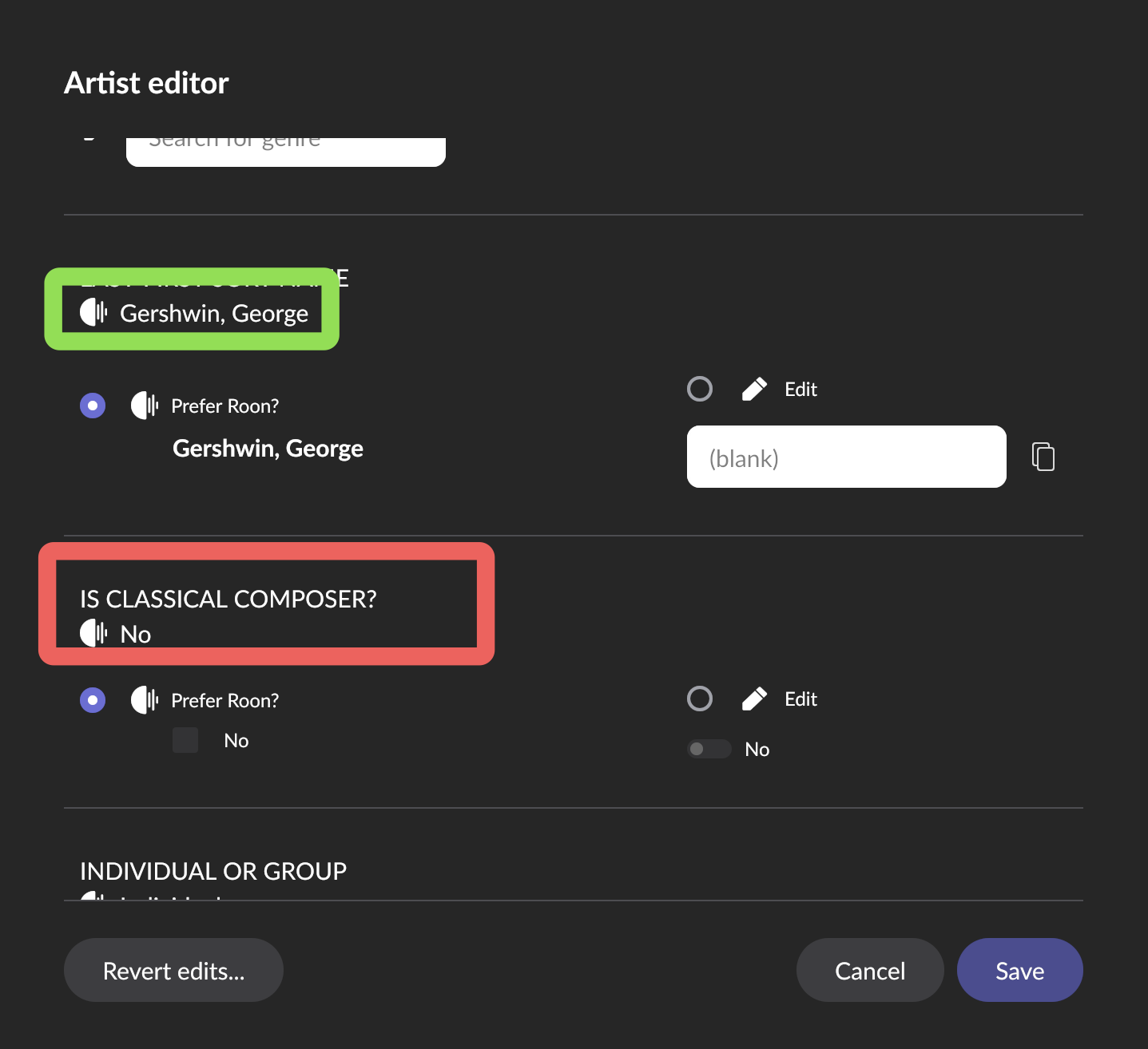

Now, I just went and edited Gershwin to be Classical composer. The “Appearances in my Library” section is now replaced by “From my library” with all Albums that include Gershwin listed, including those above.
Thus, it seems Album search by Composer is only possible for Classical composers. Is it a bug? Shouldn’t one be able to find Albums for ANY composer if tracks for that composer are included in the Album?

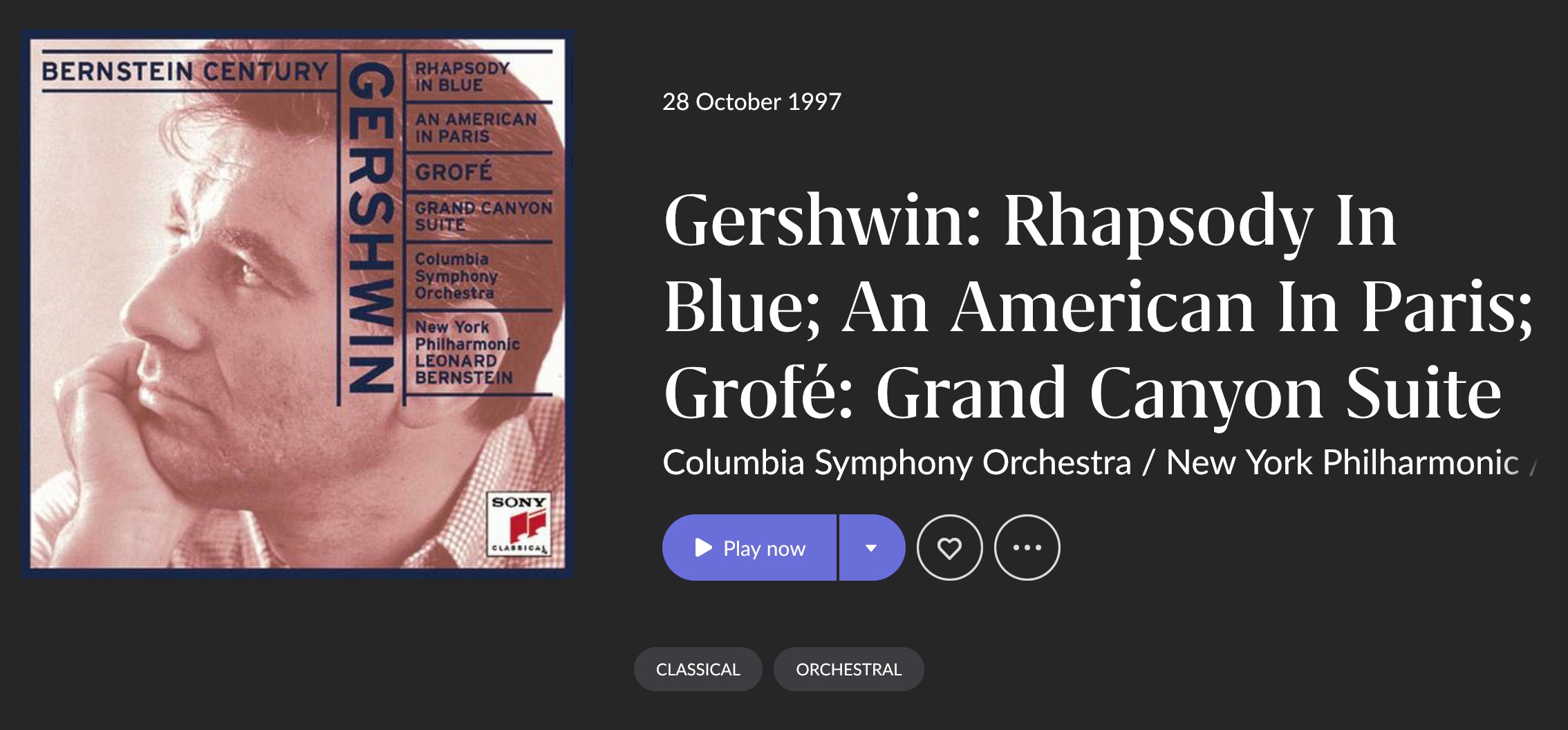

I hear you, @Ludwig, however the albums above were marked Classical from the beginning, yet, would not show on the by-Composer search till I edited Gershwin to be Classical composer (which he was not in the beginning).
