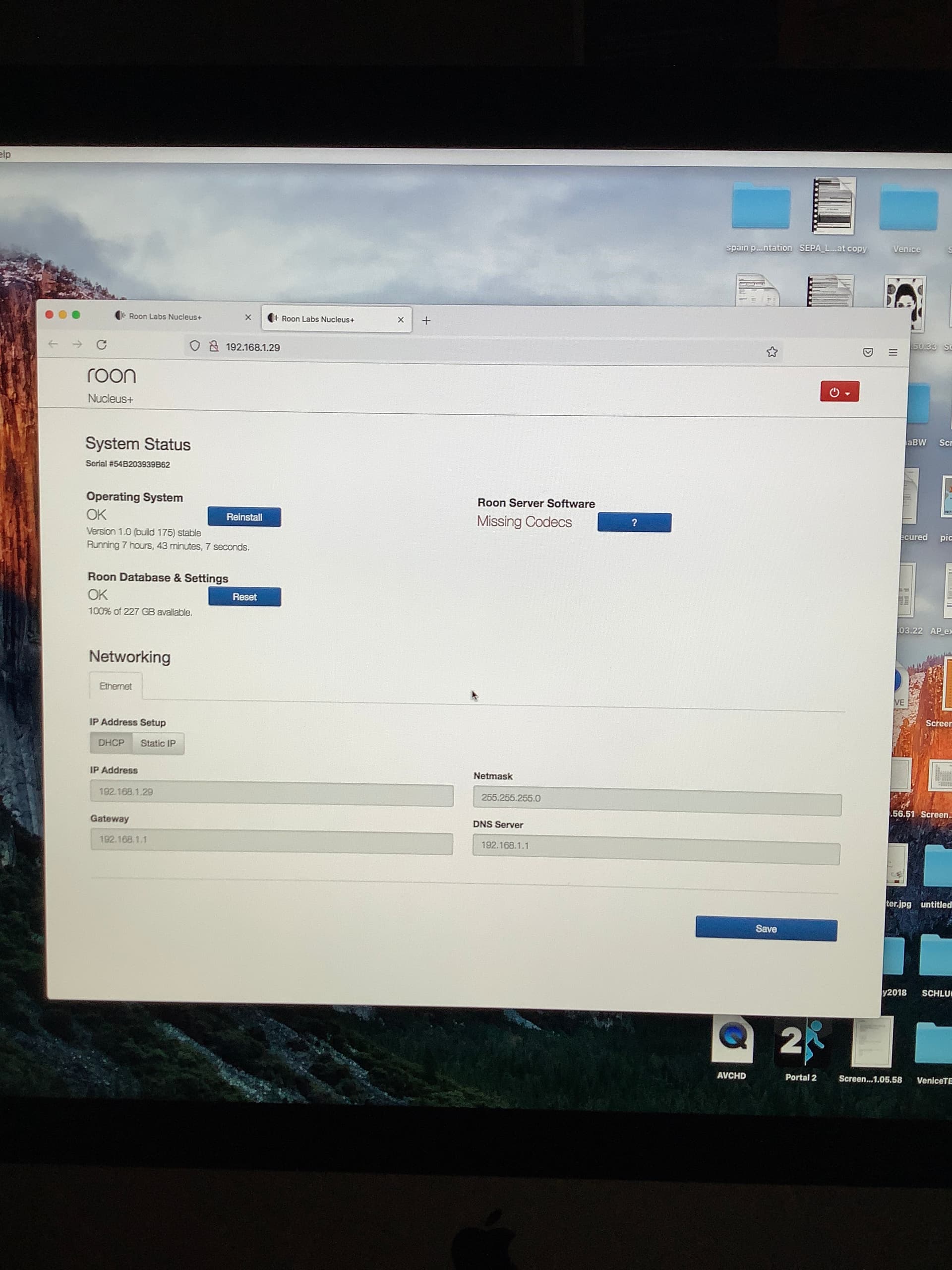

Just received open box nucleus plus. Connected as described. Remote does find Roon OS Device Vers1. Entering system status I try to reinstall operating system. It starts UPDATING AND REINSTALLING. Then it tries to do so for a long time and gives me the error message that the internet connection is not working. Which really does not make sense. I can reboot and and turn off. Can you help please.

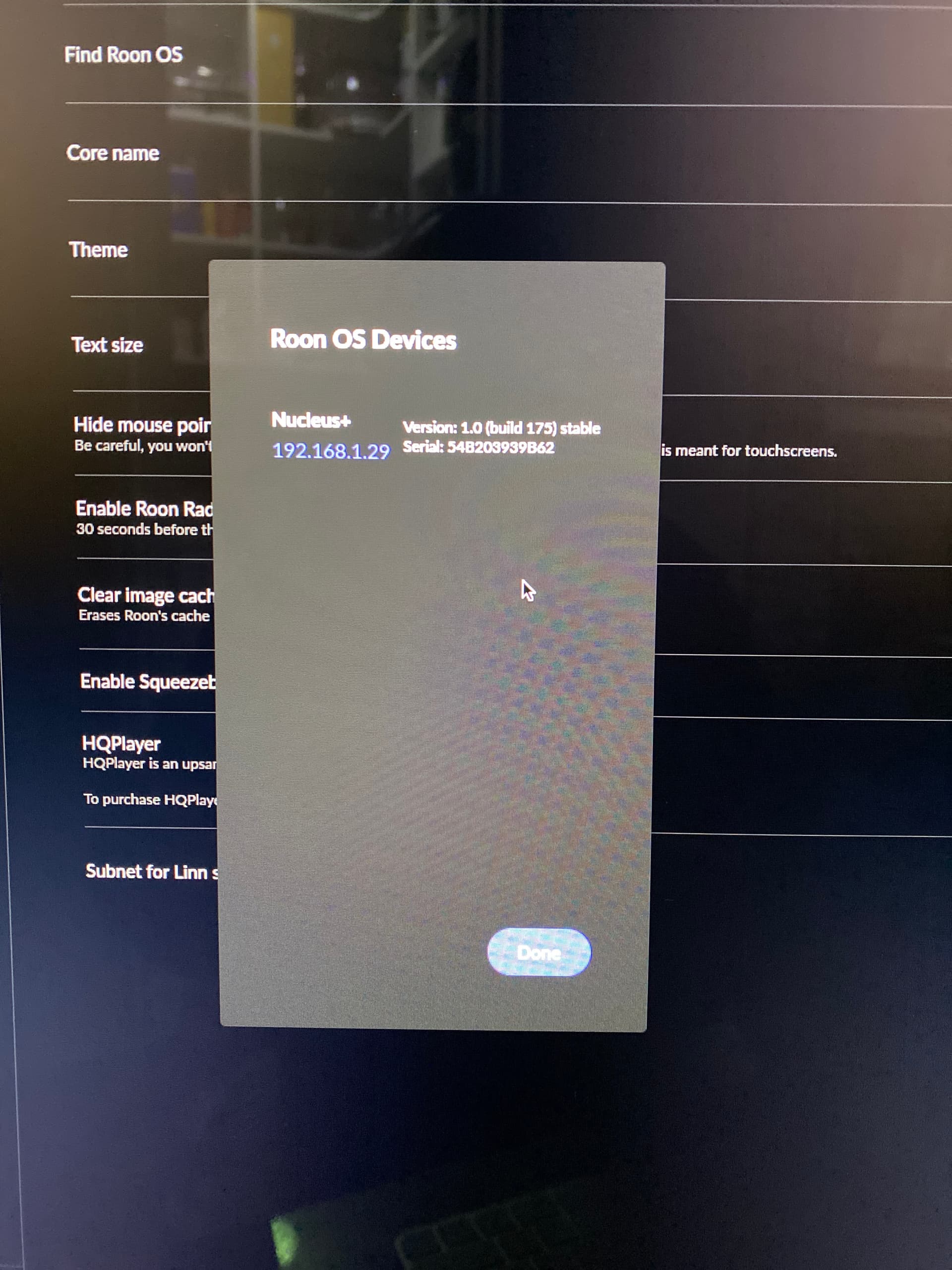

I got the nucleus from room directly. It shows
i did not reinstall anything. Should I ?

The current version of Roon OS is Version 1.0 (build 227) so I would definitely reinstall the Roon OS. Another concern is the missing codecs, which should not be missing if the Nucleus was shipped directly from Roon. You are receiving an IP address for the Nucleus, are you able to reinstall Roon OS? Sometimes this takes awhile to download and reinstall on the Nucleus.

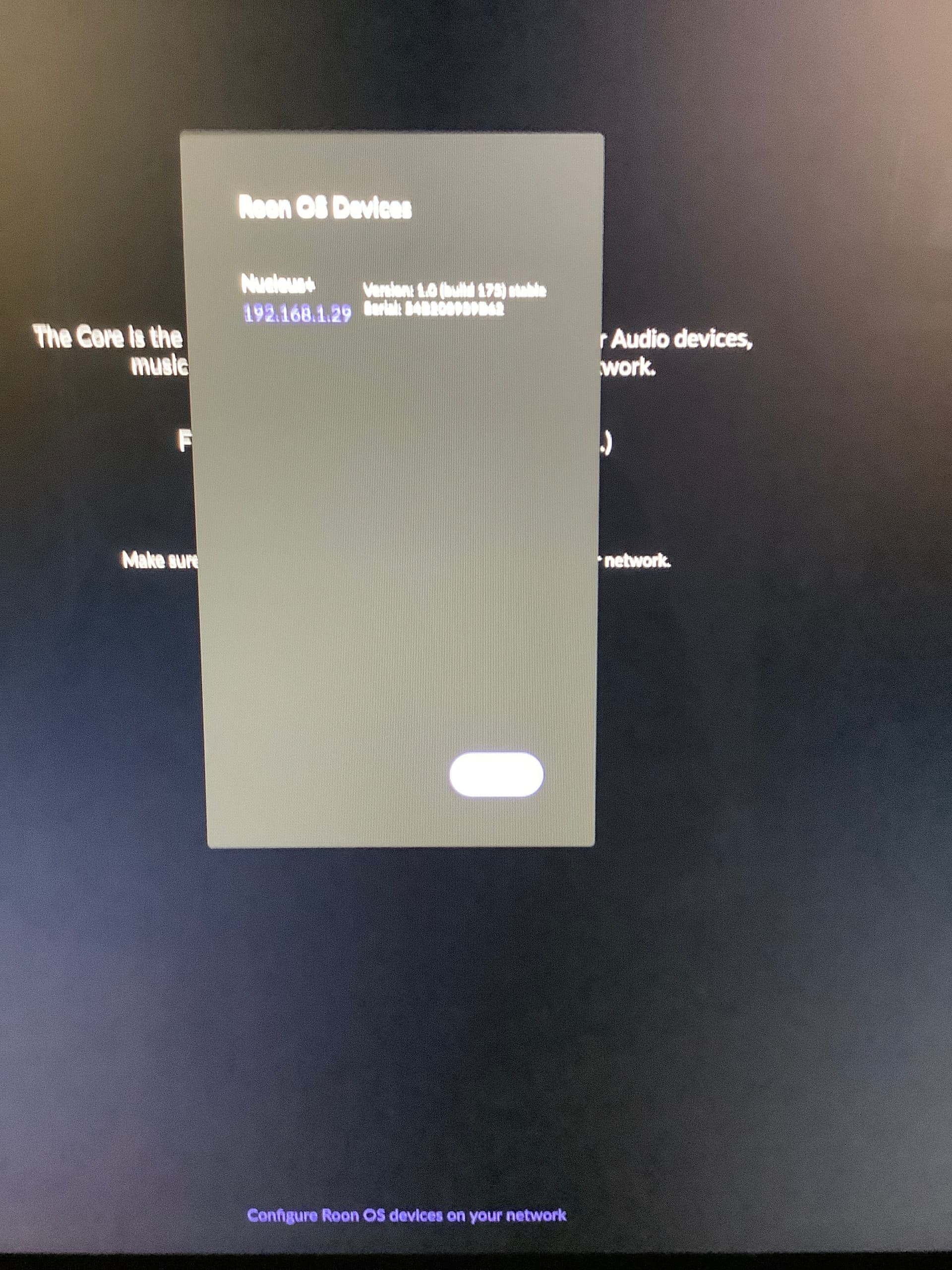

I can not make it core. It is t found
I find it when clicking on bottom link “configure Roon is…” but it is not found when I look for core.

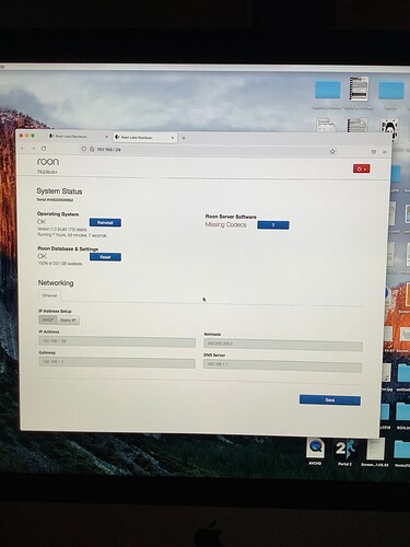

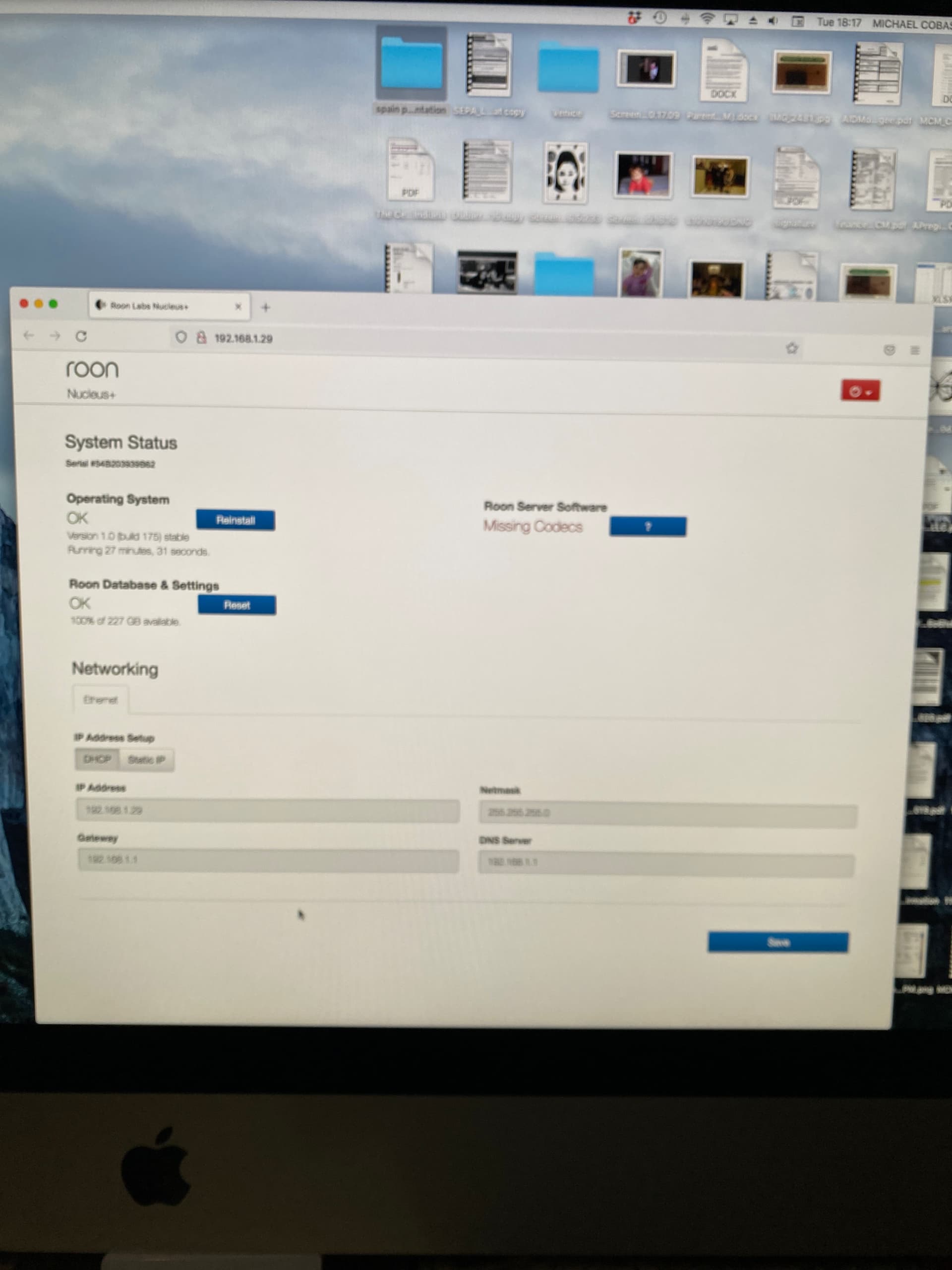

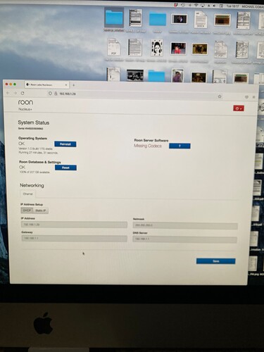

Can you type 192.168.1.29 in a web browser to get to the Web interface of the Core you showed above?
Then I click on ip link and get to following window.
Yes, and click “Reinstall” on the Roon OS section. That needs to be updated to 1.0 Build 227 as a first step.
